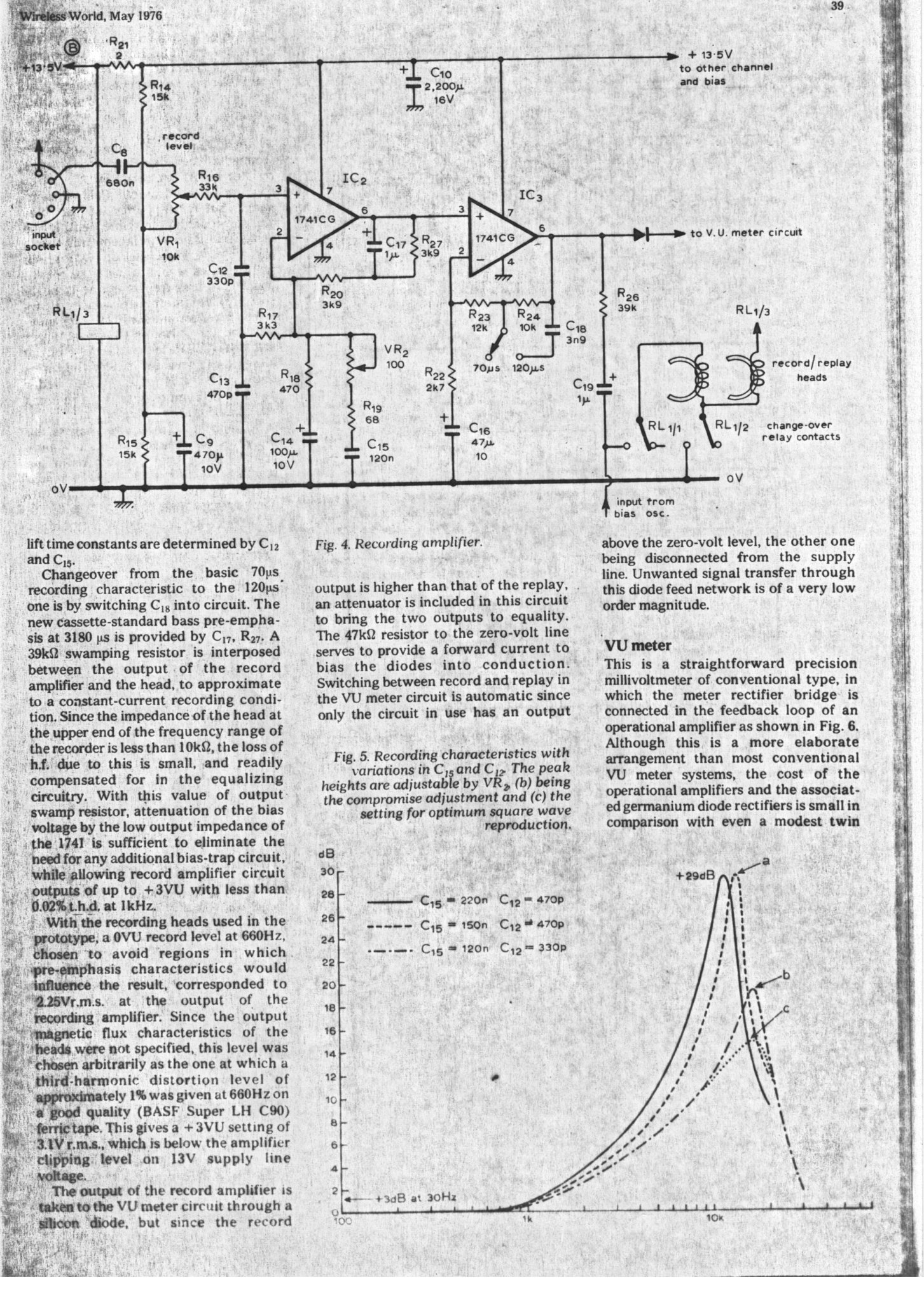

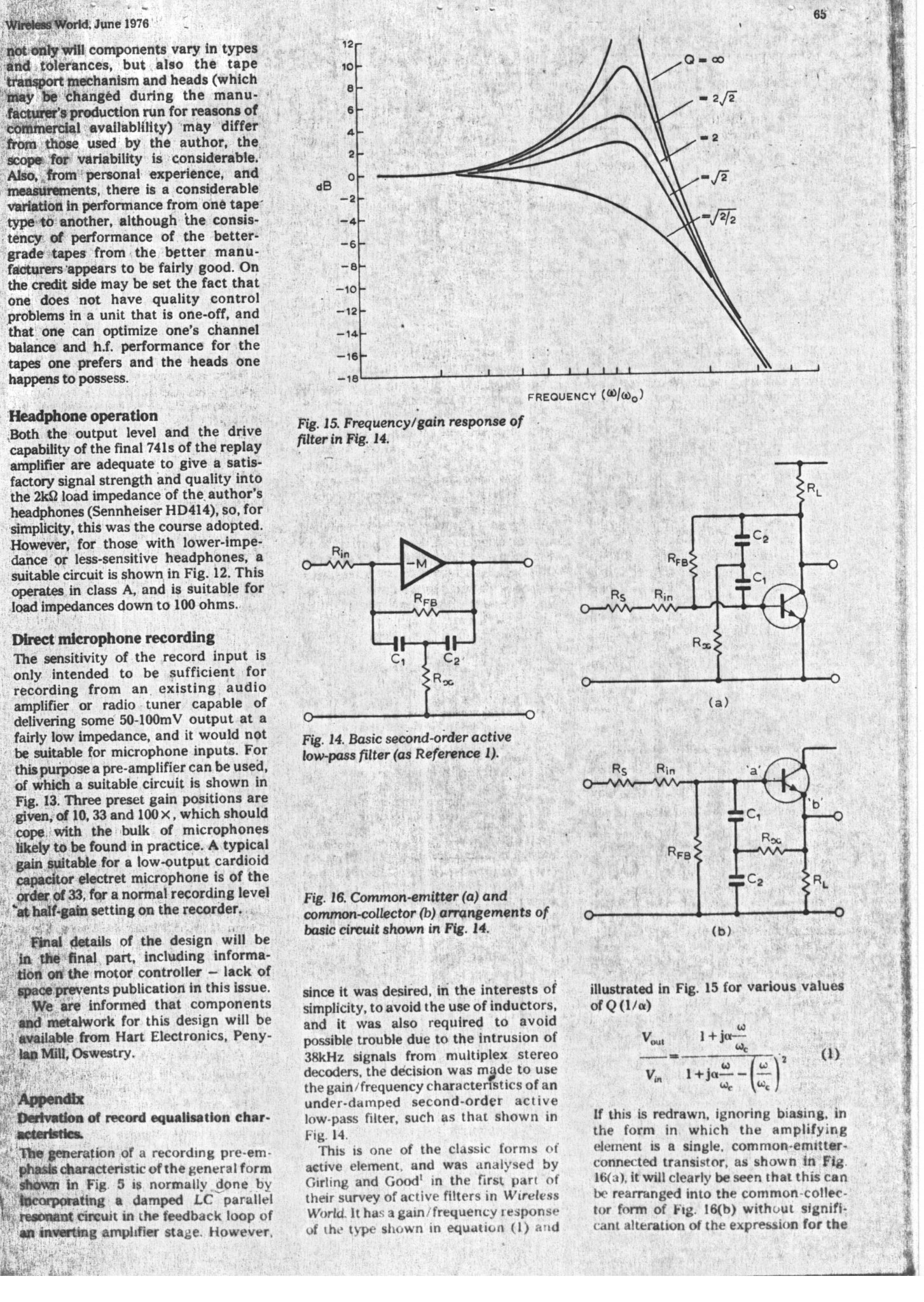

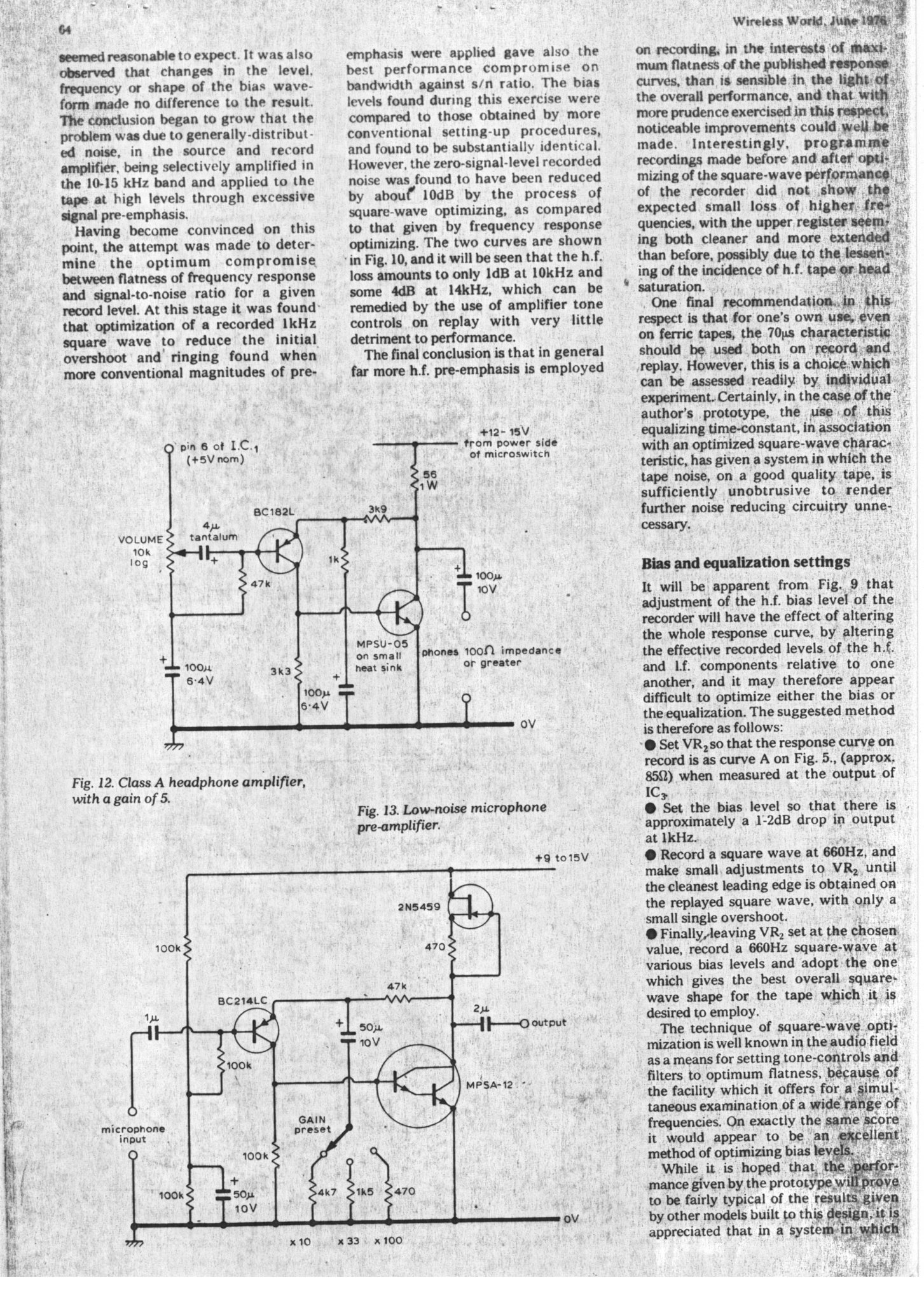

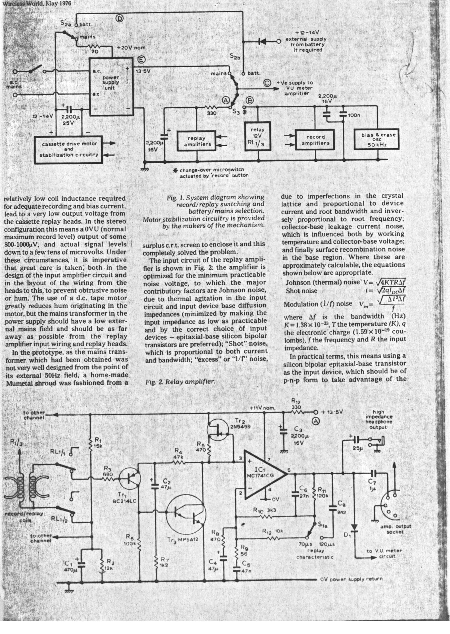

I have the full article for the front loader too. If anyone's interested I'll scan it and post it.
Here you go....
I'm happy to post you the paper copies if you pm me your address, and if you (or anyone else for that matter) would like the series 2 cassette deck, you're welcome to collect it from London or I can send it for postage cost. I haven't had it working, and I don't need another project at the moment, but it would be great to have it used and preserved.
