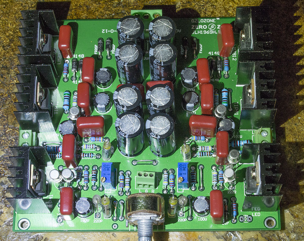

Hi folks
I bought one of those 'JLH 1969 Headphone Amp' PCBs from ebay, which isn't actually a design by JLH himself, it just uses the 1969 design as a basis.
I went to the trouble of sourcing all original components, NOS transistors, Wima and Rubycon caps, Neohm, Welyn and Vishay resistors, no cheap Chinese parts at all (other than the heatsinks).
For a chassis I took an old Show PA-18 mono PA amp and stripped it down, then bolted a 3mm piece of aluminium on the front.

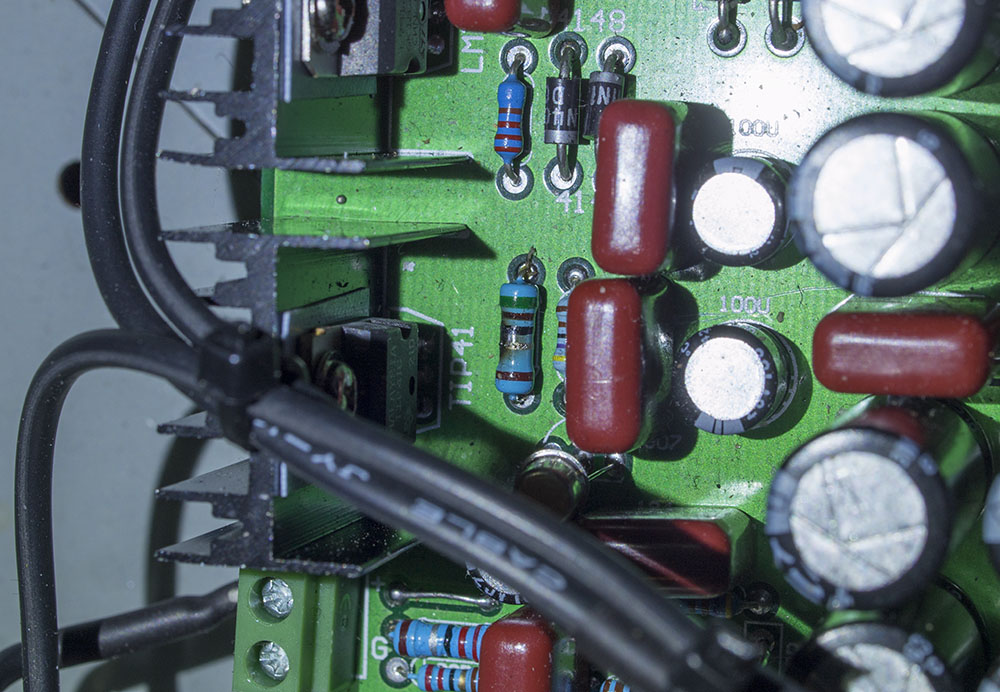

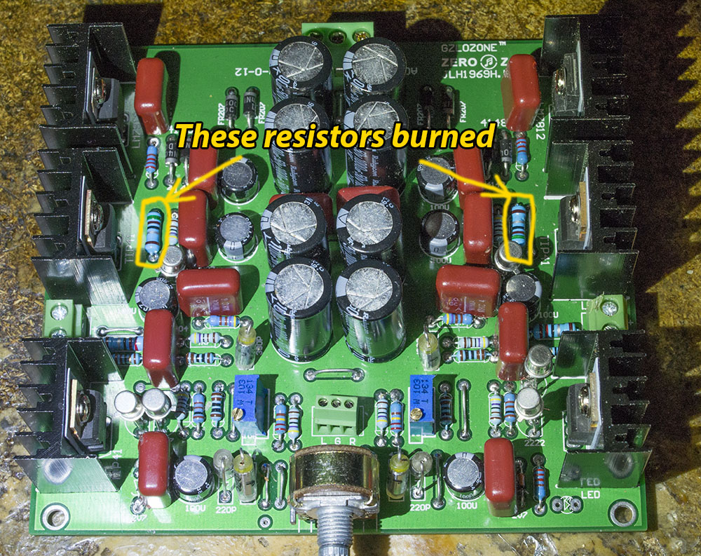

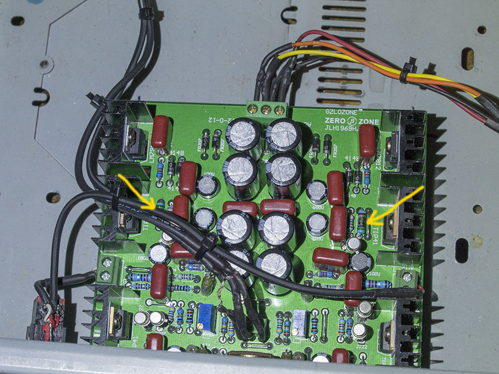

Last night I came to fire it up for the first time and when I hit the power switch, the blue led came on, but immediately, smoke was emitted, so I turned it off.
On inspection, two resistors have burned out, it was only powered up for a second or so, so hopefully not much else ha been damaged.
Anyone got any idea where to start diagnosing and repairing this thing? This is my very first ever amp build to reach completion, so I'm a bit clueless where to start.

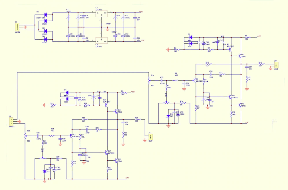

Post your schematic and parts list.
Hi Rayma
I don't have a schematic, I'll have to look for one on the interwebs.
Parts, I just used what was printed on the PCB. The main output transistors are original TI made TIP41C, the other transistors are original TO-18 2N2222A and 2N2907A, the latyter were made by Raytheon, I forget who made the others. Caps are Wima MKC4 0.1uF (the deep red boxes), the electrolytics are Rubycons, 1000uF 50v and 100uF 25v with a few RIFA polystyrene caps in the picofarads range. Resistors are all the correct values as printed on the board, a mix of 0.6w Neohm and Welyn and Vishay 0.25W, with some 1W ones; all are metal film types. I think the ones that have burned are 1W types as they are larger.
Here is supposedly the schematic, I found it here:
NEW JLH HOOD1969 Class A Headphone power amplifier DIY Kit Preamplifier kit-in Headphone Amplifier from Consumer Electronics on Aliexpress.com | Alibaba Group
Sadly it's not very clear, I'll try to find a better version.

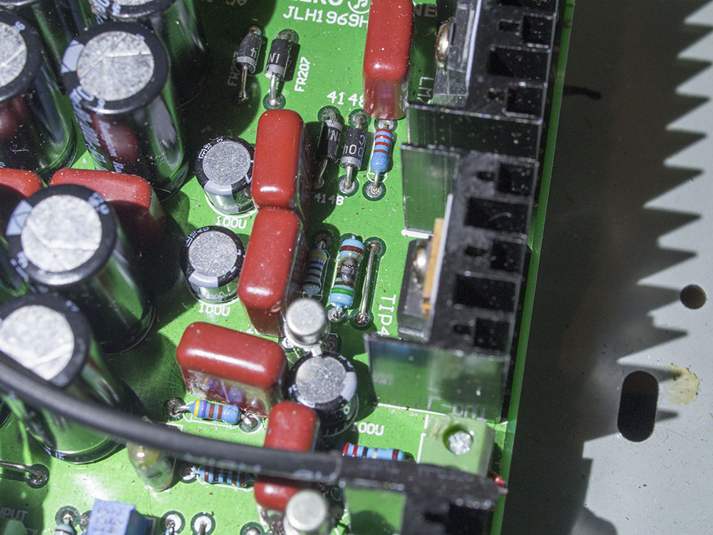

Looks like 5.1 ohm and based on the schematic R4 and R5 connected directly to the + rail

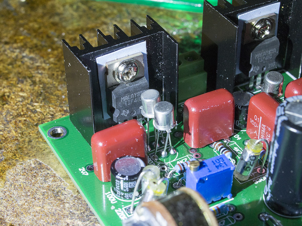

Also, are the heatsinks connected to ground ? If so, are the TIP42 isolated from the small heatsink? I see a thermal pad but the screw going through must not touch the heatsink. The sell kit for mounting TO-220 transistors. Simply check w an ohmmeter to see if any pins of the TIP42 has continuity w the heatsink.
For R4, R5 to blow you probably have a short-circuit somewhere.
You could temporarily replace these 2 resistors by some fuses.
This circuit is known to have a big dc offset drift so a servo circuit is almost mandatory. This can be added later once the unit is working.
Oh balls, I forgot to fit plastic washers so yes, there is a connection between those trannies and the heatsinks. I bet that's the problem....
I'll replace the nuts and bolts with nylon ones and cross my fingers that I haven't friend the trannies.
Many thanks for being so eagle-eyed and spotting that!
I've replaced the metal bolts with nylon ones, I'll replace the resistors next, luckily I have some spare 5r1.
Fingers crossed!
Fingers crossed!
Use a meter to verify no contact. Unfortunately the nylon hardware
will deform because of heat at some point.
How exactly do I verify there is no contact? Put one probe of the meter on the heatsink and the other on the metal tab of the tranny?
Shame about the nylon issue, but as long as it gets it working. I'll have built other headamps before too long so if this one ends up dying, no great loss, it is all about learning at this point.
Exactly, make sure you scratch the paint a little
