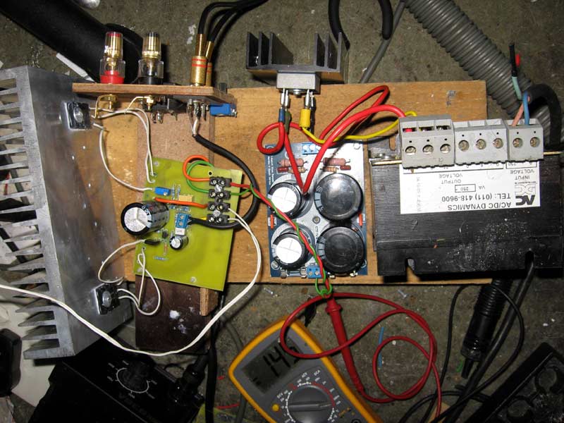

Hehe just powered up the JLH now... got it biased at 1.3A (well it crawled from 1.3 to 1.39A in about 10 minutes) with 35V supply
Gets realy hot, but it is just a test sink, half the size of the full ones I will use... can put my finger on the outputs for about 10 seconds...
Wife is sleeping allready, so it will have to wait untill tommorrow for testing... I suspect it may hum a little as I went totaly minimalist on it so that I can easily zoom in on areas that makes for best tweaking.

Well who would have guessed. Works perfect right from the start...
I used 2n5401 on the input , bd139 in the "driver" and 2sc5200 on the outputs...
I suspect clever layout played a part, but I have no hum.
PSU is simply half of one of my universal PSU boards (not even with inductor installed).. with 2 10000uf in parallel, and another 1000uf axial cap from V+ to GND...
Lol getting goosepimples from the sound now... and that's just one channel... PCB drawn by hand with a black marker on the copper.

But I would never believe how hot that sink is getting.... can probably hold on to it for 5 seconds. Which I guess means time to swithch off and get the bigger sinks or get a lower supply.

Nordic said:But I would never believe how hot that sink is getting....
I use one like those per transistor
(+/- 27V @ 1.2A, so each transistor lives at about 32W.
Yours are 35V @ 1.3A = 45W
I think my last calculation showed about 50W for the two outputs together, which seems to match the rough 1C/W I calculated the sinks as being.
The voltage was a bit low last night as I was only useing one secondary of the transformer... which is tapped for 0-24-0-24-0-6 VAC. As you can see I was pulling 1.45A at the time of the picture (that is from PSU, you can take off 10mA for the front of the amp to calculate bias setting.
The full size heatsinl is identical, but twice the height (20cm) so I guess in the region of .6C/W.
