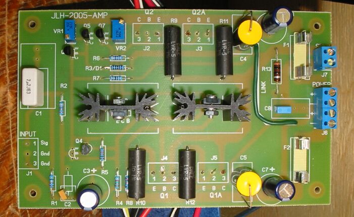

I've just finished a prototype of a JLH using Geoff's PCB layouts (thanks, Geoff!). This is a temporary setup while I decide on final packaging.
Here's a populated board. Notice it's single-sided, and only one wire link is needed. This is an easy board to stuff, I'd recommend this project to beginners except for the heatsinking and power supply requirements make it a fairly involved project.

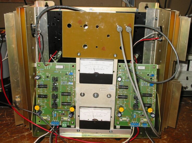

Here's my test arrangement. There are 8 output transistors spread over 5 heatsinks, and it's still not enough without some fan cooling. I'm running just under 2 amps bias current at +/- 18.5VDC.

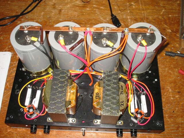

The power supply is almost 100% recycled parts. The transformers came from a pair of Advent Powered Loudspeakers (that are currently UnPowered); To get the proper voltage, I wired their primaries in series and their secondaries in parallel via the 10W current sharing resistors. I was originally going to add a capacitance multiplier but with the big capacitors I have Geoff suggested it was good enough without. Also, I didn't want to suffer the voltage drop and lower the rail voltages any further.
If I use this for the final arrangement, and it goes somewhere other than my lab, I'll have to hide it away (I've been told).
I think I might just keep it in the lab, though...

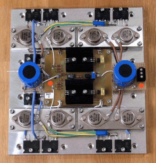

> Have you build this amplifier since?
Yes, using 8x MJ21194 per channel. +/- 15V, Total bias 5.6A. Gives you roughly 40W at 4 Ohm & 8 Ohm. Peaks at 6 Ohm.
Photo too large to post here. No housing yet. Just on heatsinks.
Try it for yourself. It won't take too much effort. Use a lab supply to see if you like it first before the big investment.
Thank you for your interest,
Patrick
Just managed to get it down to below 100kB.
Picture quality is horrible, but not much I can do.
This is one channel which is bolted onto a heatsink of 0.2K/W.
Circuit as posted except for the output transistors, as already mentioned.
Everything matched.
Patrick
Patrick
Everything matched.
Patrick

Re: Re: Geoff's JLH PCBs
bremen nacht said:
Hi Paul,
do both driver transistors get warm? those are 10degC/W heatsinks right?
What part numbers are they?
thanks
Chris
I got the heatsinks surplus from a place in Silicon Valley, don't know the part#. Digi-Key sells something that will work. They are oversized, something smaller would work.
