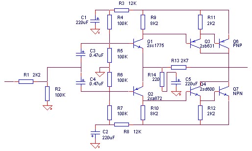

Dear all ....
Sorry if I'm wrong ... but if I mirroring the JLH schematic, I get the Hiraga amp ..... 😕
regards:

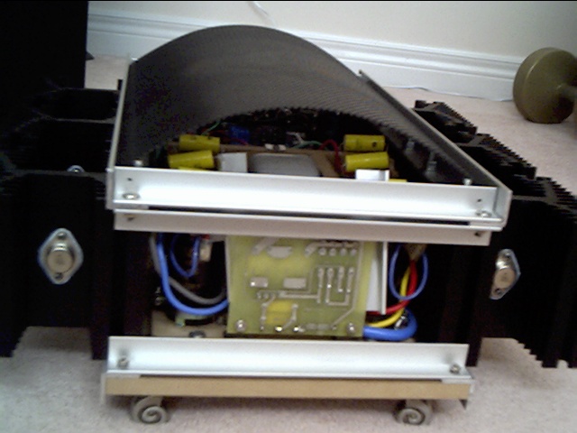

I use 4 MJ15003 in the amp and 2 LM338K in the PSU. The voltage drop across R9 is 194mV so I say it is close to 4 amps, and the amp is so stable I get 00.5 displayed on my multi-meter set at 200mV on the dial when test for the DC offset. The switch on DC offset is around 480mV and start trimming right away. It does take an hour to get down to 0.5mV though. It did not sound as good when bias setting is lower.
what's transformer size you guys recommend for 4amps at 20 volts. is 250va 18 volt good enough.
is there much difference in sound when comparing regulated supply with 30000uf and the regulator with pi-filter(
22000uf - 15mh-144000uf)
when running at 4 amps won't the sinks be hot. The ratings for your sink is 0.5 rite. I used the same amount, 4 transistor on 4 sinks each 0.5 rating the temperature reaches 57 celcius at 22 volts at 2.2 amps. i was wondering to upgrade it to 4 amp soon so just wondering on the need for more sinks.
The transformer I am using is Piltron 300VA 18-0-18, it gets rather hot after an hour or so the metal mounting disc of the transformer is too hot even to touch, the heat sinks are fine though, I can touch them for a long while without feeling uncomfortable. But I have no means to measure the temperature of the heatsink, actually my wife suggested that I should try to see whether it can make toast for her by place a slice of bread on top of each heatsink.

from your description the tranies at above 65. How fast does your hand respond by pulling away. Normally i guess the transformer can be run at almost maximum capacity with no much problem just less life for the tranies
but sinks are 50 to 57 should be okay

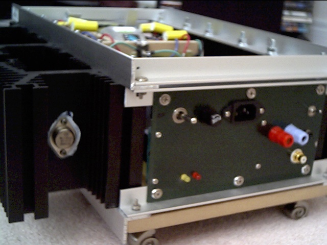

I've build the JLH 10W (1969) version as described in the 1996 article. (4 channels, 4 transformers, 4 bridges etc, 1 casing).
(figure 1 in http://www.gmweb.btinternet.co.uk/jlh1996.htm)
So far progress is slow but steady. (Thanks again to Geoff for the earthing problem.)
But I've encounterd the following problem and I was hoping for some help.
Last night when I finally was able to bi-amp the loudspeakers, everything seemed to be allright. Bi-amping sounds even better than normal amping.
But............, the sound from the right channel has a strange scratching, resonating component.
The only strange thing that I can find, is that the output (minus) side of the output cap has about 14V, seems to me that this shouldn't be so. (I expected 0V) I don’t know what causes this.
I have neglected to put a 1K resistor, after the ouput cap and earth, but can this be the problem or is it something else?

If you have 14 volts at the minus side of the output capacitor with the speaker conected...you a have a short in the capacitor and maybe a burned speaker!!!... :xeye:
If the 14 volts reading is without the speaker conected is because, as you dont have put the 1k resistor the capacitor d'ont have a path to ground for charging...in this case everithing is fine... 🙂
Put the 1k resistor and measure again...

I did have 14V at the speakers, but nothing happened. 😀
Goes to show how good Dynaudio really is, it's a pity that the don't sell their components anymore.
I did put in the 1K resistor and indeed everything is ok now.
