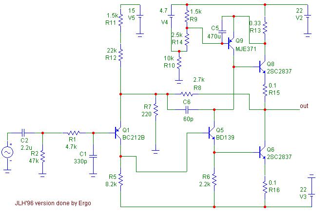

As for fet for input, I have some simulations done on the subject but I never got around to trying the ideas....
I'll try to put the schematics with the fet ideas up here later today.

Here you can see the JLH modules with above mods done to them..

Hi ergo,
I like that 60pF cap there, I used a cap there at the same place to improve the transient square wave respone in my MOSFET version,..

Hello,
A few month ago, I've built a JLH Class A 96 Update (The final circuit), which sounds better than my Sony ES amplifier.
There are two monoblocks, with 14-0-14 V DC filtered with 15mF-0.1ohm-15mf-22mf-9.4mf. on each rail.
(The last 9.4 mf are made from 20*470uF - and made a big improvents on midles and hights)
The first version was built with BC560, BD 140, KD 503, and Iq was 1 amp
I have replaced them with 2SA970, 2SC3421 and MJ15003 with Iq 2.5 amp,
and the result was a big increase in definition, and 'presence'
In this moment, nfb is reduced : R8 is 3.5 k and R6 is 180.
The benefit of low nfb is on the "speed" of the hights and middles, but
bass became less controlled.
I have measured a Damping factor around 16 on 4 ohm.
( 16 at 50 Hz, 17 at 1khz, and 15 at 10khz)
I didn't measure the linearity yet, and I don't know what happent with thd, but I like the sound
with nfb reduced.
I want to know if anybody tried to reduce nfb and what were the results:
1. how much can I decrease the nfb ?
2. If I will increase Iq , the response will be more linear ?
3. How can I put local feedback, in order to remove global feedback ?

My first guess would be to install emittor resistors at the output transistors, sometrhing like 0.5 Ohm? You could also increase the feedback resistor to decrease openloop gain.. from 220 (you use 180?) to 1K .. the other feedback resistor also need to increase offcourse to keep closedloop gain the same... a 33K resistor from the collector of the driver transistor to it's base reduces openloop gain drasticly and increases local feedback..
run some spice sims to see what happens..

has anyone experiences driving JLH with low impedance speakers.
My JLH drives Quad ESL-57s whose impedance (IIRC) drops below 2 ohms at higher frequencies. Iq is 1.5A @ 17.5V.
Tim.
Tim,
Are you using the circuit of figure 3 on http://www.tcaas.btinternet.co.uk/jlhupdate.htm then? If so, did you return to using C4 (the 470uF feedback cap)?
Erik
Erik
