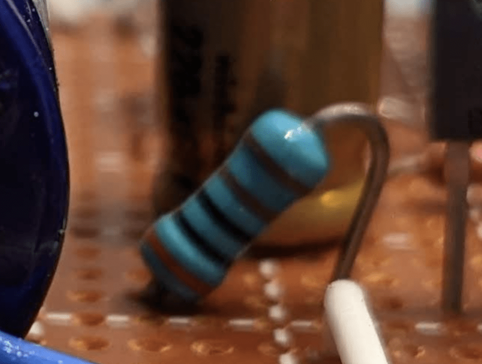

@Mooly - I think you are right, there seems to be a short on Tr1
My transistors weren't insulated to the heatsink in my first tests and may have shorted? hmm.. I've never used these kind of metal cased transistors on a heatsink before, they are now all with a ceramic screw+washer insulators.
The resistor I have across TR1 B/E looks like the picture below - I am not 100% sure but with the help of a colour calculator it should be a 2k, hopefully i am seeing the colours correctly.
Also @OldDIY I agree.. I may need to do a bit of a fresh check across the whole board once I replace the parts that may be causing the issues..
I am thinking to get new TR1/TR2 transistors and 2k2 next week.
A friend that I had guided by telephone years ago to assemble a JLH had made the exact same mistake, I had not thought for a minute that he could assemble them without insulators 🤪

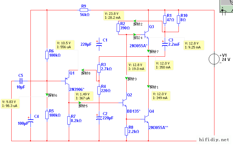

Just to expand on this the bootstrap involving C1 increases the a.c. impedance of the load seen at the collector of the BD139 transistor which means that will have to pass more collector current to generate a greater voltage drop across the impedance of the load.
It is necessary to get the right level of operating current for the BD139 by studying a graph where collector current is plotted on the vertical axis and collector to emitter voltages are plotted on the horizontal. A line representing the load is drawn between selected levels between two points between each axis.
The characteristics of transistors have a curved characteristic if the levels are not correct then the Q point which crossed the graph for the particular transistor is too high the result will be a clipped signal.
The approach to resolving this question is to download the datasheet for BC639 and look at the graph for static characteristics. These are low power versions of BD139 with max IC current of 100 m.a. with less heat dissipation characteristics. The values of the resistors in between the collector of BD139 and the supply rail are the dc load which will be boosted by the bootstrap capacitor C1.
The reason for this is the circuit has two common emitter amplifier stages each of which invert the phase of the output for each. Two negative phases result in a positive phase input from the output connection to the loudspeaker via C1 when applied to collector of BD139. Bootstrapping involves the use of positive feedback to increase the ac impedance of the BD139 collector load.

In this case, the input first transistor (IS) amplifies at the level of 6.3dB, and the second transistor (VAS) amplifies 42dB (open loop).
If we remove the capacitor, then the first transistor adds +1dB,, but the gain of the second transistor drops to 36dB.
It is easy to calculate the resulting feedback depth necessary to reduce distortion and increase the linearity of the gain stages.
