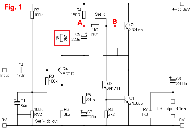

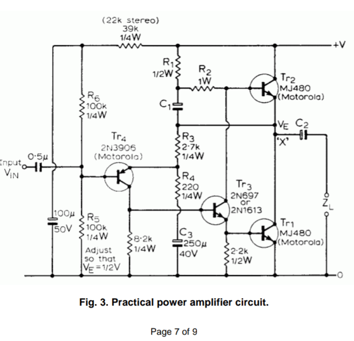

Fig1.
I found out that I can move the feedback point to point A or point B and the amp still works fine.
I tested it on my amp circuit, but I didn't hear any difference from the original circuit.
Can someone help me analyze if such modification makes sense? I just know it increases the input impedance.

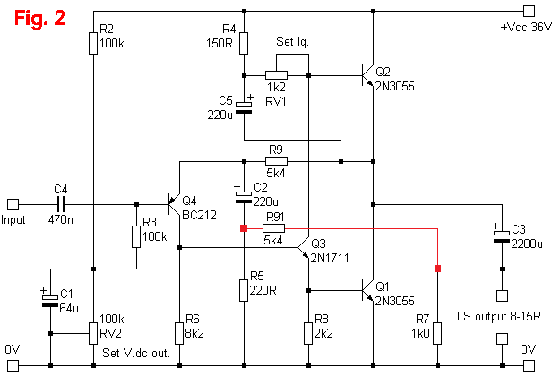

Fig2.
As far as I know the duo-beta feedback network is from Luxman,
I haven't actually tested this circuit, but the simulation shows it has better low frequency response.
The idea came from the ESP website: https://sound-au.com/project217.htm
Can someone test it on your circuit and share how it sounds?
Reactions: 1 user

You could remove C5. It WILL sound much cleaner.
Connect emitter to base of Q2 ("quasi" Darlington). It will sound more fat, round, colored, powerful, but less detailed.
Feedback Fig. 2 WILL sound less detailed, disorganized.
yes, it will work, just add to your story that for the amplifier to work with this inclusion, you need to bring the RV1 trimmer almost to 0, so that half of the supply voltage is obtained at the Q2 emitter.
The current of the output transistors will then increase to 4 amperes. You can reduce the current by increasing the resistance R4, but what do we get in the end?
the circuit becomes single-ended for the main input transistor Q1, and Q2 becomes the load element for Q1.
this is very strange, because in the case of such a modification, the level of distortion increases by a factor of 10, but the spectrum itself becomes very short with the dominance of the second harmonic.
my opinion - doesn't make sense, Nelson Pass version of single ended circuits would sound much better.
about the best low-frequency response, I would argue, because. in this embodiment, in addition to an even greater decrease in the input current for Q4, the ratio R6 / R9 decreases, and to a large extent weakens the effect of the general feedback. That is, with the added resistor R91, the depth of the total NFB will be only 5 dB.
how all this sounds can be indirectly determined by the transient response, which in none of the presented options speaks of a qualitative improvement in characteristics that can be transcribed to the finished product. firstly - a completely open input for the entire frequency spectrum, which will overload the input transistor for any reason, and secondly, the speed in the feedback loop is not very high, it does not keep up with the signal ...
Can this be fixed? - of course, this is done very simply, an integration circuit at the input, an accelerating circuit from the output - and that's it .... the standard vintage circuit of John Linsey Good will again have a high-quality transient response and, as a result, good sound ....

Why?
Your fig 1 alters the DC currents significantly and will need some considerable adjustment to maintain a DC level.
Point A may not make much difference as C5 couples the output through to the feedback.
Point B is somewhat senseless because you are no longer correcting the output signal, and will be attempting to control the base of Q2 which means that its emitter voltage is outside the feedback loop. JLH's circuit relies on Q2 and Q1 operating in push-pull to cancel some of the distortions.
As regards the split feedback approach, the higher resistance of R9 also needs some considerable adjustment to the bias to maintain the output at mid-rail.
There is a downside to taking the feedback from the output side of the output capacitor. Yes, it will extend the low frequency bandwidth but at the cost of lmiiting the available output power at those lower freuqencies. THe feedback tries to compensate for RC droop, so the voltage across the capacitor will change, and that will limit the output power. So your apparent improvement in frequency response comes at a cost of lower possible output power.
However, the RC droop will occur anyway, but the feedback will exacerbate it.
A better solution is to use a bigger capacitor.
I suspect that modern computer grade low ESL/ESR types will not contribute significant distortion which would warrant taking feedback from the output side.

I would remove (R1), R2, R3, R5, R6, R7, R9, RV2, C1, C2, C5, Q4.
I would set RV1: output - base Q3 - (ground): does not set "Iq."!
I would use three times the same transistors: TO-220 types or Fullpak or TO-126.
Never bridge big caps with little ones.
I would reduce Vcc: 15 V or so.
And: NEVER use pcbs or veroboards.
Do use fullrange speakers;-) Without any crossover! Without any electrical frequency correction!

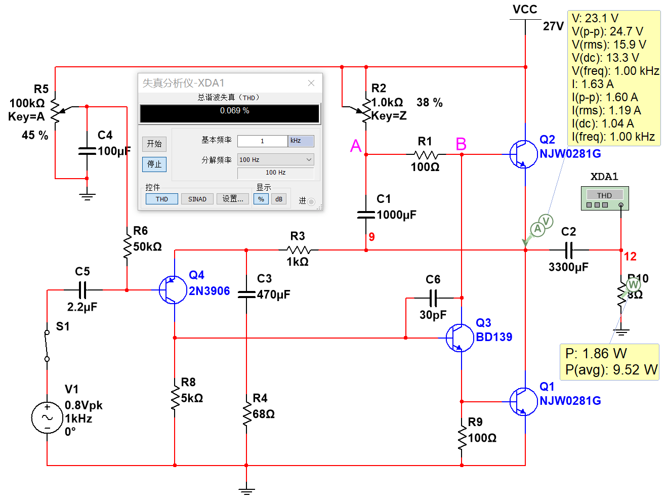

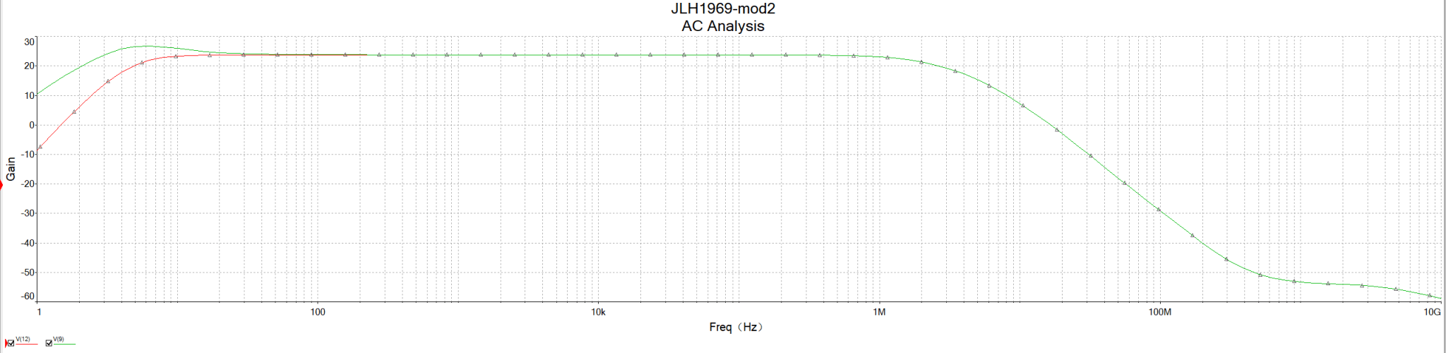

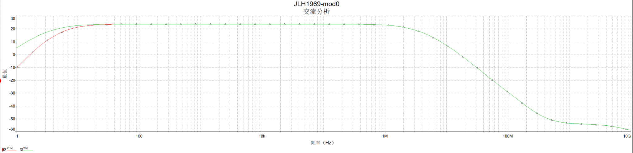

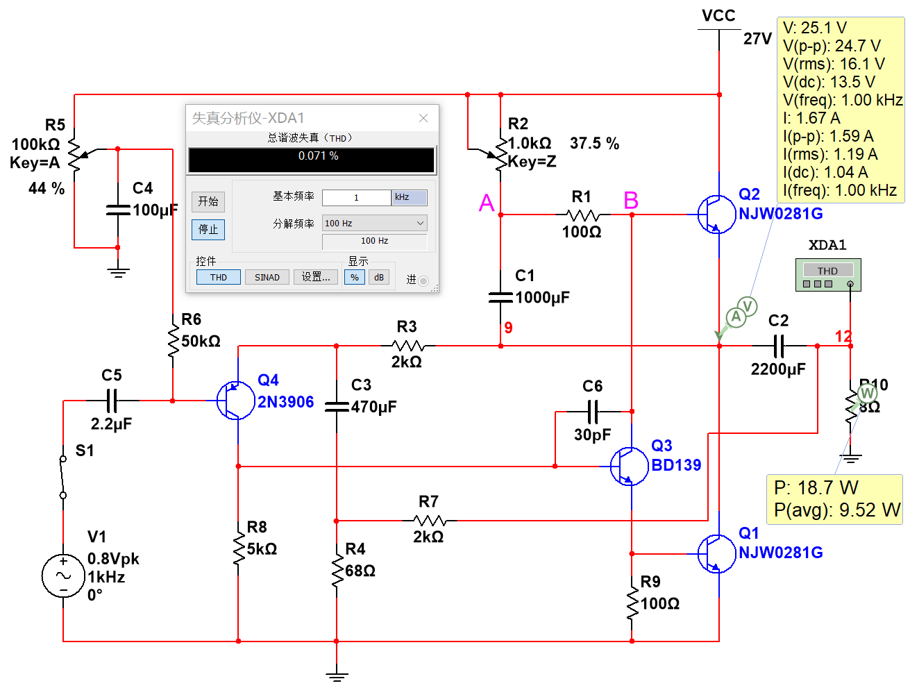

I think it's worth posting my simulated circuit showing that these modifications work.
The Multisim simulation files are placed in the attachment.
In mod0, I changed the parameters of JLH1969.
In mod1, I changed the feedback point to point A.
In mod2, I added multiple feedback.
  • JLH1969-mod2.zip
