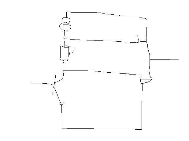

Could you draw what you mean?😉What if we use a fully coomplementry stage to turn this all into common emitter stage?
millwood said:another possible modification is to turn the output into a fully complementry BJT or MOSFET stage.
I haven't been able to get it to work. But here it goes.
Conceptually, I wanted to take advantage of the phase splitter: using the voltage drop off C and E of it to drive a pair of mosfets.
But my trouble is that I couldn't get anough voltage for the negative half of the signal, 🙁. Will think about it more over the holidays.
Alternatively, I can also get a small resistor in C of the driver, as JLH did with his class AB amplifier.

In such a complementair buffer output stage.. I think you need to drive the MOSFETs in phase.. not anti-phase?
like this:
attachement
Thijs
