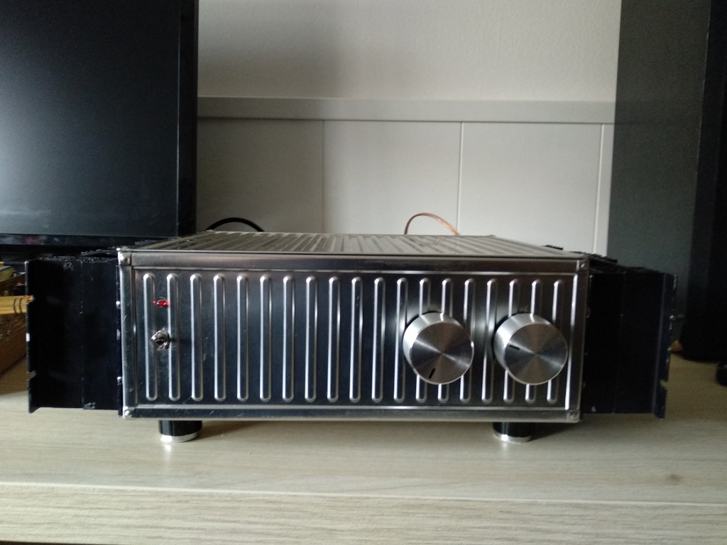

Hi Jemraid
I admire your brave work and I think you should be proud of how you do it. All your works are very well finished and easy to follow.
I am an attentive reader of your blog and I'm waiting to see your new post of JLH1969 you are working.

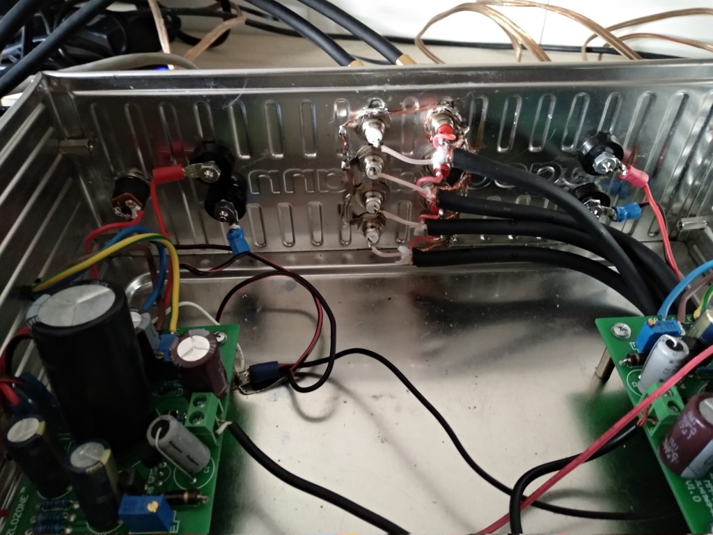

I'm tempted to make an amplifier with the LM3886 for my son but but if I did, I'd have to test it calmly first.

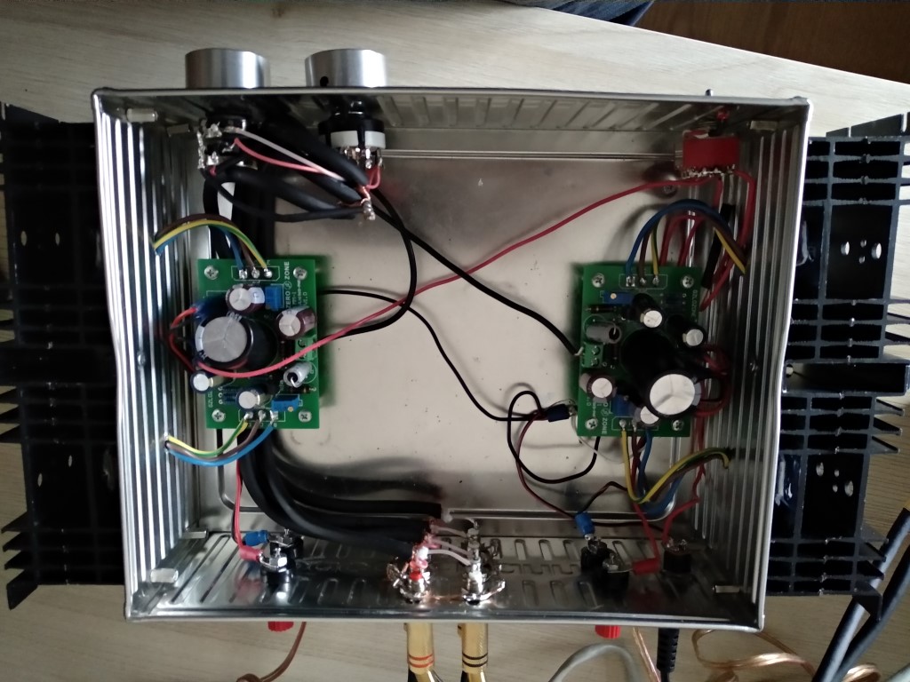

I ordered 2 boards of chinese JLH1969 3 moths ago. They are the same you tried, but due to coronavirus, I think this order is lost.
I bought from another store at the same time two very cheap JLH1969 PNP boards, but with MOSFET P channel, and these came home 2 weeks ago and I just adjusted and finished my first JLH1969 amplifier but with mosfet transistors. I changed all capacitors, putting a 4.7 mF as output, and 470 microF in bias an retrofeed, in the input I put a bipolar capacitor . I have to say it has less power , about 5 watts, and is very slow heating, but after 30 minutes from power on it sounds very well and I'm very happy, because the most important thing is you like what are you doing and enjoy making and hearing good music!
My previous diy amp was 30 years ago, it was a TDA2003 bridged with a bad linear power supply with a lot of ripple, not so good and not very well constructed because I was a teen and have very small bugdet and less knowledge than now.
I think wood is OK, I have made a headphone amplifier JLH based and is over a wood plate too. This is calculated by me with transistors like BD435, bc549 and is working well but not finished.
I think for sure this new amplifier is the best amplifier i made.

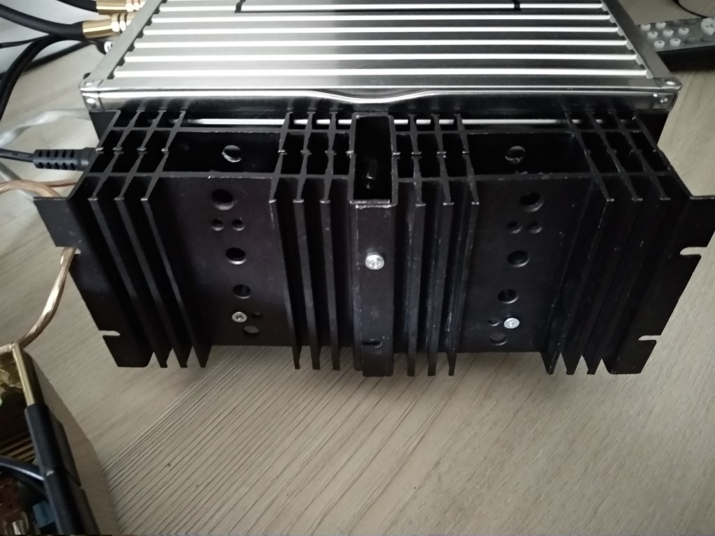

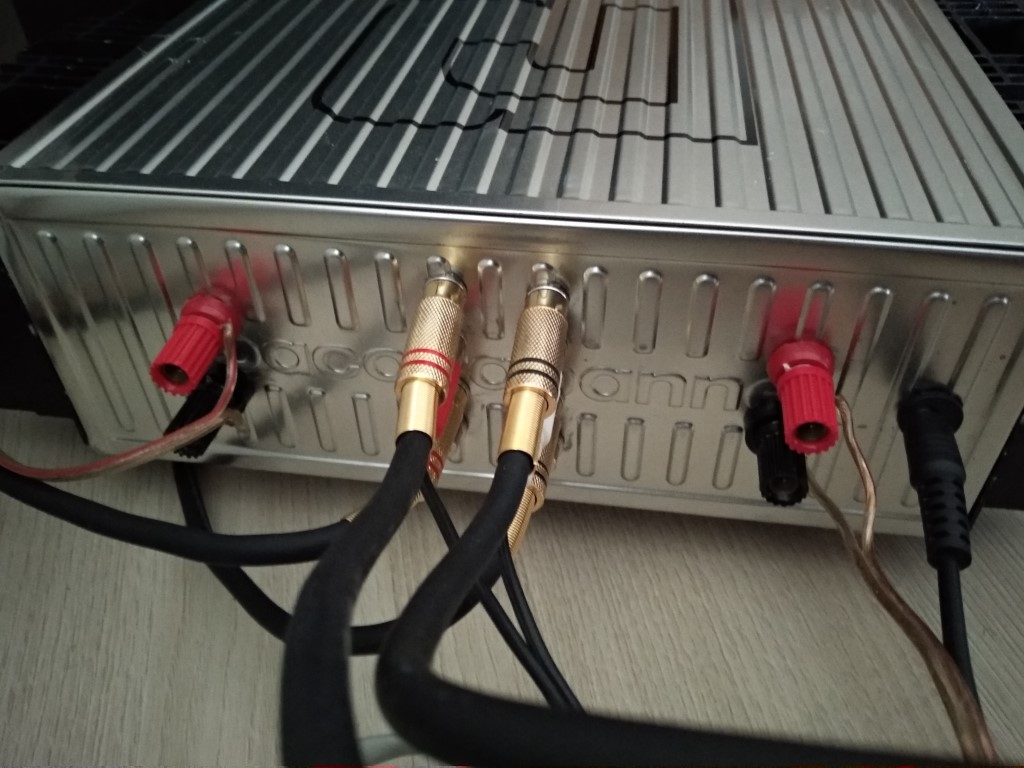

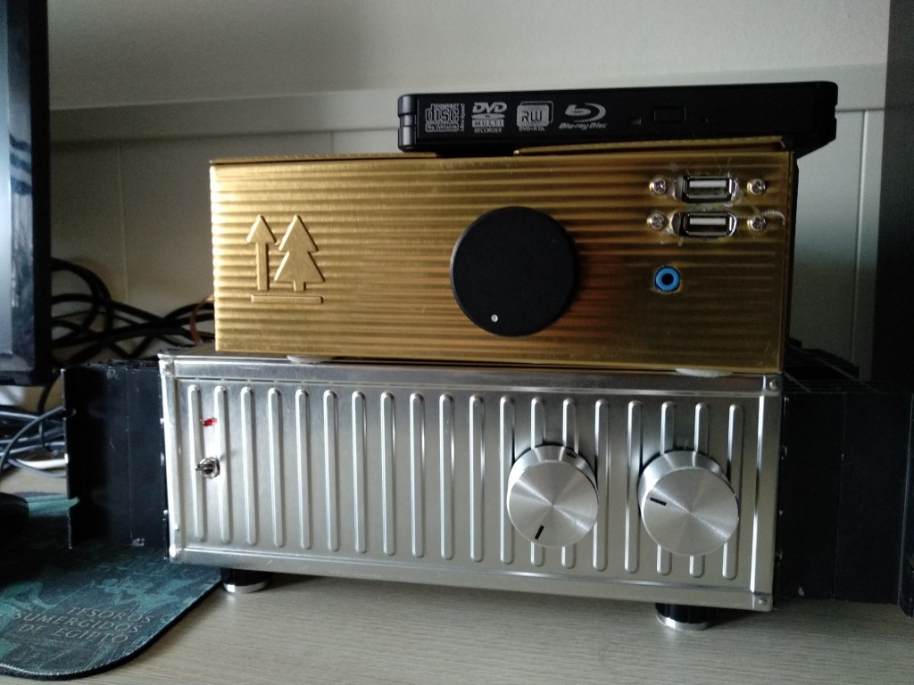

I installed my new amplifier in a "Paco Rabanne gift box", an small metal box with heatsinks as wings, because I have many boxes at home and I think it has a "retro" touch.

Hi OldDIYHi Pedro!
PCB Atom BR ZeroZone JLH1969-PNP?
Sanken pnp BJT replaced by used P-MOSFET J554 without changing the circuit.
Yes this is!
Is very cheap, and I planned to use with old PNP power transitors if Mosfet worked bad, but it is working, I put 2 big old heatsinks for TO-216 power transistors for each Mosfet. and adjusted the voltage adding 47KOhms to trimmer in serial. All Capacitors (470 uF aqnd 4700uF are new from electronics components shop and 50 volts. The input capacitor is an big 10uF electrolityc bipolar ( has no polarity and is like a 2 +- -+ capacitors in series)
I begun testing with a big lab power supply at 24 V and Iq up to 1,2 A. but heat was too hard and the heat and transconductance of Mosfets continues increasing the Intensity up to 5 Amperes and more when I stopped!!!.
In sucesive testing I burnout a transitor because was not well fixed to heatsink.
I saved the board beacuse I buyed a pack of 8 J554 very cheap in other order.
These transistors are heavy and very robust because I was stressing them and only failed one because of bad installation. The transistors used were matched with a small chinese transistor tester. and I Had to test all I have to rematch the transistors of the board.
The kit recomendation is to fix Iq to 750mA., and to use a 1 Kg heatsink.
I adjusted finally the Iq to 1 Ampere and heatsinks are very hot but estable.
I'm feeding amplifier with a 24 Volts and 3Amperes SMPS brick of an old telco system.
My plan is to buy a Mindwell internal SMPS with 24 V and 5 Amperes. for about 20 € or so.

Your amp looks fine, you have found some heat sinks like the ones Mr Hood used, I like the way you've mounted them. I looked up Paco Rabanne goodness that's posh stuff!
