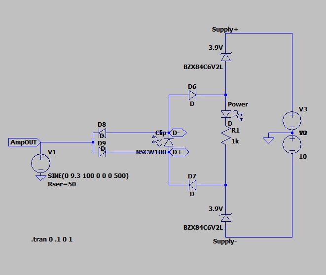

As a side note, I just installed this simple clipping and power indicator on my JLH. Nice to have some kind of clipping indicator on a low power amp like this. Ok, the amp can run out of current before it hits the rail, but it's simple, and better than nothing. I snatched the idea somewhere here on the forum, and just added the power LED since I missed that. Note that the diodes/LED's in the simulation are not the ones I actually used.

Nice and practical circuit you have there, I might just copy it 🙂

Use it! I copied it myself, because I liked the simplicity, just like I like the simplicity of the JLH.

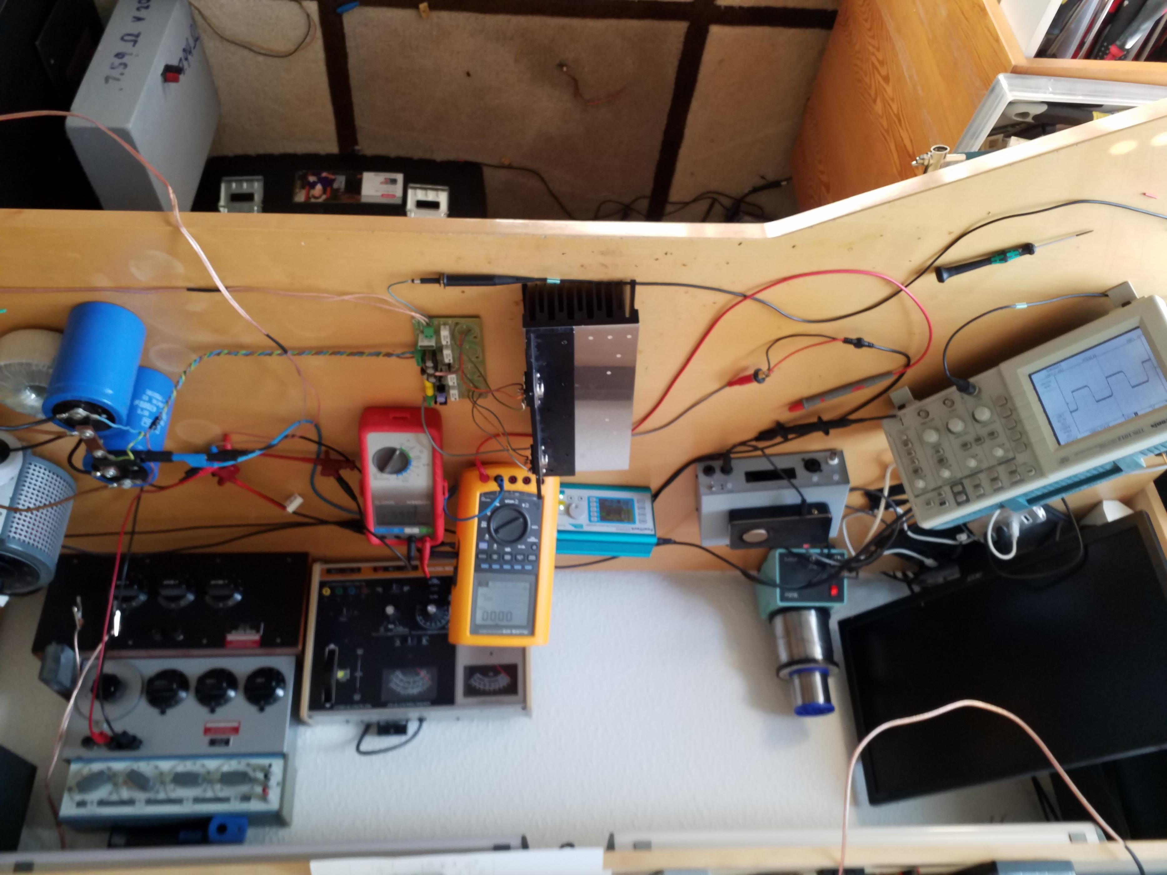

I'm not experienced in making measurements, you talked about different loads, I have it now hooked up to a 4.7 ohm resistor and a capacitor decade, which capacitor values are normally used in testing
I'm not sure what others use, maybe 0,1uF? I have a 0,5uF with leads that I've been using. I just hold it on by hand for a short while watching the scope to see if it goes crazy or not. As I understand it, this is just a stress test to see what happens, some oscillation is ok, but it should be damped. If the amp goes berserk, its not very stable.
Also take a look at square wave with normal 4 & 8ohm. There should not be any oscillation, some say overshoot is acceptable.
Why not test it with single and double outputs too? Iq can't be very high with single outputs of course..
I've been reading in this thread and seen yours and others post their measurements,, the capacitor box can do anything from few pf uptill 2uf.
I noted there that most measurements here a purely resitive.

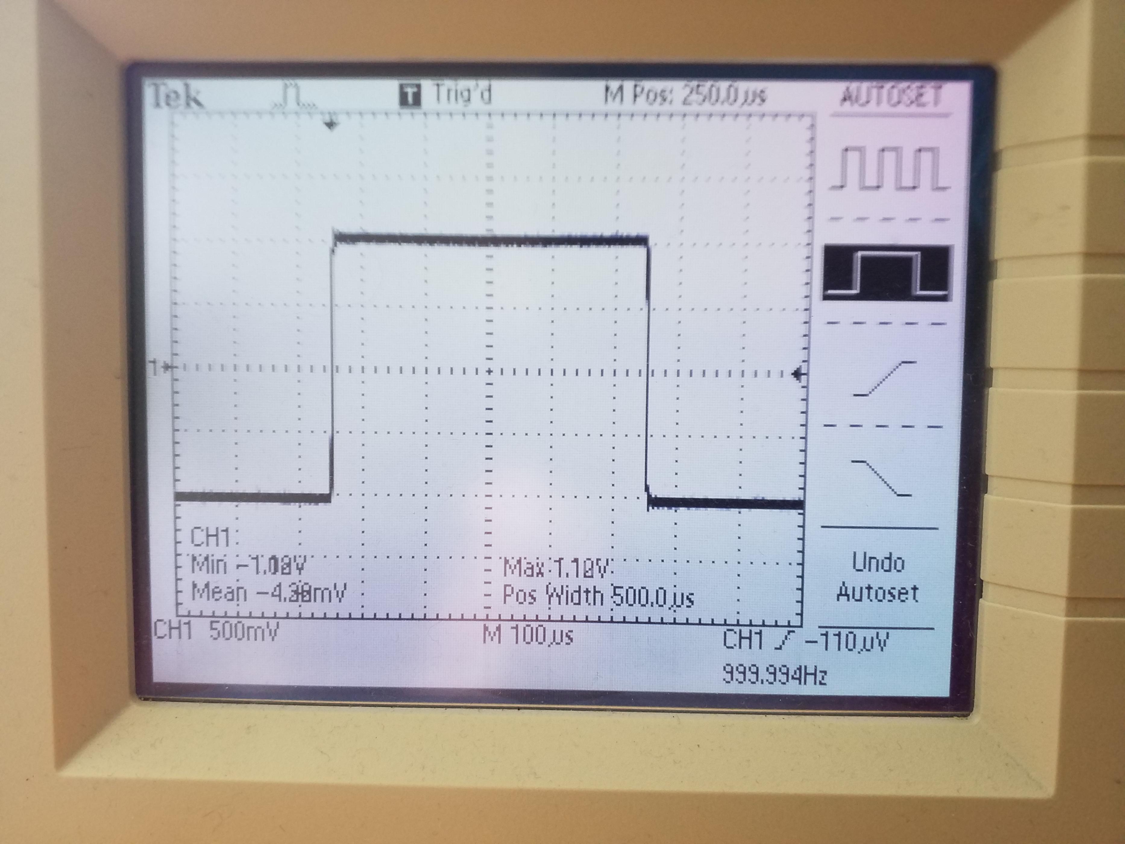

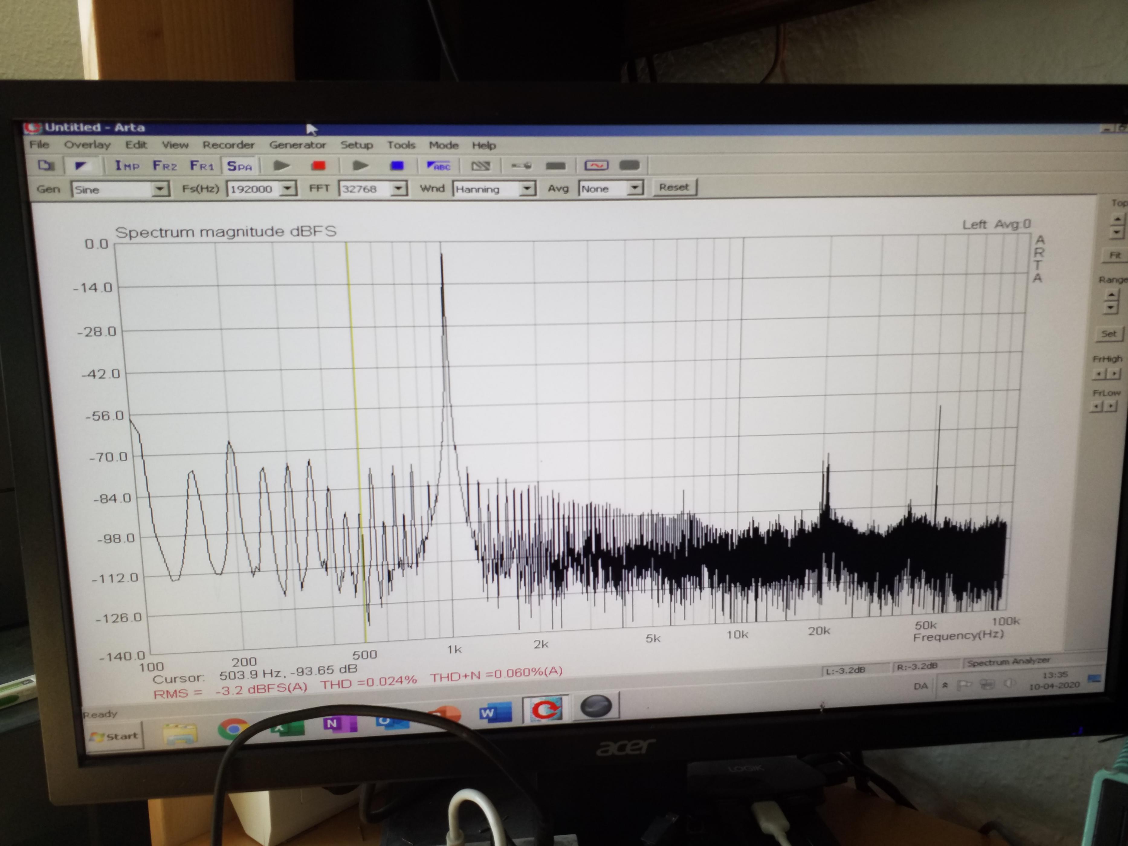

Okay got some readings.
All measurements are taken with 20 volt supply rails and 1a bias, the load is 4.7 ohm.
Voltage across the resistor is kept at 1 volt rms.

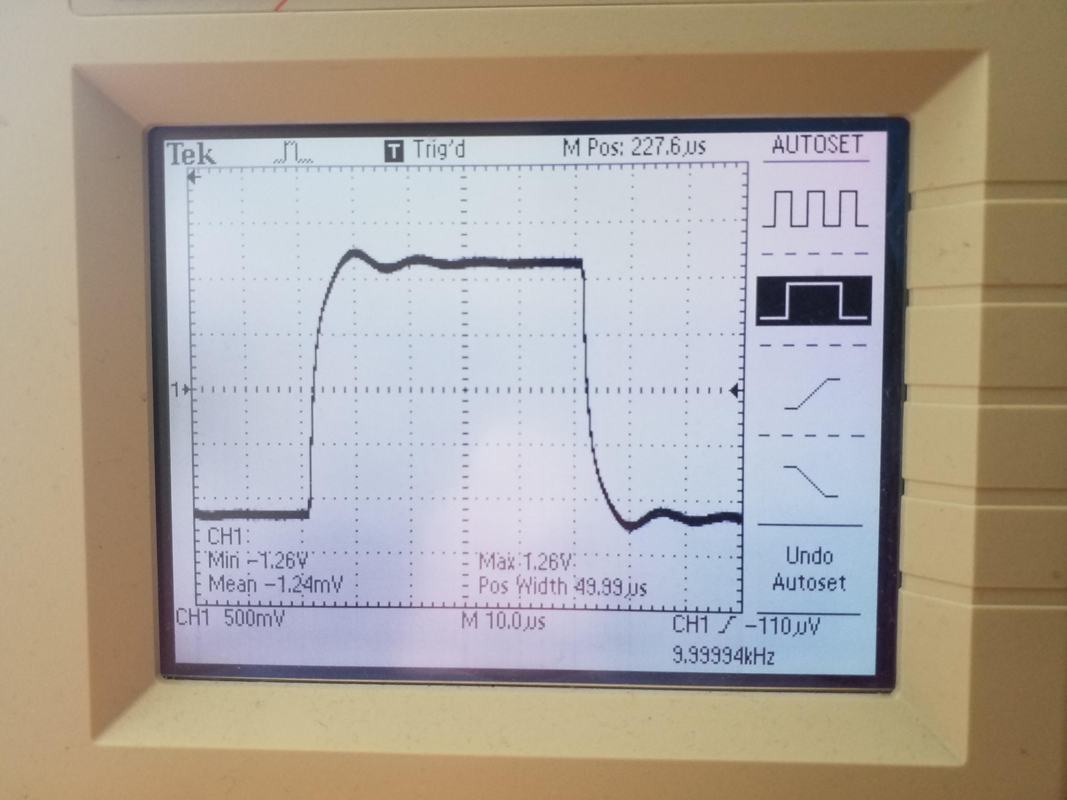

Pic 1.
1 khz 4r7 load
Pic 2.
1 khz 4r7 load and 0.5uf.
Pic 3.
1khz 4r7 load and 1uf.

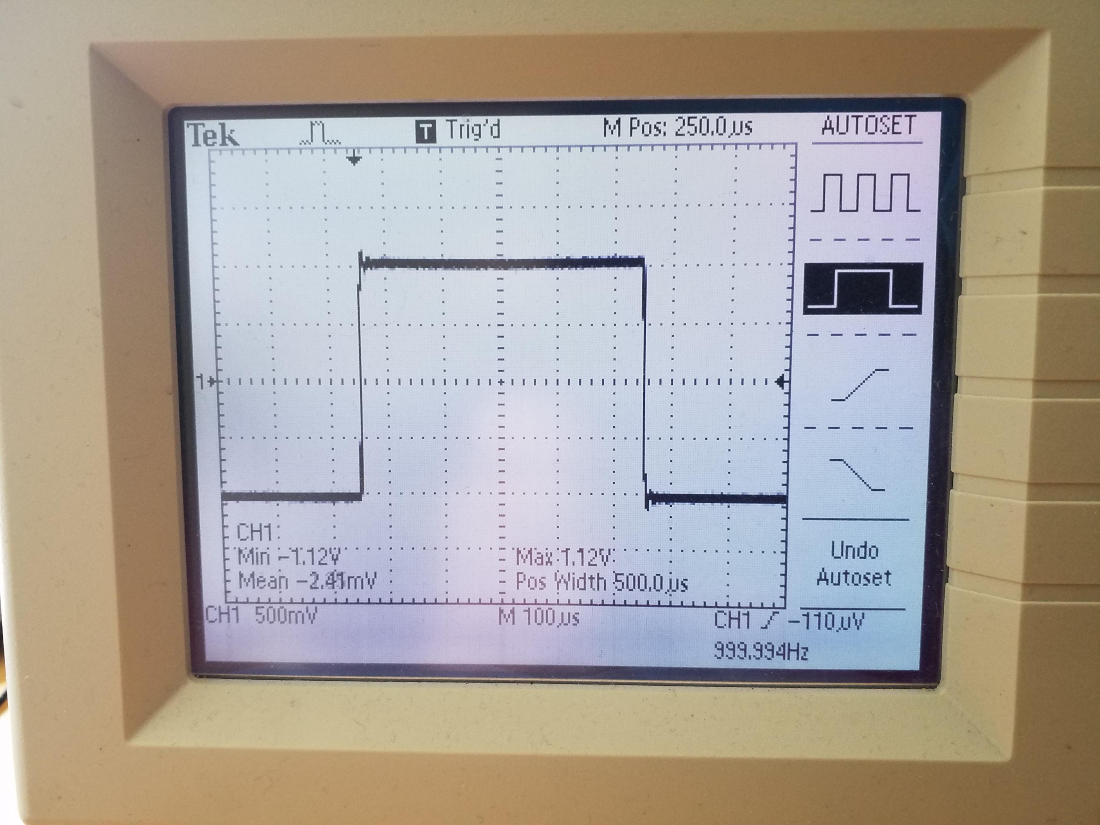

Pic 4.
10khz 4r7 load.

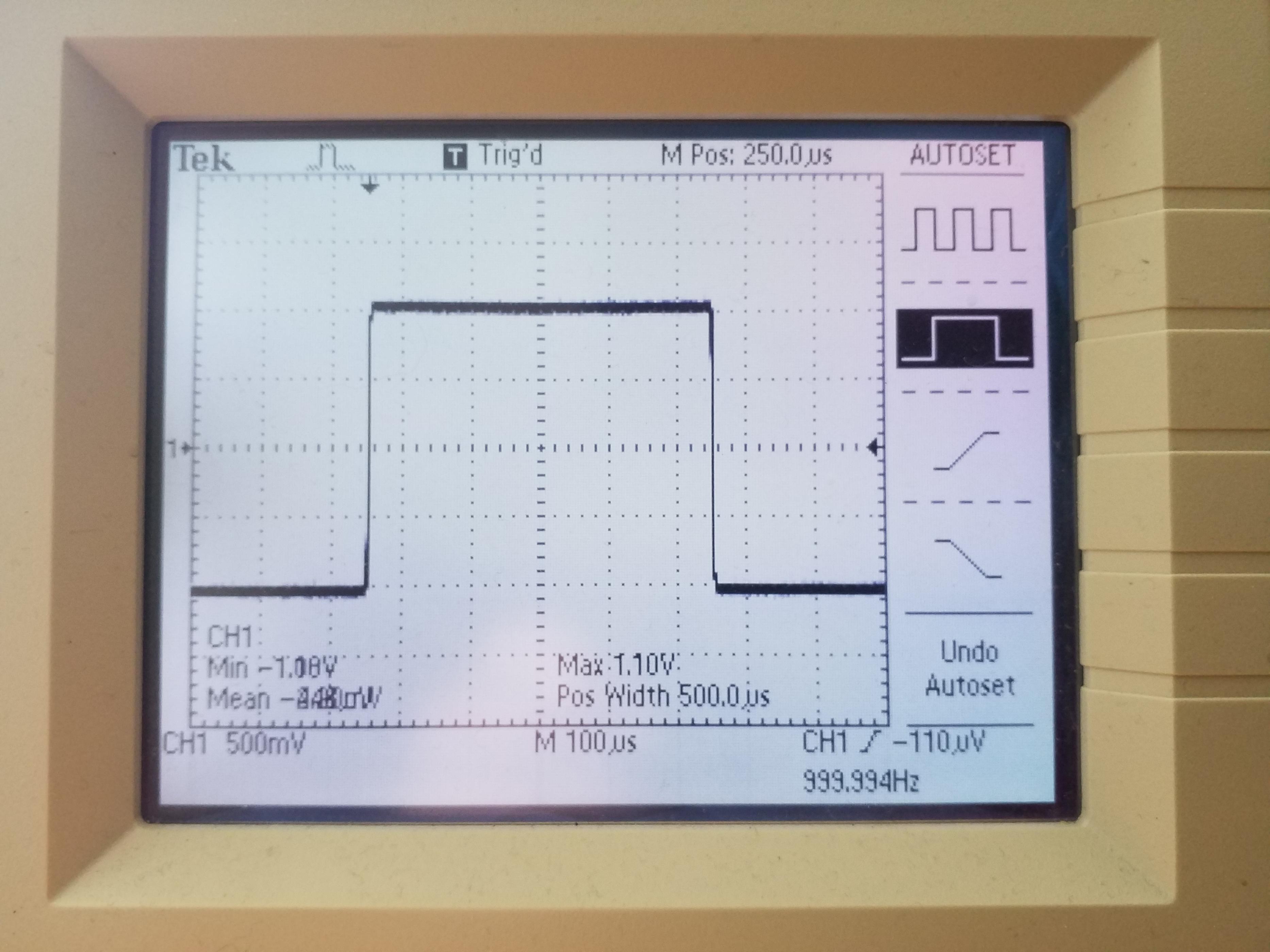

Pic 5.
10khz 4r7 load and 0.5uf.
Pic 6.
10khz 4r7 load and 1uf.
I can surely see the stress the capacitor causes.
Will measure some more

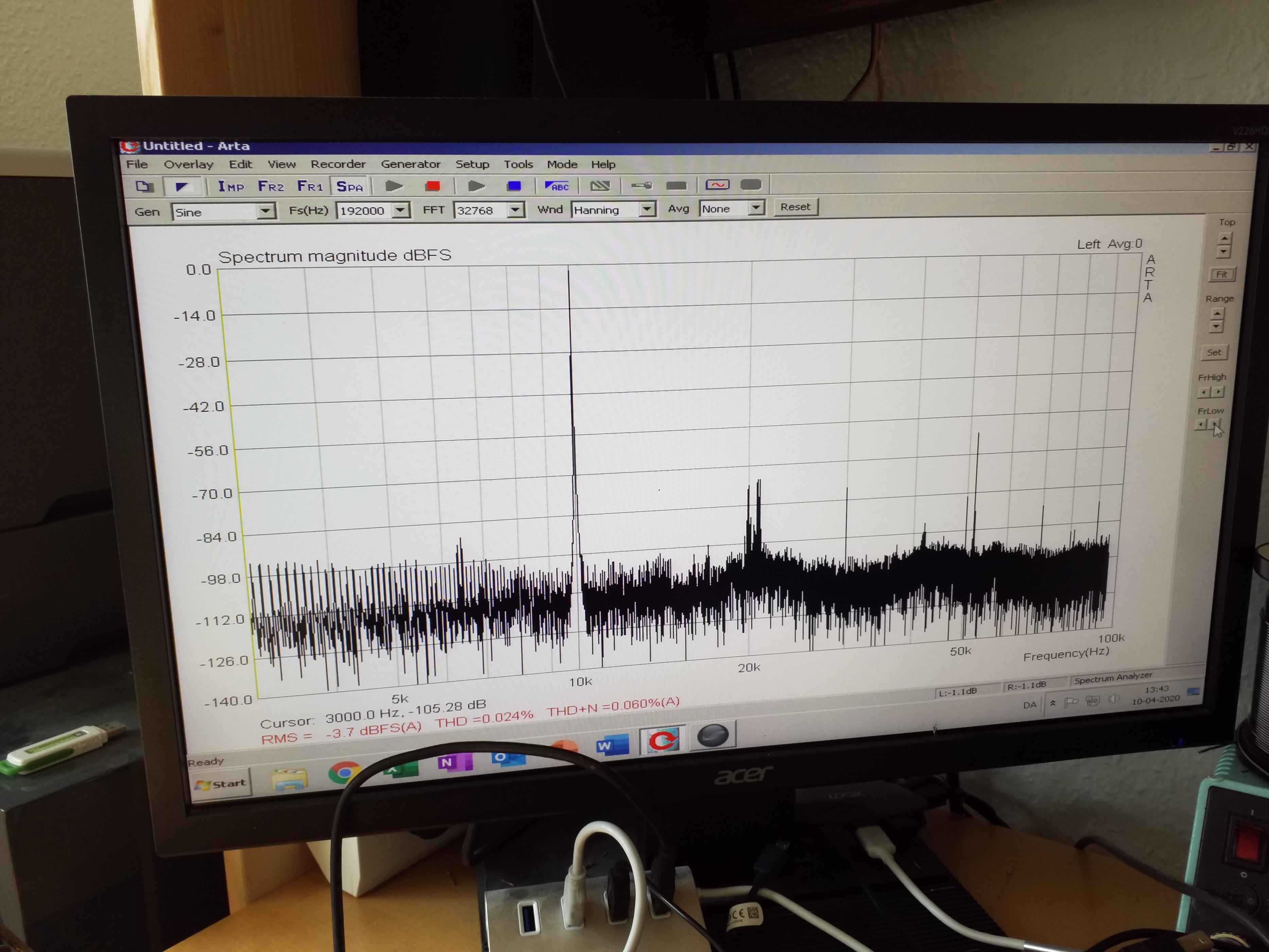

And here are two arta measurements, again at 1 amp bias and 1 volt rms across 4r7 resistor, 1khz and 10khz, I'm sure I can lower the noise floor more with better cable dressing and maybe crank the bias higher, but the outputs got alarming hot, still only using two outputs, and the insulators were some old I had laying around, I ordered some new ceramic insulators and to-3 sockets, do any of you have experience with the ceramic insulators??
I saw two different thicknesses 1mm and 2mm, I went for the thinnest, the thick are some ussr army leftovers, the dealer said they might be berylium oxide, I've heard it should be a great heat conductor.
:wave:
Ps. Tried also same with 500nf, THD was unchanged.

I would use 0.7A bias. Lets be honest. 5 watts 20 watts 100 watts. It's 5 to 100 that is a big difference. PSU colouration is reduced if lower bias. If the third harmonic drops and the rest is looking nice then best use 1 amp.
The big problem is an electrical insulator is also a heat insulator. As 400VDC could be used the insulator might be a poor heat conductor. It's the inability for electrons to move that is the factor. What one could do is use one NPN direct to the heat sink and two at the bottom on washers. Double high gain VAS if so.
I would like a lower bias, I don't like those hot outputs, but whilst watching arta spectrum analyzer I could se THD getting lower with increased bias, but again the high currents do increase psu ripple drastically, so adjust it to lowest possible 3rd harmonics would be ideal, I hear you regarding insulators, and I'm a bit skeptic but will try them out, and why not get a before and after temp reading se it's any good, come to think I do have a large to-3 tunnel heatsink, with separate heatsink for each device, for direct mounting, vertical raised the chimney effect could do the trick, I'm not interested in forced cooling

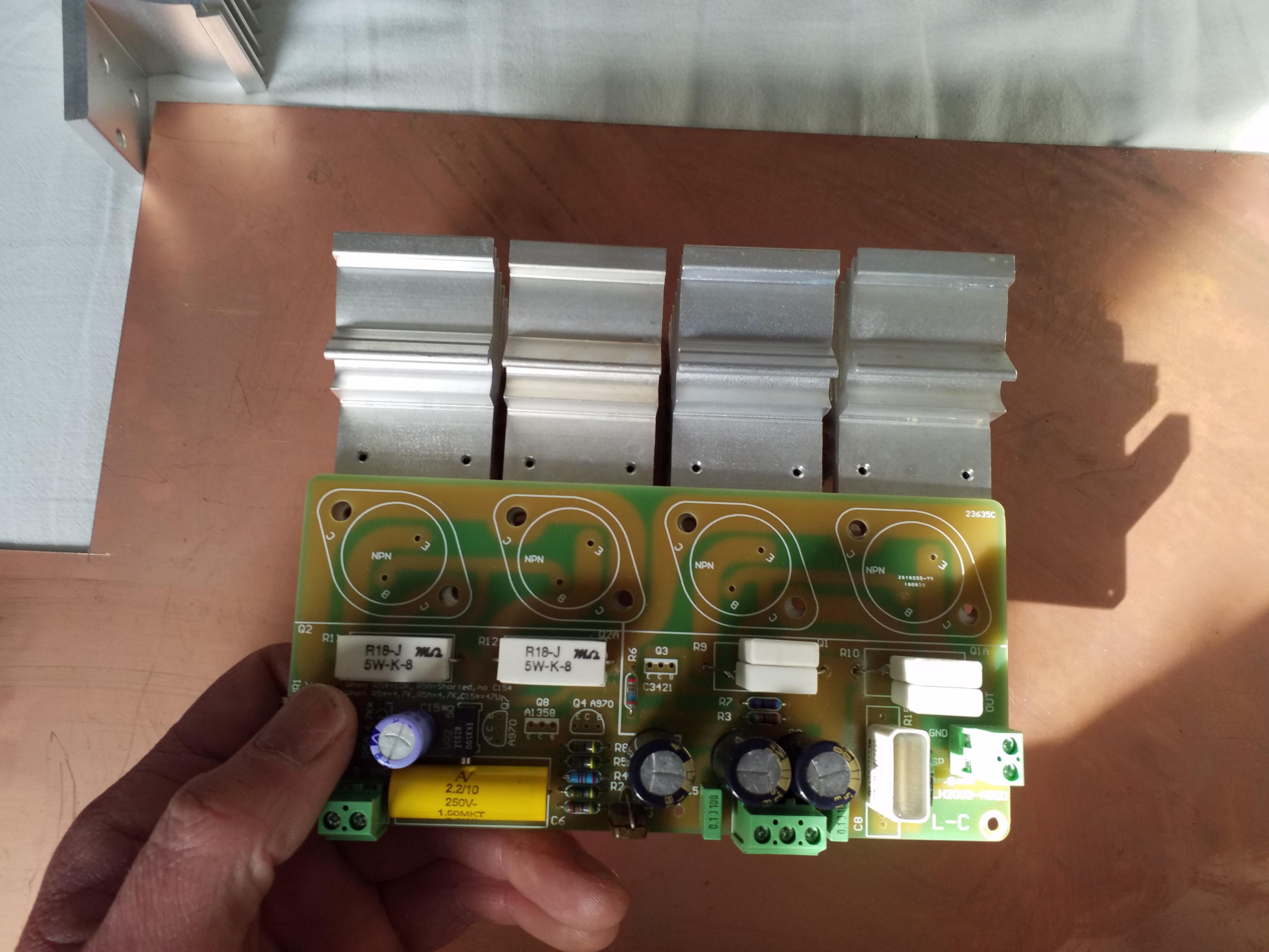

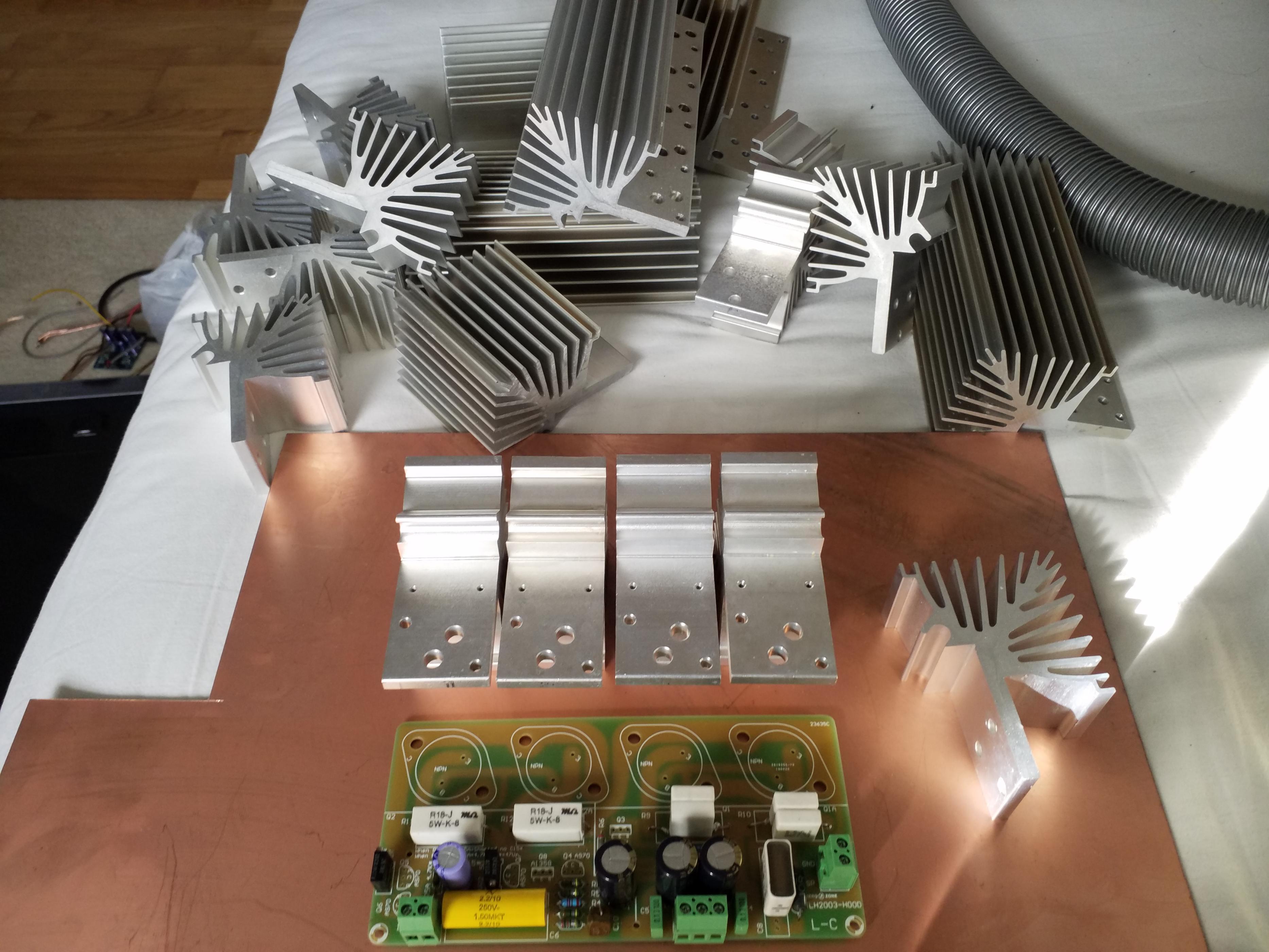

Four smaller heatsink insulated from each other could be best. No insulators required. Some heat transfer compounds look like washers. Like me you probably use what you have. It's not the heatsinks as much as transistor temperature. You can find an amplifier that has worked hot suddenly fails.
I checked some old boxes and found a pile of heatsinks, that's four small ones, you think they would be adequate?.
There's roughly 3-4mm space between them when fixed to pcb, not bad.
