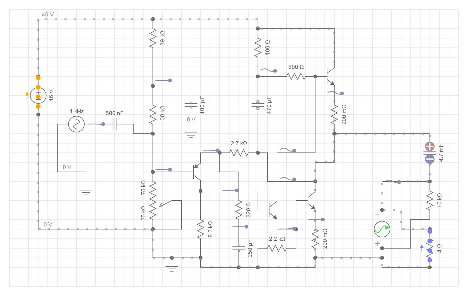

JLH 10 Watt class A amplifier
2N3055's are old designed, cheap transistors, totally unsuitable,
unusable for high fidelity amplifiers...
Regards, PL.
Dunno about that. Sure, the design is old, but for an A/AB audio amplifier, you won't need a fT above 0.8MHz. The newer OnSemi 2N3055Gs are great BJTs for Class A operation, have a fT of 2.5MHz, and are RoHS compliant.
I just looked up MJ480 as I believe JLH used. Very reasonable specs. Gain 30 to 200 and fT 4MHz. Slightly better than a typical 2N3055. From memory TIP3055 is better. One person here said TIP3055 is not a true 2N3055. Some Indian 3055 I used might be another T0247 type in a T03 can. They seemed rather good.

for my ears, the simplest jlh (without bias potentiometer) is the one that sounds best but the power supply represents 90% of the volume and the final result.
You probably are not far from me here in Dorset. Friends in Belgium, France and Luxembourg inform us of life. Hi fi is a beautiful diversion.
I shall make a RH34 amplifier one day. I did try one. I couldn't match the specification given by Alex Kitic. My valve design used positive feedback as does the JLH bootstrap.
