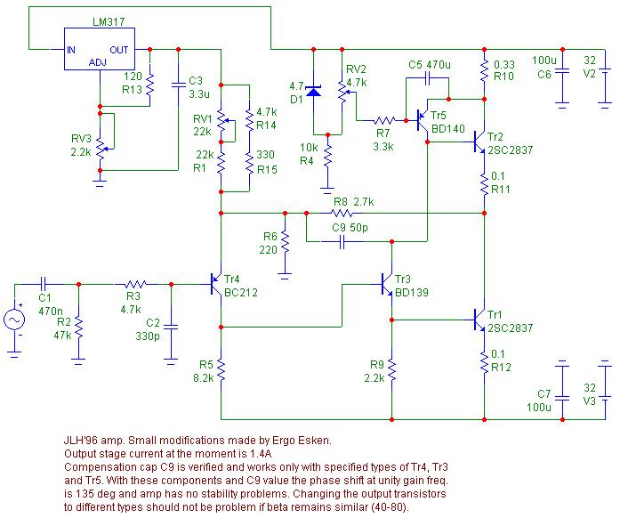

My amps are using Williamshart PCB's....
The layout is quite well made, but a little warning is in order. On the web page these are advertiesed as very high quality PCB's. The ones I received have very thin tinned tracks, no double thickness anywhere..... I ran copper wire along tracks that carry current to overcome this.

I'm glad to see you have used the JLH preferred position for the compensation capacitor rather than the usual cap between the collector and base of the VAS.

I like this method of compensation too. Until now it's more of a gut feeling, but it seems there are guys out there who confirm this. Hugh Dean also said that the cap between base and collector of voltage amp degrades sound more.
Well, we have a plan with a friend to buy Welleman PC Scope and Signal Generator. With this setup it will be possible to measure freq/phase response up to 1MHz. Then I think it will be very informative and I will post the results.....
It will also help to fine tune the cap even further. Current measurements of phase were done with dual channel scope and it's quite hard work 🙂
Ergo
