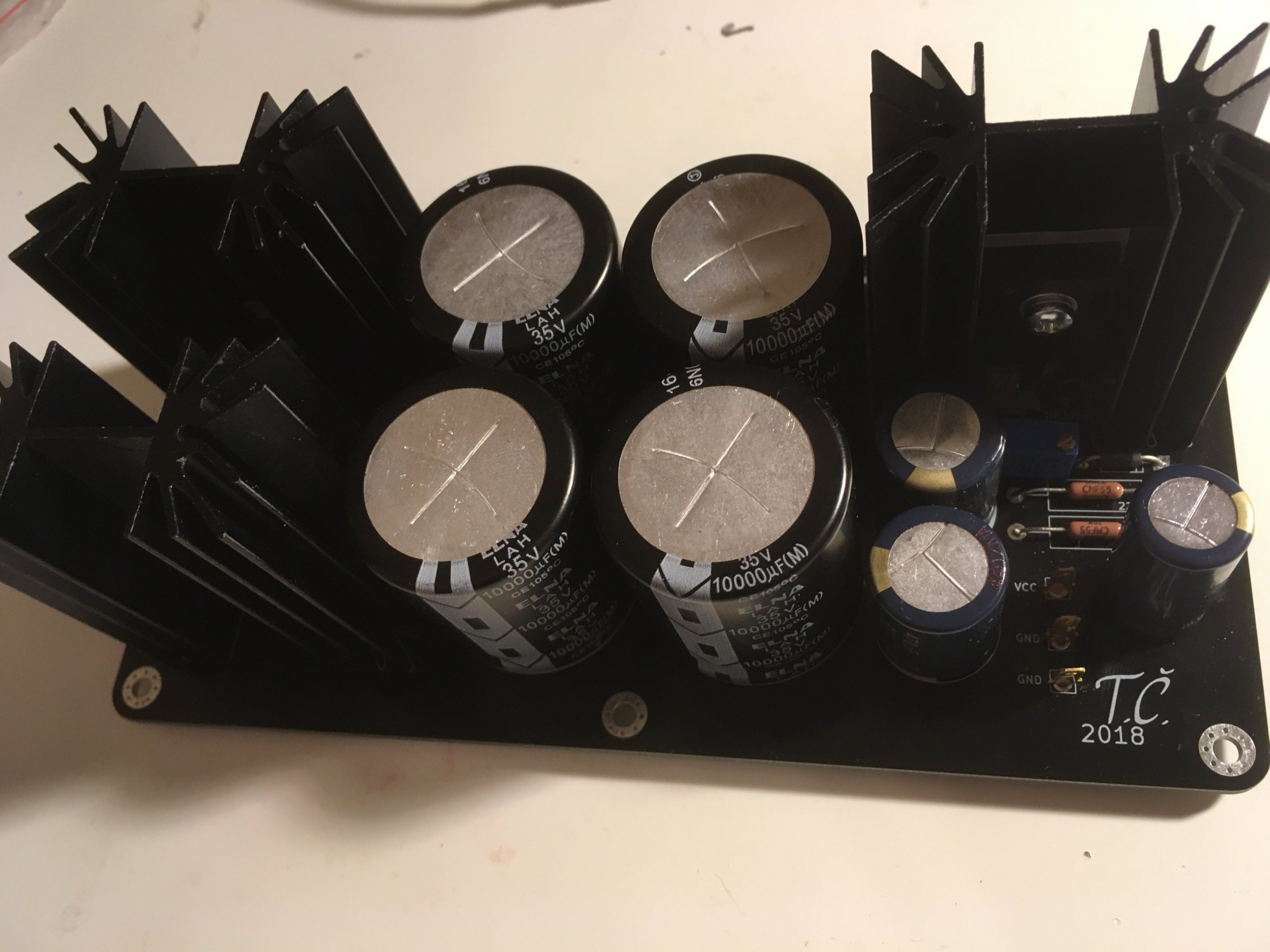

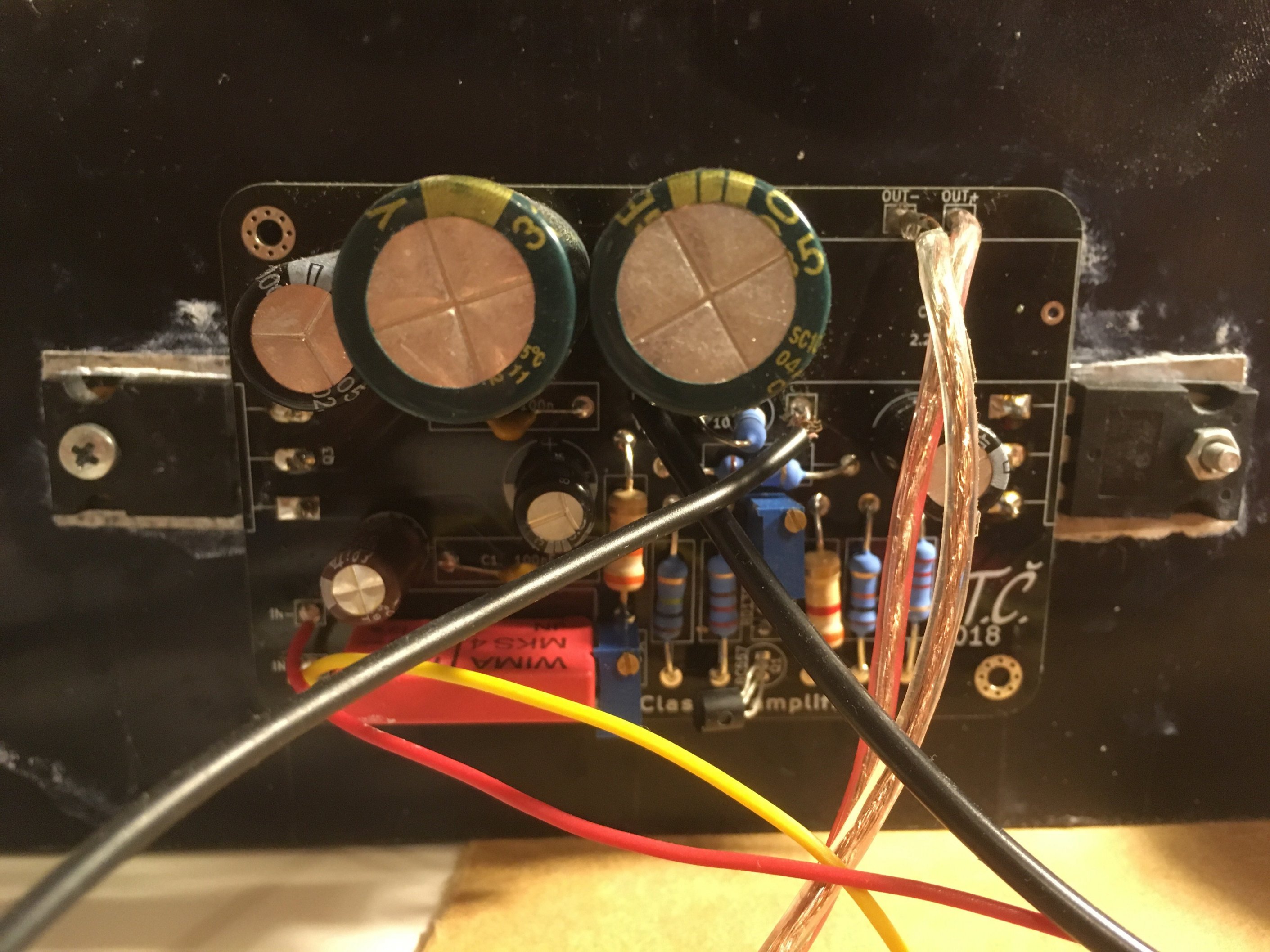

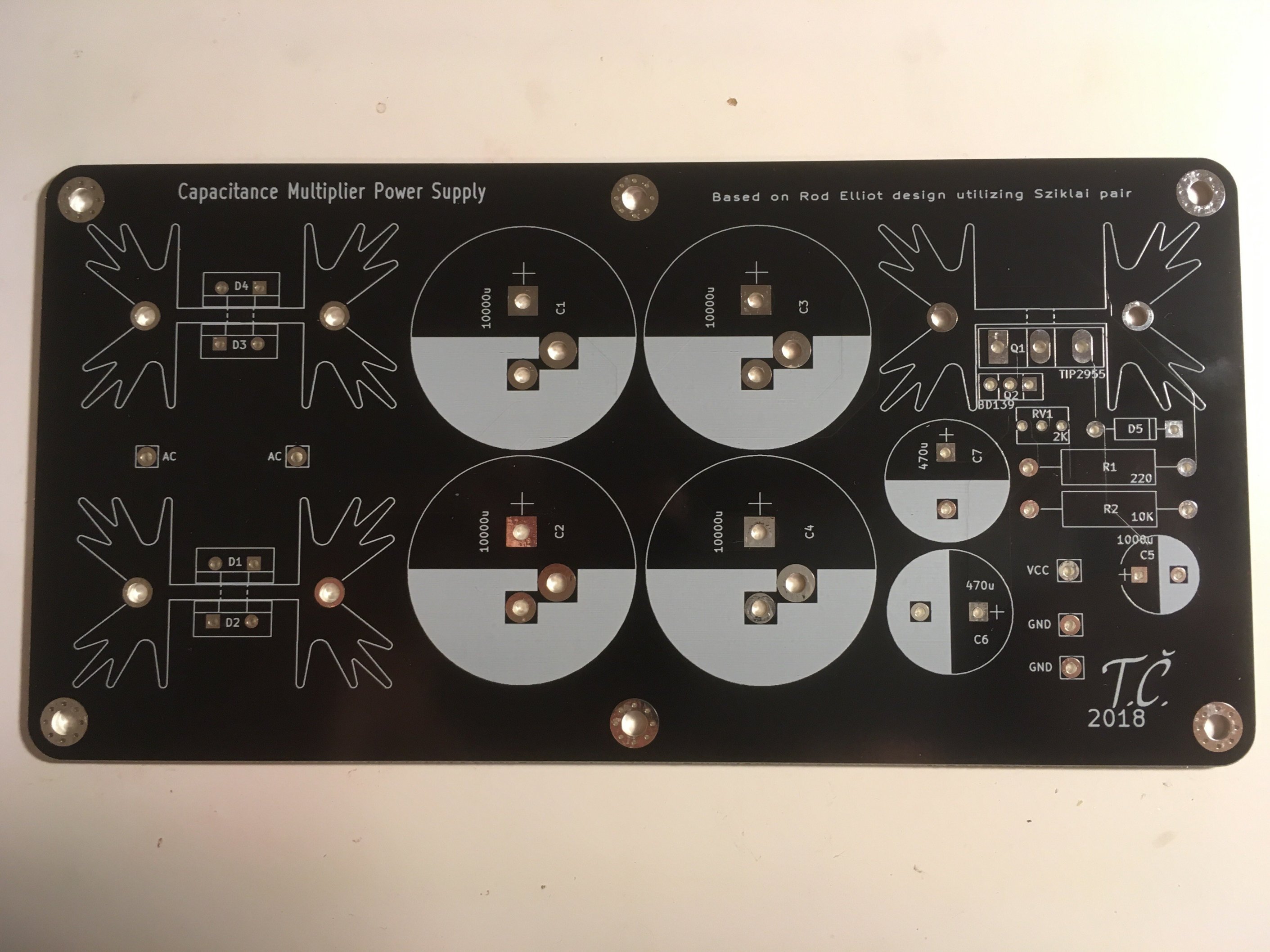

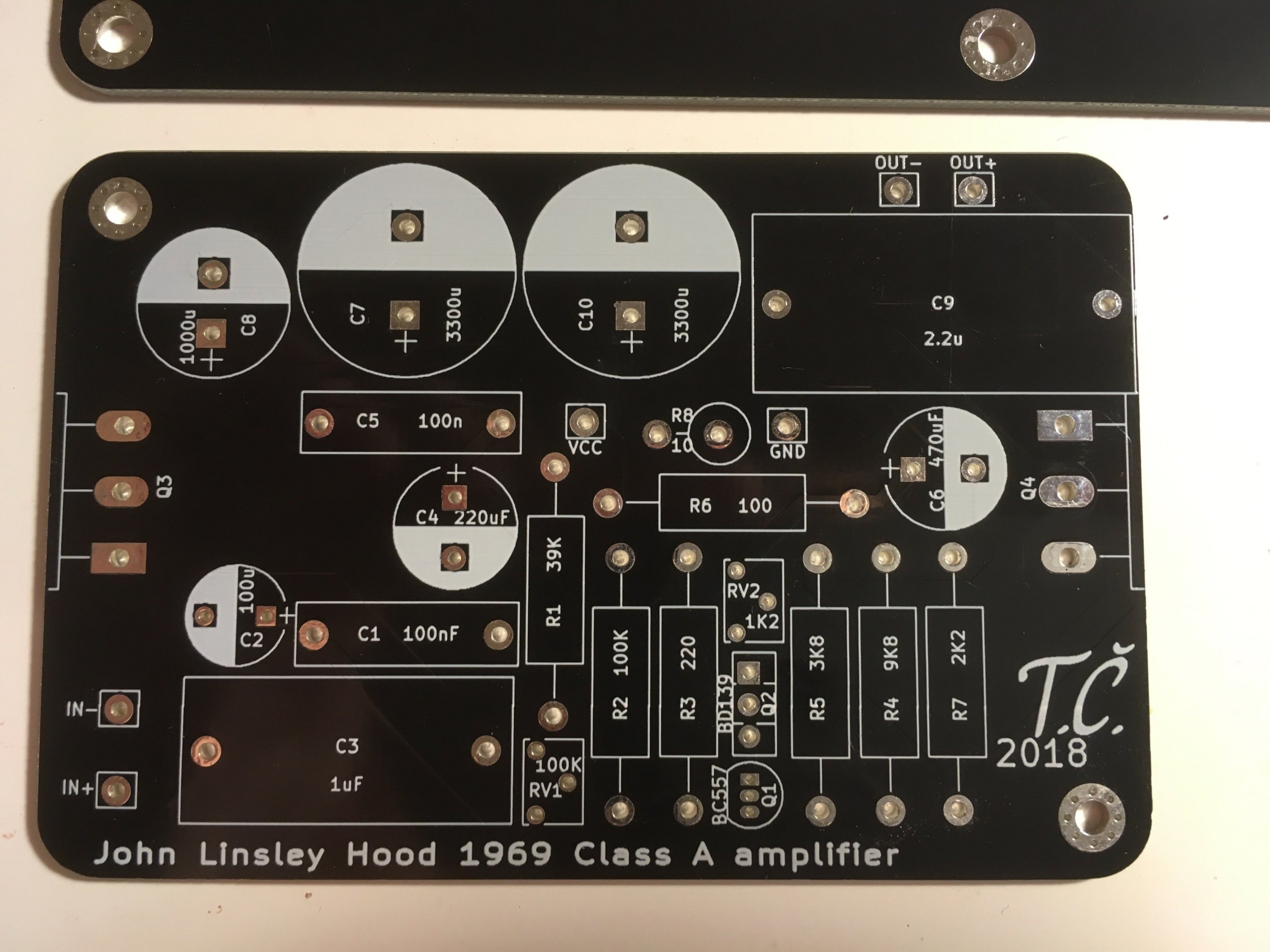

After having JLH '69 without a case for around a year, I decided to finally finish the amp. Wanting to make it better quality than current hand etched pcb and not very tidy psu, I tried tracing pcbs and had them made.
Recently I got my pcbs and I really like how they turned out so I thought I'd share it with you.
Currently I have one channel of the amp soldered with cheapest parts I could get for testing (it was my first pcb after all), which works perfectly. So now 2 channels with decent parts to come. And also I have soldered one PSU board which works fine except that I had to solder TIP2955 using wires, because someone mixed colector and emiter when redrawing Rod Elliots schematic (damn me :D).

Cerniu - I like your PCB.
