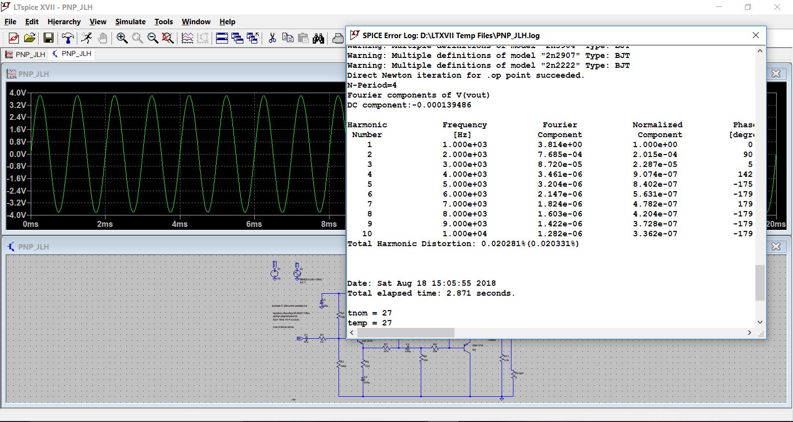

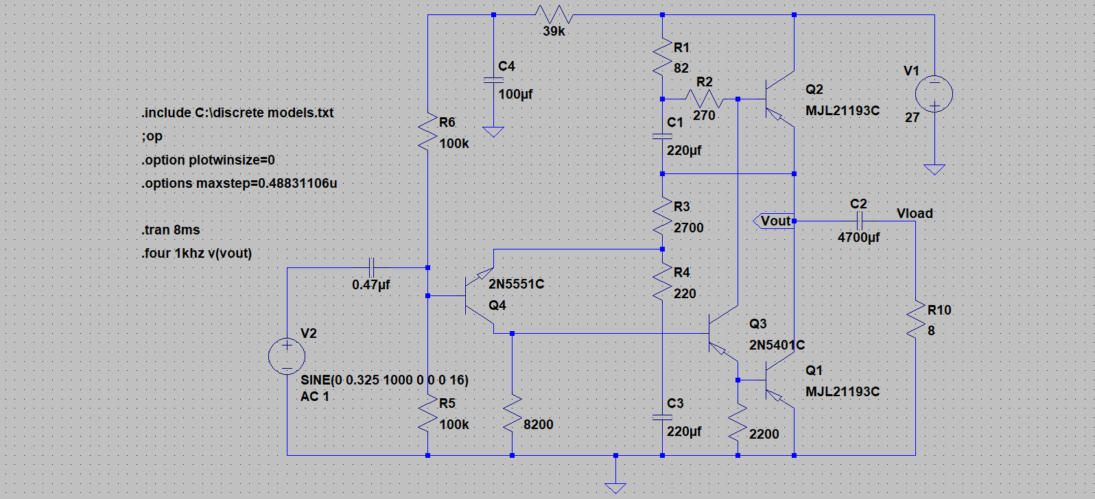

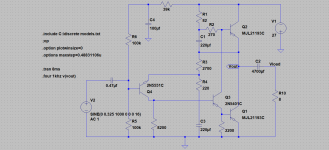

A true PNP version of the JLH should be configured as positive earth. Post your .asc file and I'll try it out.

Thanks Mooly, I'll upload them this evening when I get back from work.

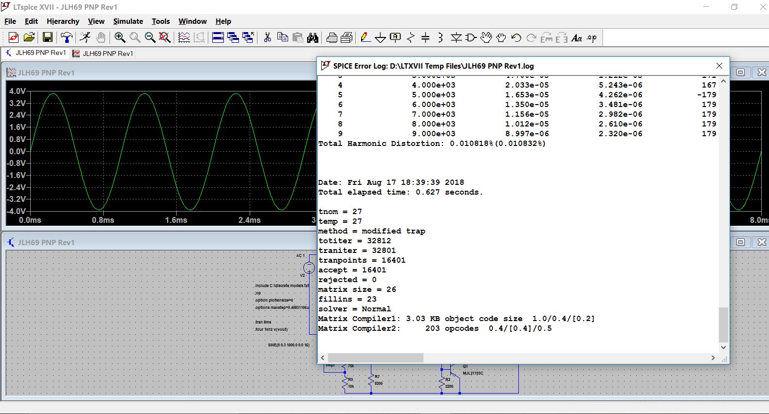

Just regarding the input sine voltage - I usually run a .step until I find the clipping point then back the input voltage down a little before working on the circuit for distortion.
Is there a specific input voltage point that I should be setting - some kind of standard like 1/2 or 2/3 clipping?
Cheers

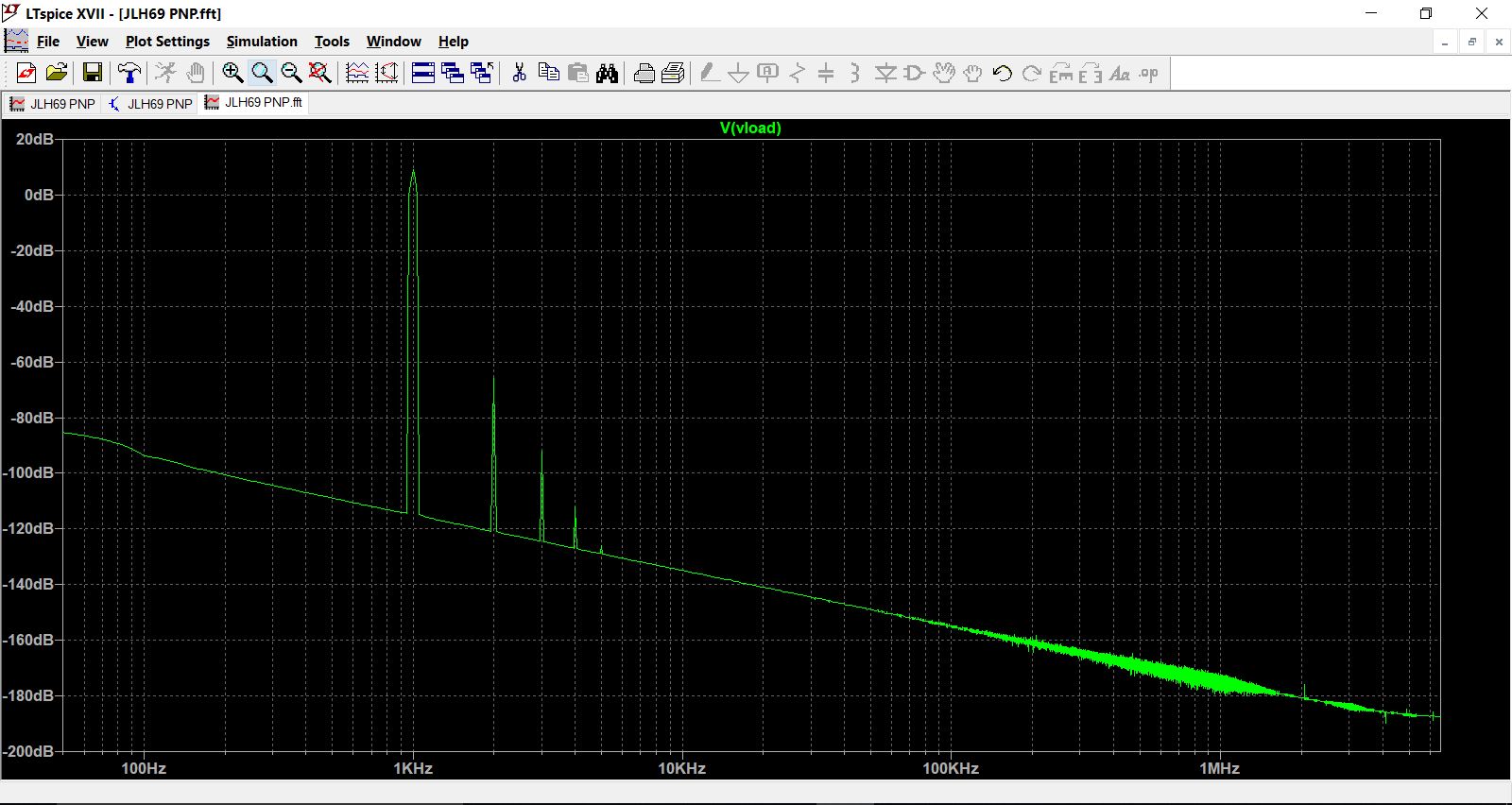

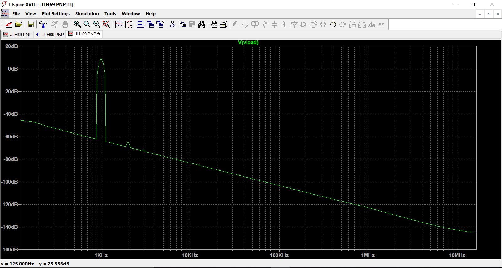

Most of the .op commands were inherited from other's examples. The {freq} parameters etc were for running .step commands to find clipping etc.
I'd love to play with a corrected version if you don't mind uploading a copy?
Cheers

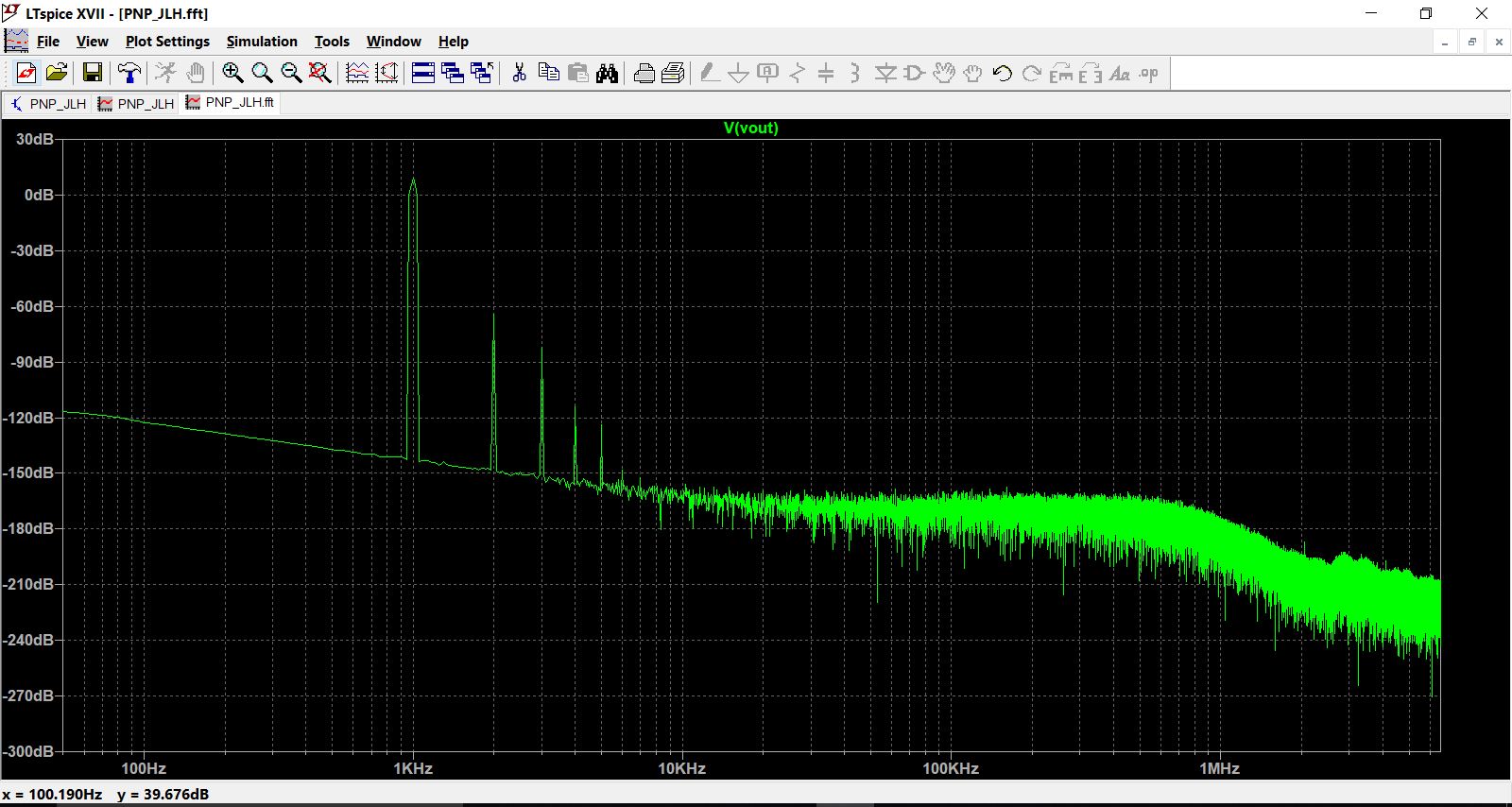

Here you go. Your sim I have altered to make all the caps massive (all 1 which is 1 Farad). This improves the visual result of the FFT and removes the slant that would otherwise appear. Input voltage set to give approx. 2.83vrms output which is 1 watt into 8 ohms.
Simulation time is set for 800ms and to start saving data from 600ms. That greatly improves the FFT result.
My original sim is just 'as is'. You can see the difference in the FFT due to leaving the caps at the design value and running the FFT for a shorter time (80ms and saving data from 60ms) and finally just running and saving for 8ms.

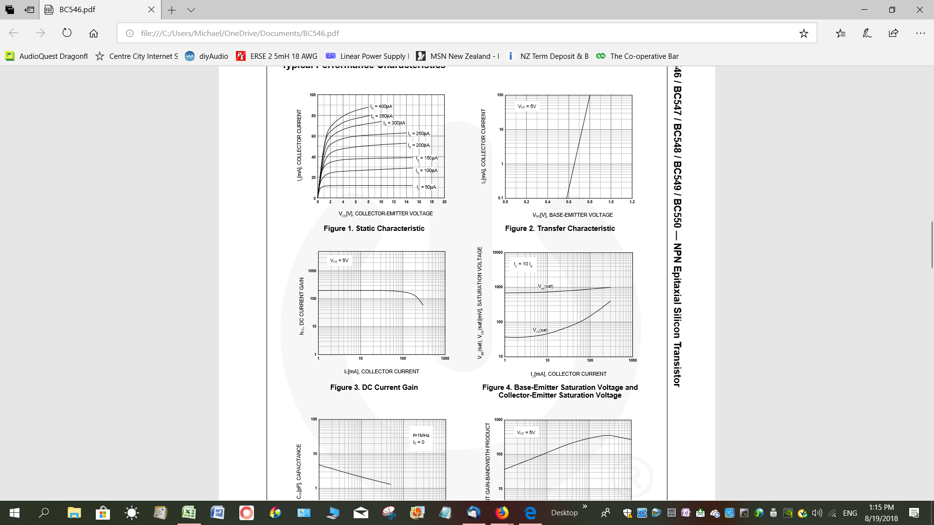

What I said was if with a transistor having a current gain of 100 the collector current in whatever units chosen would be 99% of the emitter current.
That leaves a difference of 1% in what ever units chosen for the base current.
The fact that the bias has to be arranged such that the base to emitter voltage results in a linear relationship between that and collector current is a given. For more on this see the extract of the BC546 spec sheet attached.
The fact that the 1% base current is small does not mean it is "weak" in a common emitter amplifier. The smaller this can be made the reduction in the range of operating current will make for a more linear result. This is possible using devices like BC546.
In an earlier post I gave a formula for Av the voltage gain of a common emitter stage. If you refer back to this an increase in Collector current will result in an increase in Av.
In a Class B system there will not be a great variation in collector current since the output stage involves a pair of drivers ahead of the power transistors and the foregoing points would be handy for that purpose.
This can still apply to the JLH input stage which also takes the form of a common emitter amplifier. However the split -phase transistor circuit will need to work a lot harder which rules out the use of a nice device like BC546 for this job.
Thus one has to be resigned to the facts the working current range of the selected device will be greater and it will not work quite as well as a BC546 or BC556 for the input transistor.
