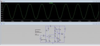

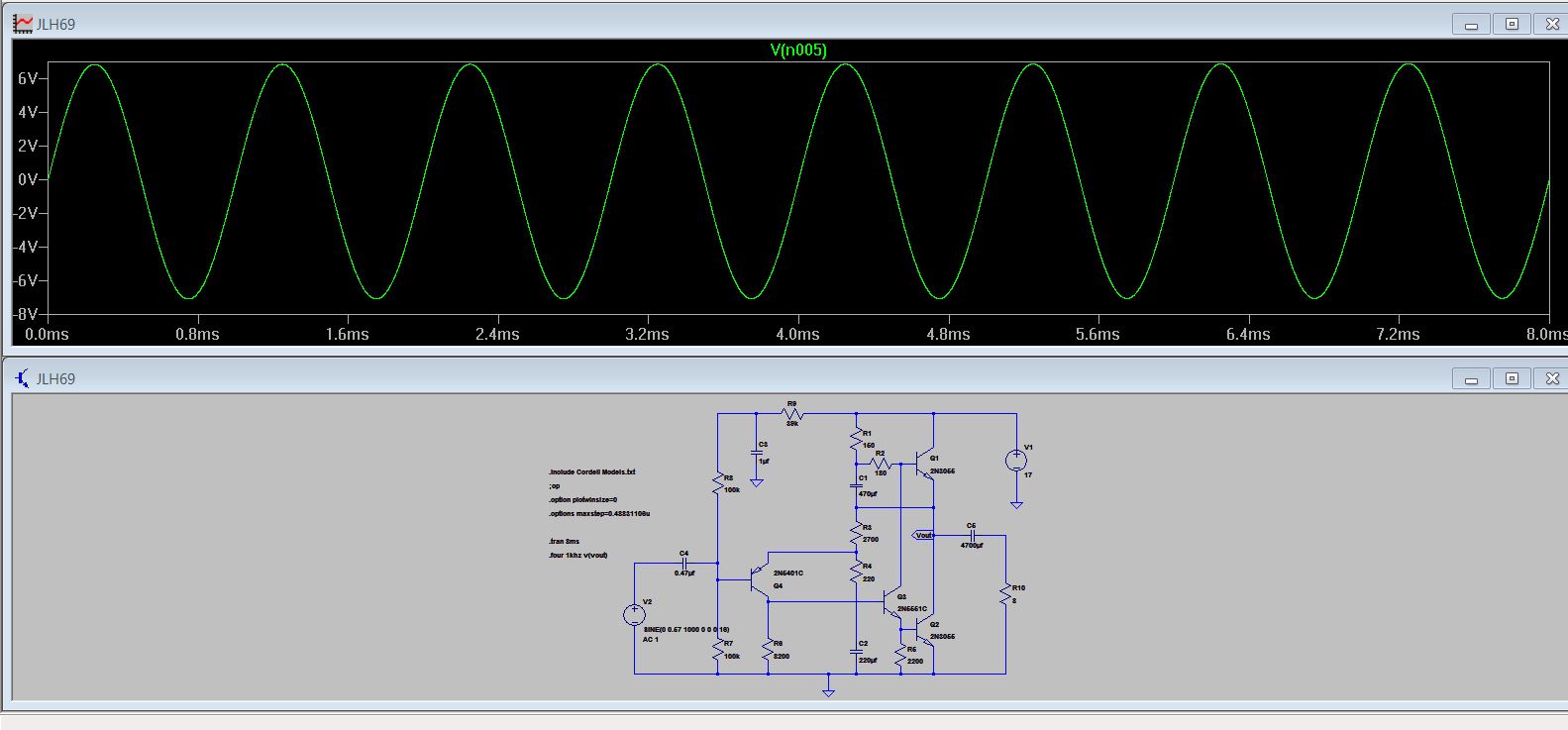

Here is the original JLH running as low as 500ma bias. Lets be clear on the question. Running it at 1 amp as you wish doesn't really fit the accepted definition of Class AB. To me a class AB amp is one running at the correct current for the output stage topology chosen.
Your making me want to figure out how to use LTspice. Good thing I have a few projects to finish first, looks like I will have to brush up on my transistor theory. I was just trying to get a head start on this one since I have to get the transistors mailed in (Slow boat from China you know).
If you install LTspice here is the file that will run straight off. Just unzip the folder and keep the two files together. If you want to try it and get stuck just ask... I knew zilch about using spice 12 months ago.

17VdcBias means Vpk = (17/2) - 0.7 = 7.8Vpk circa, or 7.8/sqrt(2) = 5,15Vrms = circa 5Vrms.
This value would be the same even if the loud would be 4ohm and it is incorrelate, until a specific value, to Ibias; it is directly tied to Vcc.
The actual peak current in the output stage will be around 900ma
So: 7.8Vpk / 8ohm = 975mA pk.
Yes, but whit an Ibias = 500mA we can only have an Ipk = 500mA*sqrt(2) = 700mA circa.
In this case we have 275mA of undervalue, that it means that after 700mA pk output current the amplifier is (heavily) clipping.
(falling almost to zero as the output voltage swings to ground)
