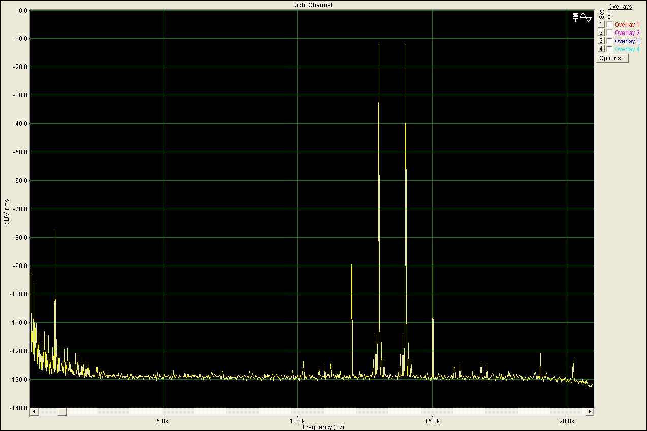

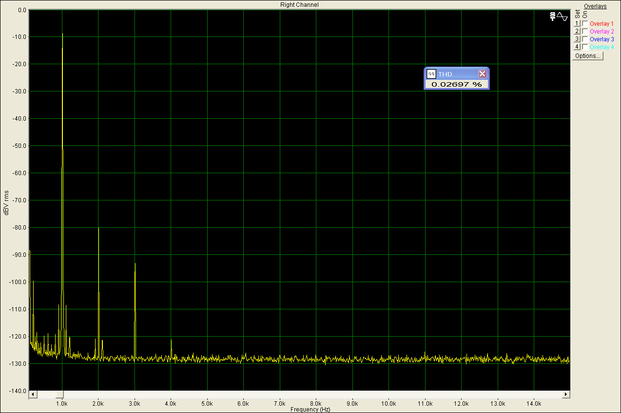

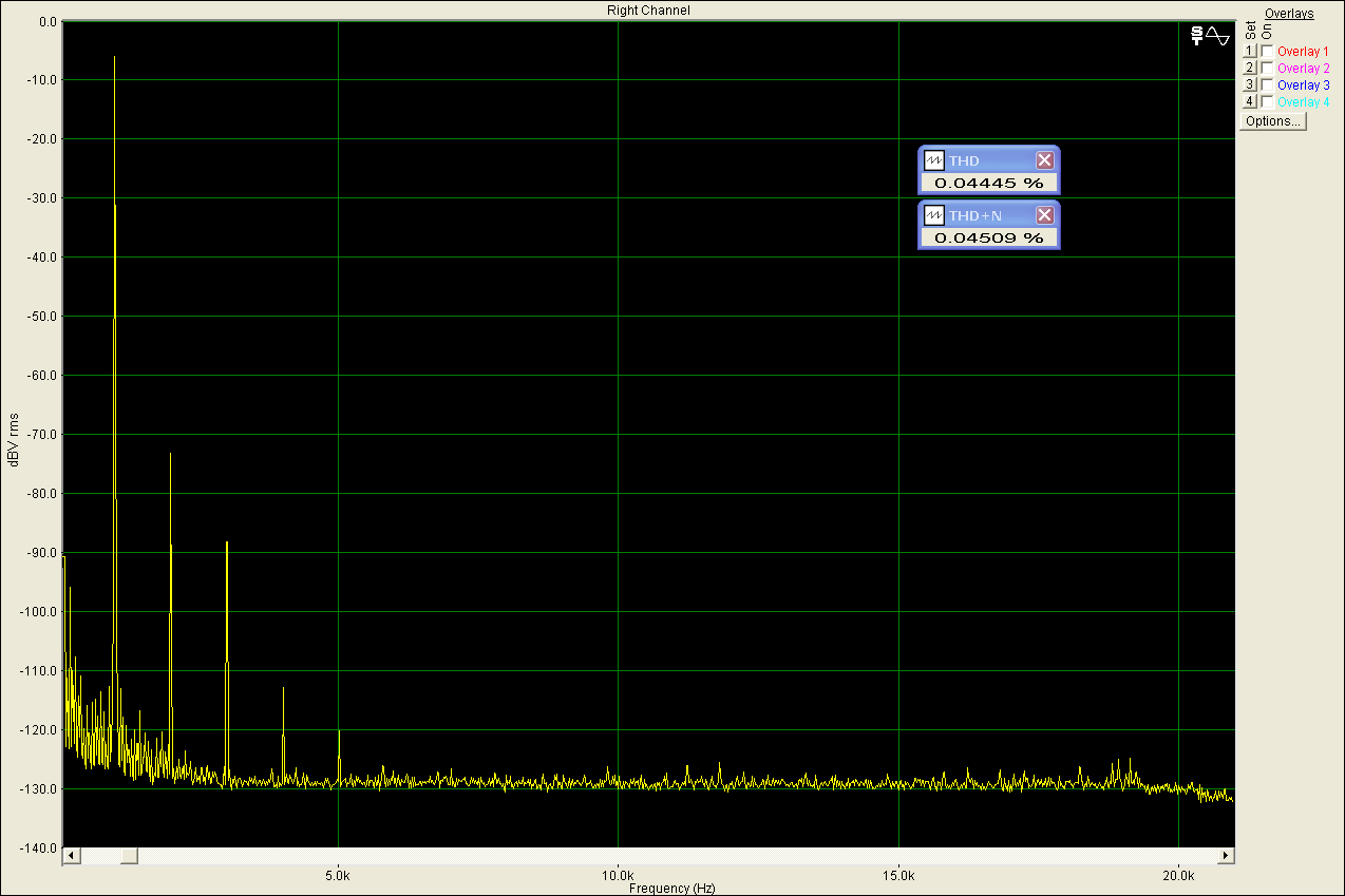

So I have just decided to give it a chance again and to build it with modern solid state devices. I like the original design of 1969 most, for its simplicity and elegance. I have built a sample on a prototype board and supplied it only with +25V supply, which I have unused at the moment. The 1st transistor is BC560, driver is BD139 and output devices are MJL21194. Even with this low supply voltage, the results are stunning. The amplifier is completely free of higher harmonics at any level below clipping, which is the key to its good sound. The OLG is constant high above the audio band. I will probably build a complete stereo amplifier, as I am very curious how it would sound compared to recent amplifiers.

I believe that since it is a completely asymmetrical circuit, this explains the low odd orders and pleasing sound to the ear. It is by no means a low distortion amplifier.

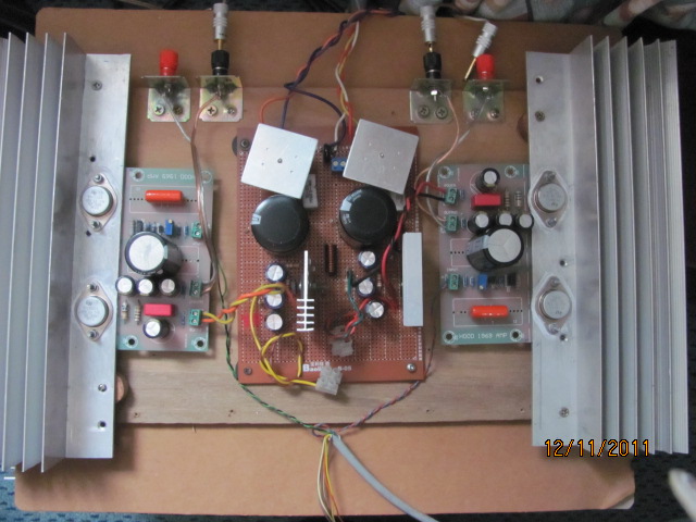

HOW TO ADJUST BIAS
Hi all

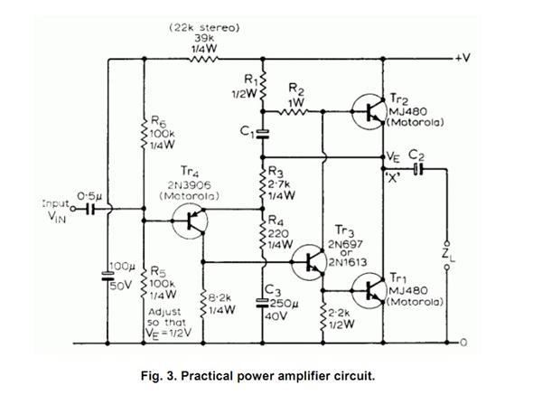

I build the JLh 69 with the original schematic with a 24 V in . This is powering a 8R speaker.It is very nice .
Can you tell me how to adjust the bias in the circuit? Is it R1 adjustment and measuring the current input ?
Sorry for such a simple question
thanks
kp93300
You can adjust either R1 or R2, or both. Increase the values to decrease the current. Reduce the resistor values to increase the current.
To measure the current it will be best if you add a new low value resistor into the circuit, into the collector lead of TR2. Then measure the voltage across the resistor. The current is calculated from voltage / resistor value. A resistor of less than less than 1 ohm is preferred to avoid dissipating too much heat in the resistor.
You want somewhere in the range of 1.5A of idle current - but the real test is whether your heatsinks get too hot - they will get hot but you should be able to put your hand on them for a good 10s before having to remove them.
