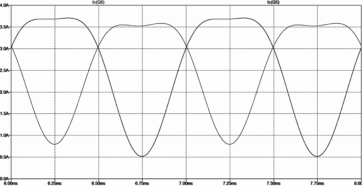

To do the matching properly, you need to match hfe at the working bias.
Not in cases where beta droop will be the dominant flaw.
Base currents at peak output in greatest need of a match.
Base currents balance in quiescent state are completely
manageable by the combo of global loop and offset CCS.
If quiescent HFE doesn't match, bothers almost nothing.
But the maximum base current here is fixed by Q8, and
this loop can't to jack to fix it if the maximum currents
required by output bases do not match.
If one 2n3055 peak flattens earlier than other, match
at any lesser current won't give you that information.
This example is slightly exaggerated, but not by much.

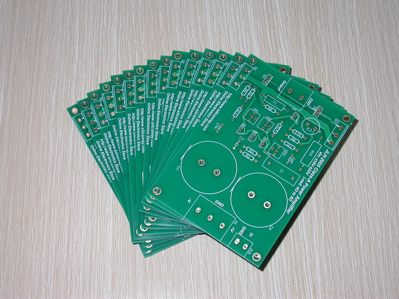

New boards fab out
New version PCB is fab out!
Modifications:
1. connected collectors of Q8 and Q3 (which was missing on the first version)
2. modified footprint of potentiometers. Multi turn pots can also be mounted
3. fixed the bug of small hole for Q8.
4. added a 220uf cap on feedback path. This is an optional component.If you don't need it just short 2 pins of the cap
5. footprint of Q1 and Q2 are modified to which TO-3PL transistors like 2SC3280 can be assembly on board directly.
Free boards keep on offering:

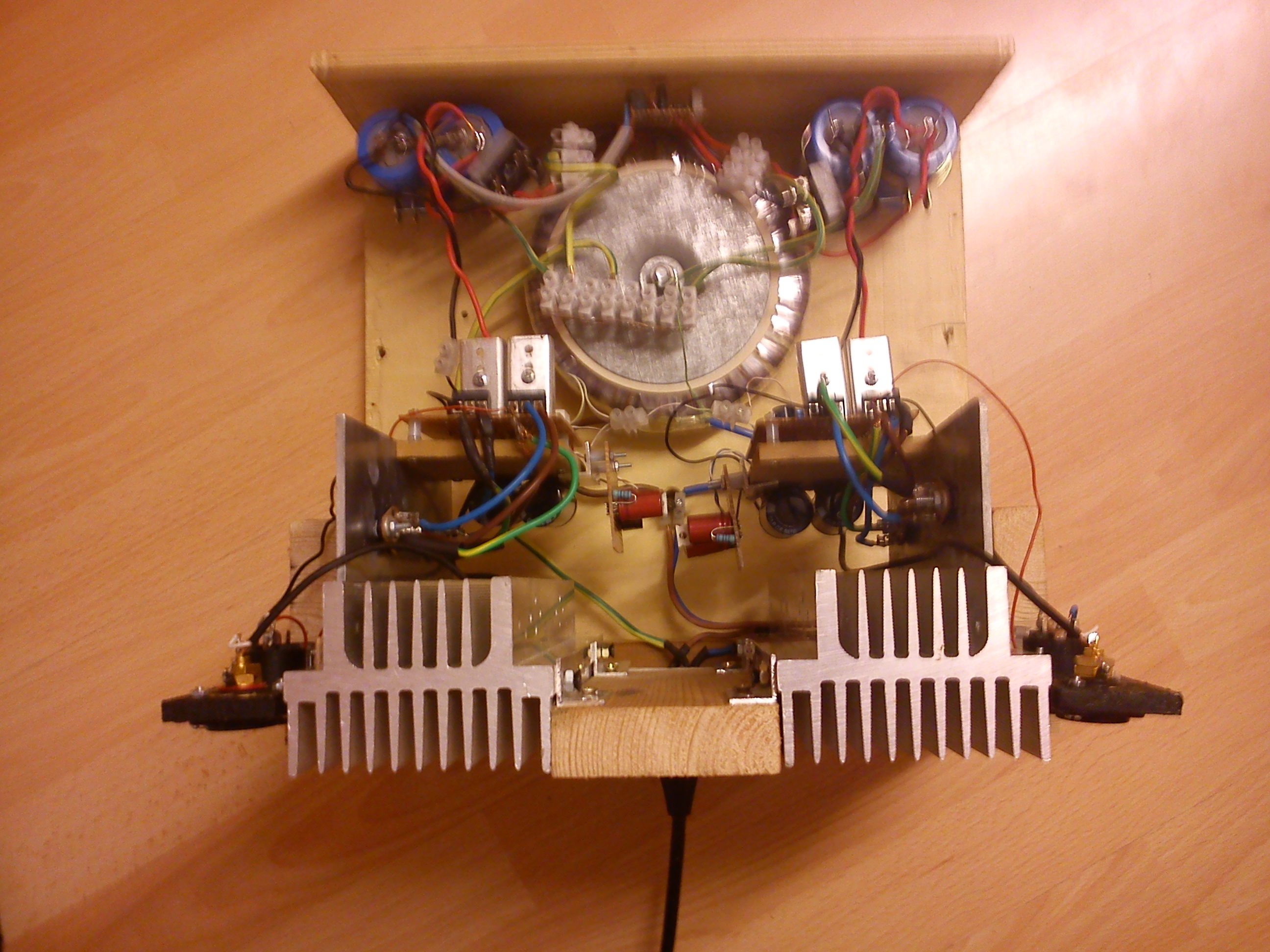

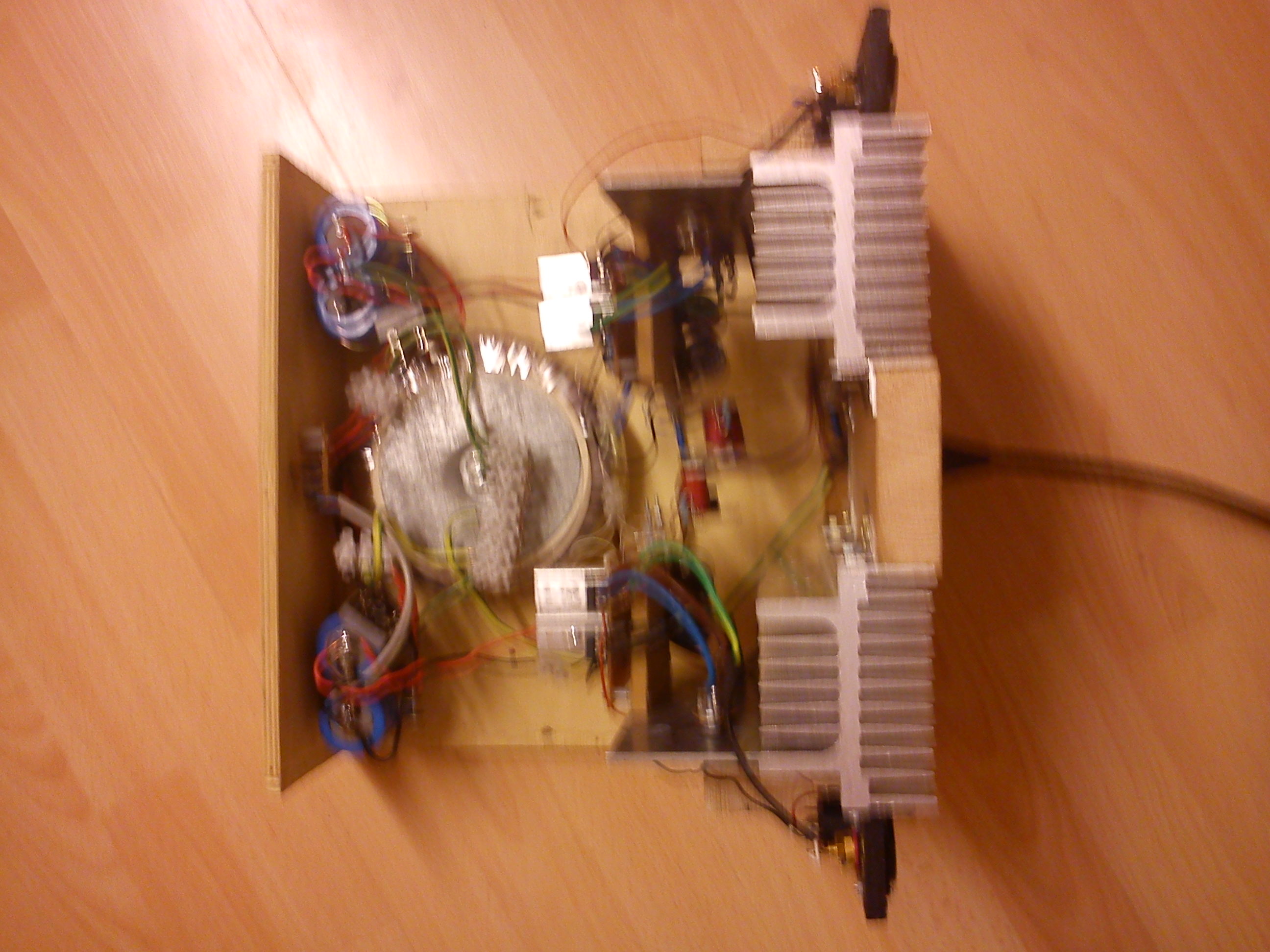

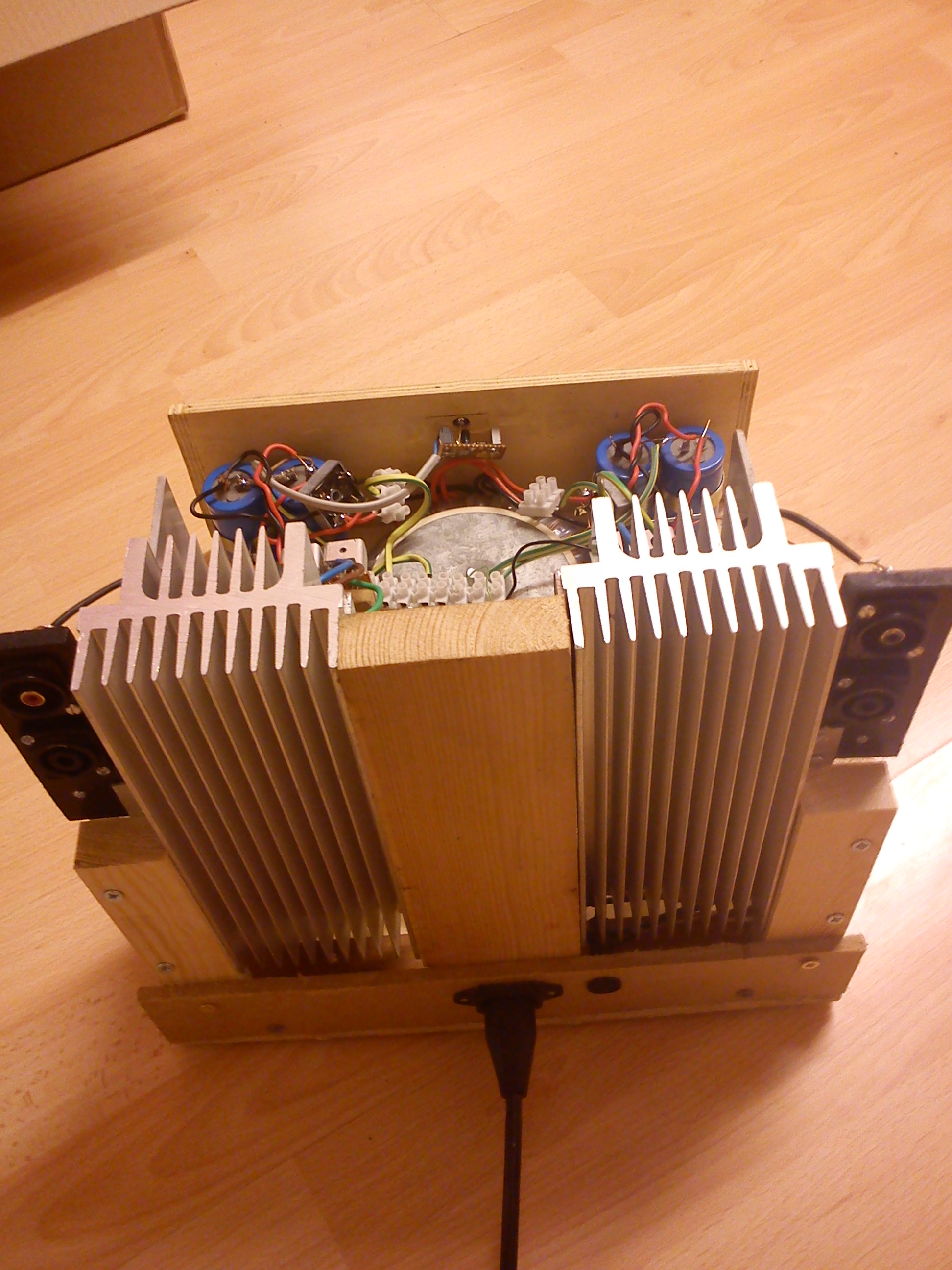

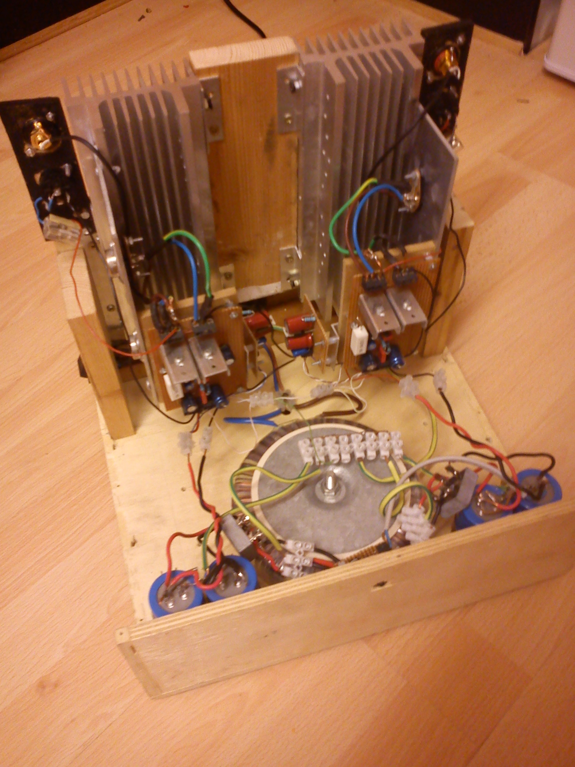

Finally built a chassis (sort of) for my JLH.
Still needs some covering up before it's allowed in the house as a permanent feature.
There's still a tiny amount of hum, which I can live with, and sometimes a weird buzzing when a phono input is half plugged in - I suspect to do with a lack of ground connection from the source somehow. Anyway, not an issue really.
Also quite reassured by the fact it weighs 9.3kg.

You never know, I might use my camera to take a photo one day - rather than my wobbly phone.
I do not know the technical reason it may not be a good practice to subject power lines to the magnetic field of a transformer. But I am pretty sure that it would not do any harm to lay out power lines away from the transformer if possible.
Sorry for my worry too much noise plus I have no proper electronic education et al.
Hi Chris,
You're right, it might be possible there's induced hum, but I think the hum (not that there is much at all - only when there's no signal and you're really close to the speaker) can probably be reduced with further capcitance and possibly some filtering (basically CRC filtering). The weird noise I can only guess is a grounding issue of some sort.
Phil
