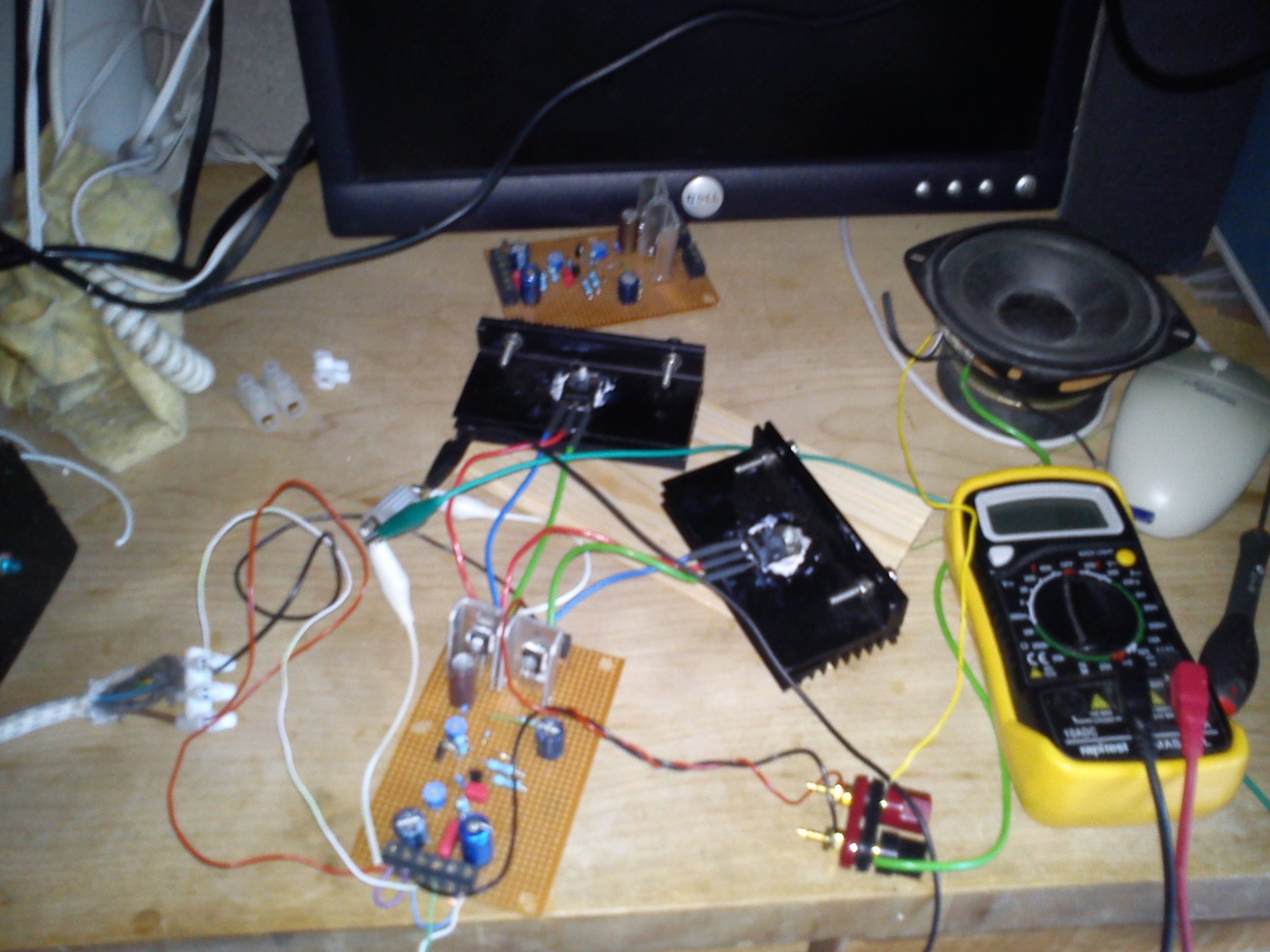

I settled for TIP3055s this time as an experiment, and smaller heatsinks than I wanted to use. They get very hot at 1A, so at the moment, I'm not exceeding that.

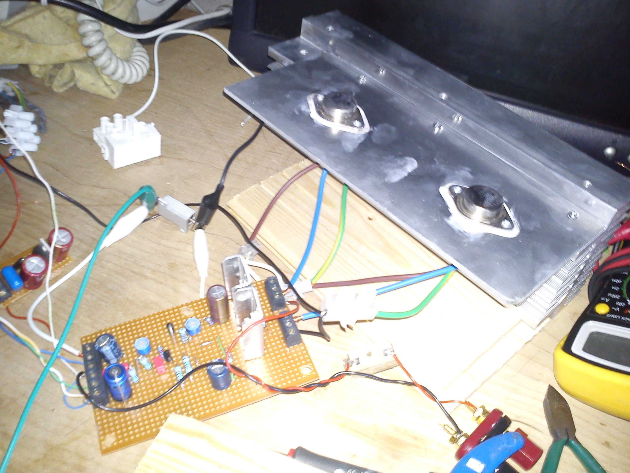

Been fitting a bracket to a big heatsink in order to fit some MJ15003s to see how that sounds (and so I can set a bigger Iq).

Now running with MJ15003s on a bigger heatsink. Takes longer to heat up, but still gets rather hot 🙂. Can't really tell if it's better (possibly is) than TIP3055, as I'm listening in mono, but I can play with increasing Iq.

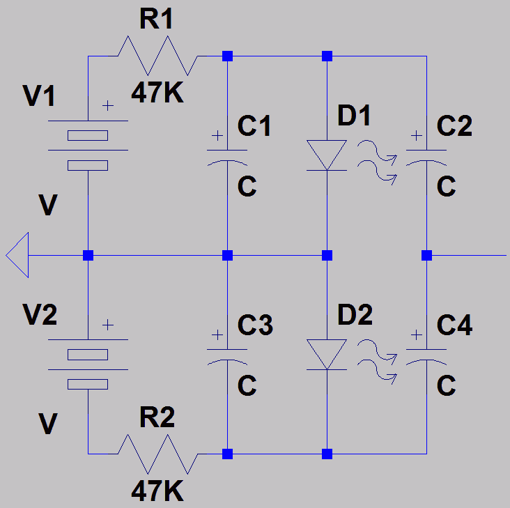

Just to balance things out so there's no thump...
Don't expect diodes to light at such low current.

Thought I'd get some photos to you...
Basically two photos. The first is the first lash up using TIP3055s. They were on small black heatsinks, so they were super hot even at 1A. Then I migrated to MJ15003s, as in the next picture - with a non ideal construction of aluminium sheet bolted to large heatsink (with heatsink compound between the two). Even though this has two devices, it takes a while to get toasty at 1A, so working well enough (even if not strictly perfect).
This evening, it drifted a bit more than last time (still only 2-3 hundredths in half an hour - after the first few minutes of settling). Perhaps there was error in my measurement, but rather stable it seems.
Haven't increased Iq yet, don't see the need yet (I haven't had the chance to play this loud yet - it's in the garage, I'd annoy the neighbours).

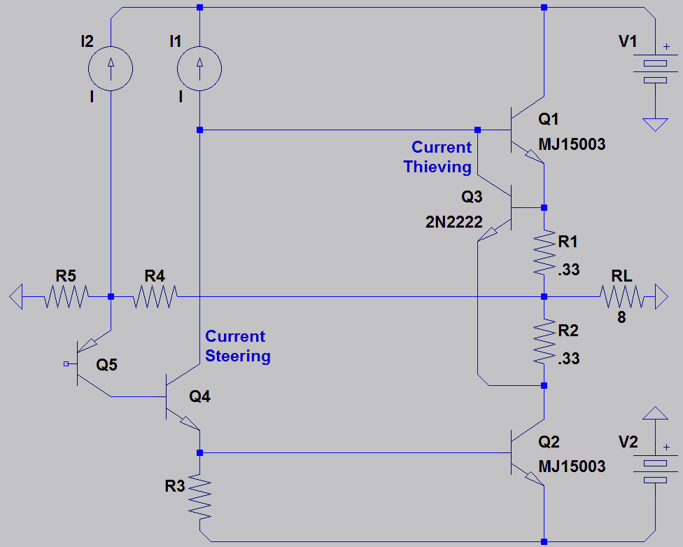

Feel bold enough to become Guinea pig for a shunt regulated bootstrap?
Between your outputs, series a pair of 0.33R for purpose of sensing current.
Loudspeaker load to be connected between resistors, if not self-evident.
Use the voltage drop across these resistors to drive 2n2222 base to emitter.
Tie the collector of this 2n2222 to the base of your upper output transistor,
to steal current from the bootstrap whenever Class A output exceeds 1A.
OK to run your bootstrap a few mA hotter than normal for your 1A output.
Just enough so the 2n2222 always has something extra to shunt, and never
tempted to accidentally turn off.
If you can bond shunt transistor to your heatsink, it will also fight runaway.
Only 1.4V at shunt collector, not likely to become hot of it's own workload.
If it feels heat, current sensed across base to emitter junction goes down.

My proposed solution can be entirely off-board and requires
no extra wires back to the PCB. You want the bias thieving
transistor and current sensing resistors all together on the
output heatsink assembly anyway. Just three components...

You don't need any bootstrap, I just assumed you had built the simplest way
with minimalist component count.
Don't need a fancy CCS. But if you already have one, it won't hurt anything.
The main purpose of shunting is to shape a linear result that can't runaway.
But if you had the older JLH with an unregulated bootstrap, the shunt would
also serve to clean that into an ideal current source.
Note the ideal current sourrce for JLH is not a constant drive current, but
one that produces linear vs linear output currents with a constant sum.
See the three new parts on the right R1 R2 Q3.
Can all be located on heatsink, no board mods or extra wires.
Drive current source I1 does not need to be anything fancy.
The shunt will remove any excess beyond what makes a pair
of linear outputs centered upon 1A quiescent.
