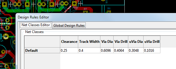

I guess I'm lucky. For hand routed 2- and 4-layer analog PCBs, I've been using the same default setup that shipped with KiCad ten years ago: 16 mil via holes with 24 mil diameter copper surround. It has never been a problem or extra cost with any of the fab shops I've used: Seeed Studio, DorkBotPDX, elecrow, DirtyPCBs, Shenzhen2U, SmartPrototyping, ALLPCB, JLCPCB, OSH Park. Just yesterday I taped out Gerbers to JLCPCB with the attached via sizes and was not charged extra.
Dodged a bullet apparently.

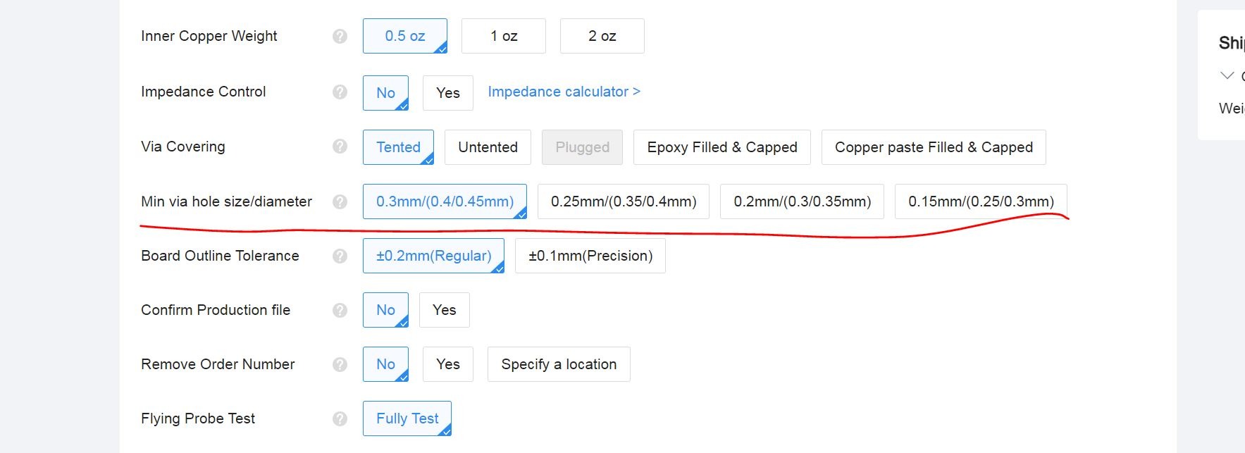

JLCPCB has included options under the ordering process .... see below.
Got a mail today returning on my questions saying:
Notice: Additional charges will apply when the via hole<0.3mm and the via diameter≤0.4mm.No additional charge when the via hole<0.3mm, and via diameter>0.4mm.
e.g. additional charge is needed for 0.2mm hole/0.4mm diameter, while 0.2mm hole/0.45mm diameter is free.
But I'll stick to min 0.3 mm hole diameter from now on, so either 0.3/0.5 or 0.3/0.6
I got my order canceled, and have updated by design to 0.3/0.5mm and I'm ready to order again

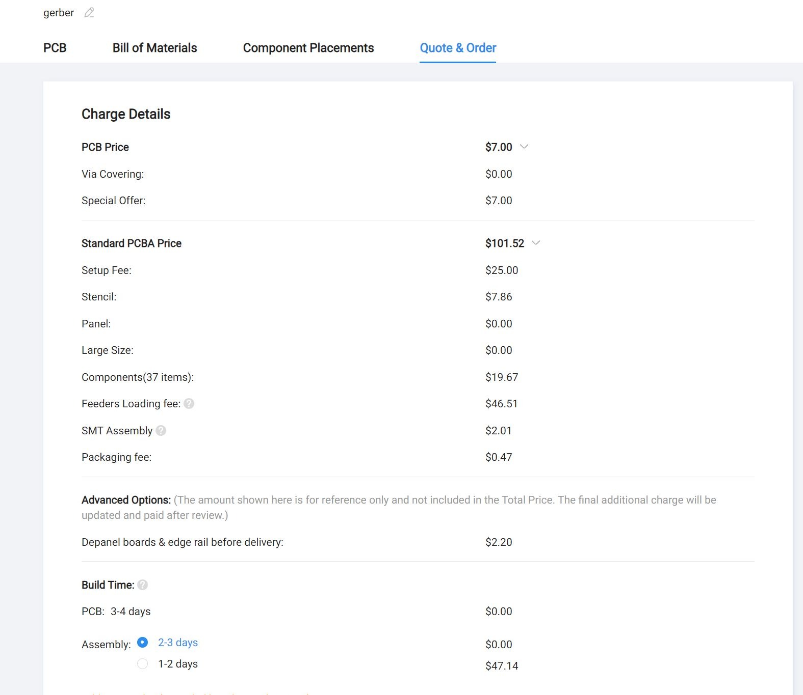

If I'm not mistaken, there are yet new fees on JLCPCB:
4 layer 100x100mm is still 7 usd
But for PCBA they seem to keep adding fees:
New is a fee for boards smaller then 70x70mm for which extra material / rails are added, and you need to pay for haveing these removed
Now all componets are added a fee for feeder loading. Before it was only for "extended components" 3 usd for each type, now it is 1.5 usd for al types ... this really adds up
SMT assembly cost extra
25 usd to start off on all PCBA
Separate cost for stensil
Last time I payed ca 56 usd, for almost the same PCB with 2 mounted boards including shipping and customs. They where a bit larger, at 70x70 mm. It was the same construction but with some mistakes.
Now it amounts to 108 usd before shipping and customs!
... and shipment up by some 40%
ca 3 months since my last order.
Think it is time to look for alternatives.

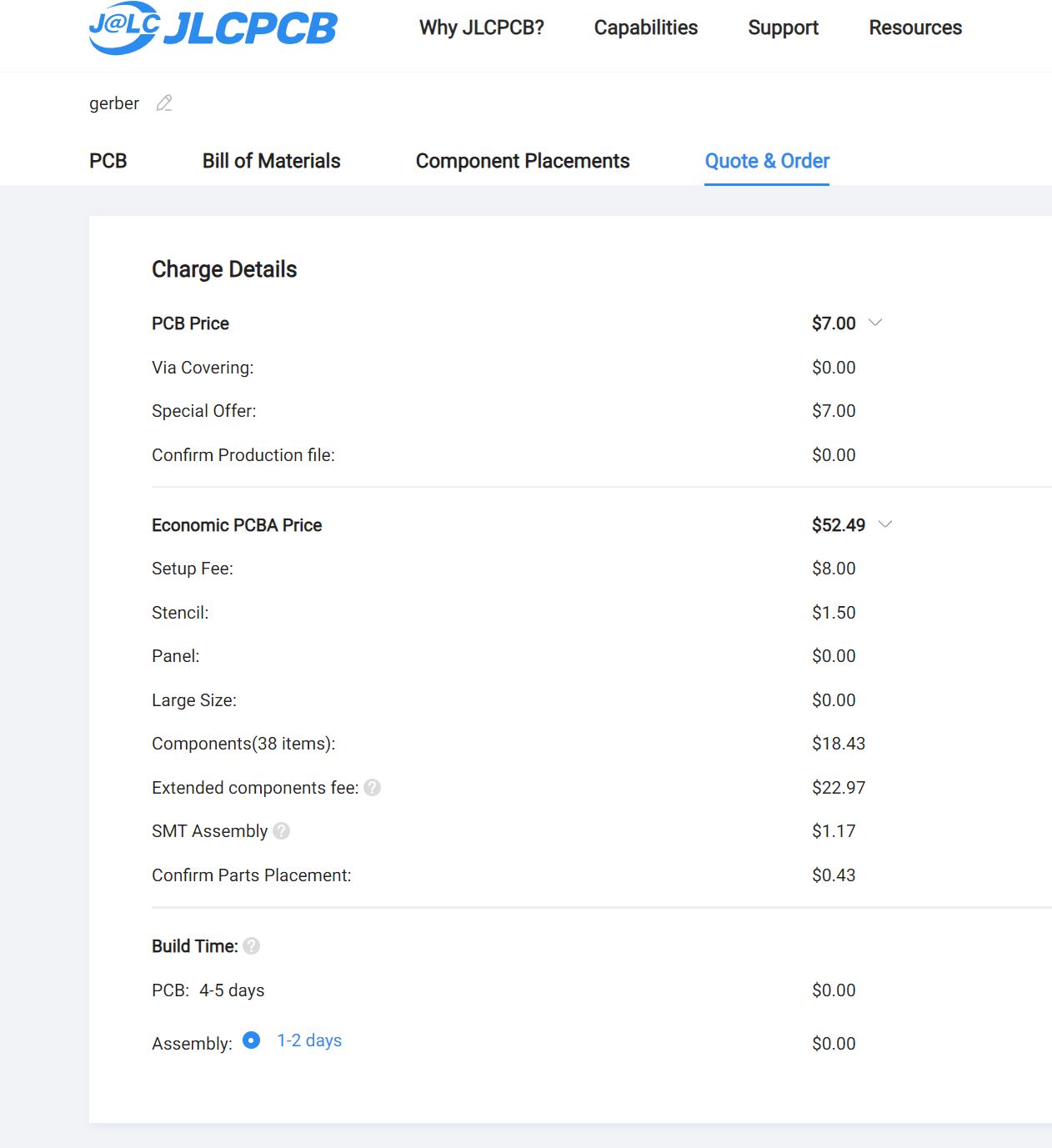

Ok I take it back ..... I must have made a mistake and Ended up with a "Standard PCBA" instead of "Economic PCBA" where the setup price is 25USD and not 8USD
SORRY JLCPCB
I think what might have happened is that I palyed with the color buttons to see what a different color to Green would be, and this has automatically changed the board from Economic to Standard ..... and when shifting back to green it does not change the overall category automatically ...
Now it looks more like it ...
We are back in business

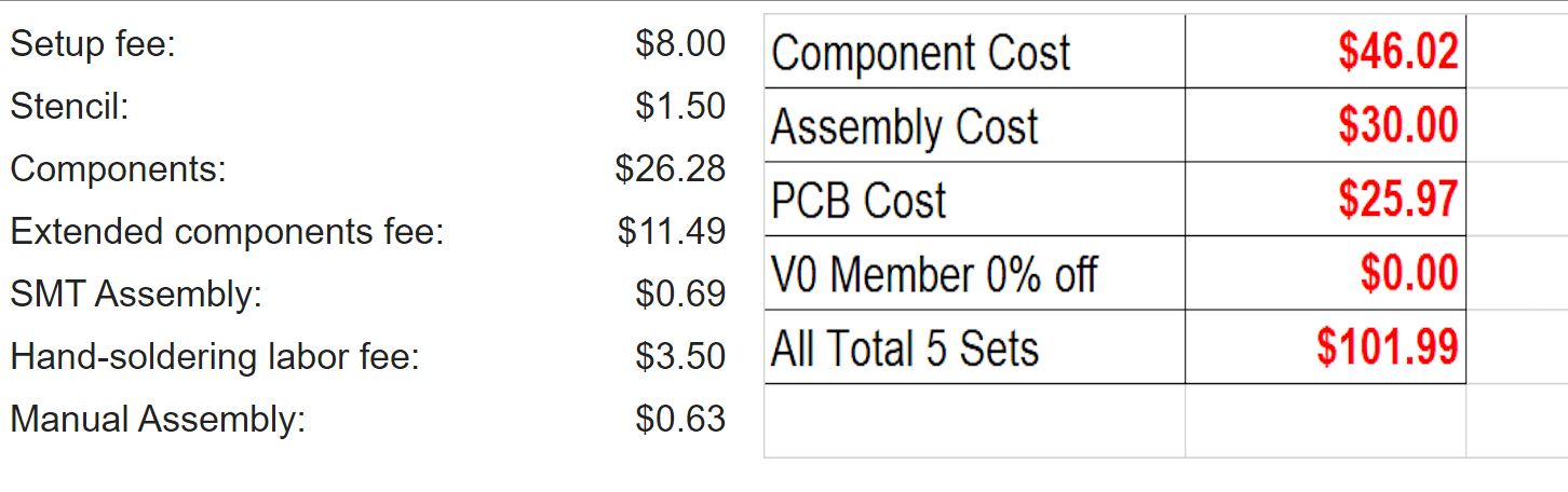

After I ordered a board with JLCPB ( 100x70 4 layers) that was 59.60 usd, not included shipping ( total order was 105), I quoted the same board with the same components of JLCPCB, and price doubled. I do not know if the PCBs from PCB way compare to the standard or to the advanced in JLCPCB. Left JLCPCB , it took one week from order to deliver, and right the quote from PCBway "The lead time of the Assembly will be about 28-35 days. (Long lead time mainly because of the long components sourcing time, assembly is under the premise of getting all the components, even with the express assembly, it can only quicker 3-5days, pls note.)". This is a lm317/lm337 regulator, all component, no sophisticated or hard to get parts.
Hi, Baldin, yes that is correct. Actual order from jlcpcb without shipping, 59.60 on the left and quote from PCBWAY on the right. After selecting the cheapest shipping, applying a 9 usd coupon and paying Florida sales tax ( similar to vat) it totalled 107 usd.
I have asked PCBWAY about the shipping cost but I will not know the price until Lunar new year is over. In their web site they have some decent shipping with a good ratio between speed and cost (10 day tedjcdo cost) options such as Ali Express shipping and also very low cost boat shipping (30 days) for about 23 usd.
In JLCPCB the only shipping type available was courier 3-5 days for about 50-70 Usd per 1kg. The cheapest shipping was as much as the boards(52 shipping for 57 boards).I run an estimate for 20 boards and the shipping was close to 100 usd.
Both orders use the same exactly BOM with lscs/jlcpcb component numbers.

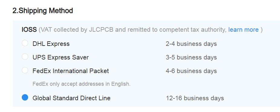

When I order I get an option to use Global Direct Standard Line for shipping, which of course takes longer than e.g. DHL, but I'd rather save a bit ... for EU there is addition of VAT/Tax, which is of course as it should be.
There used to be some shipping services around half the price, but also double the time (China Postal Service or something).
