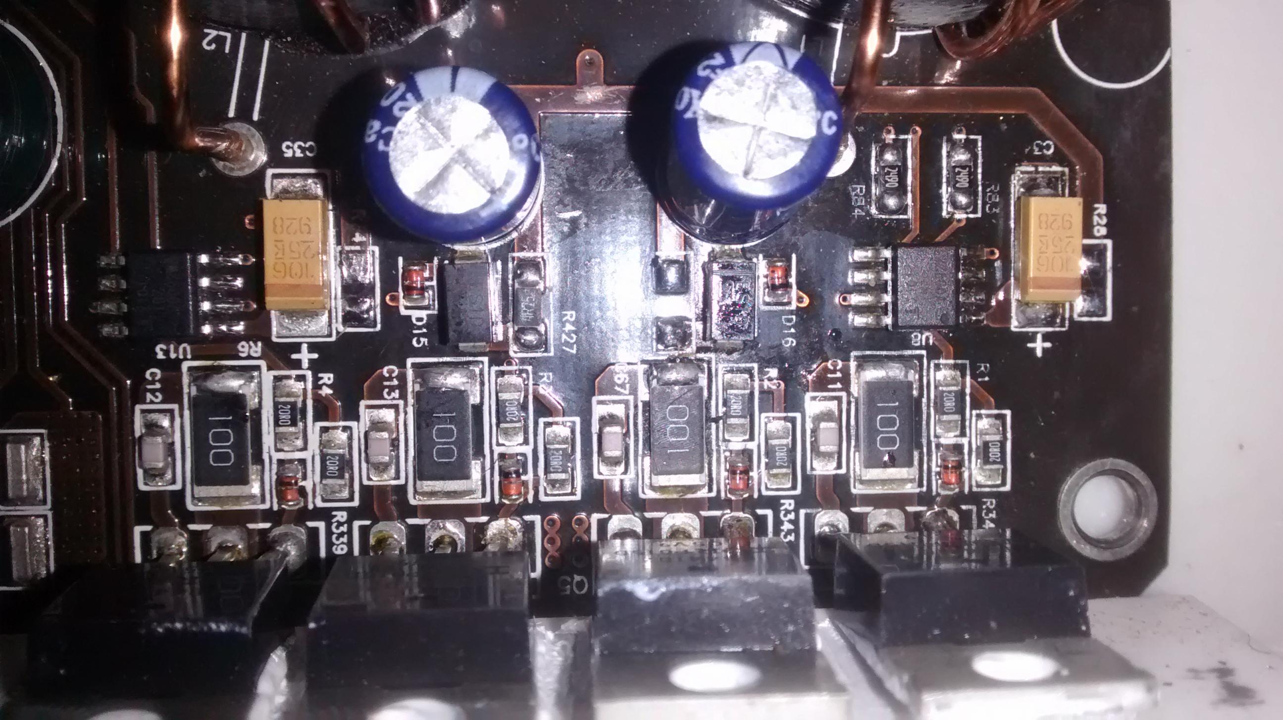

Today comes to me a jl xd600/1v2 amplifier, it power up but with no sound, it has reworked the amplifier zone, so it has some missing parts!
So if someone have this info i will appreciate.

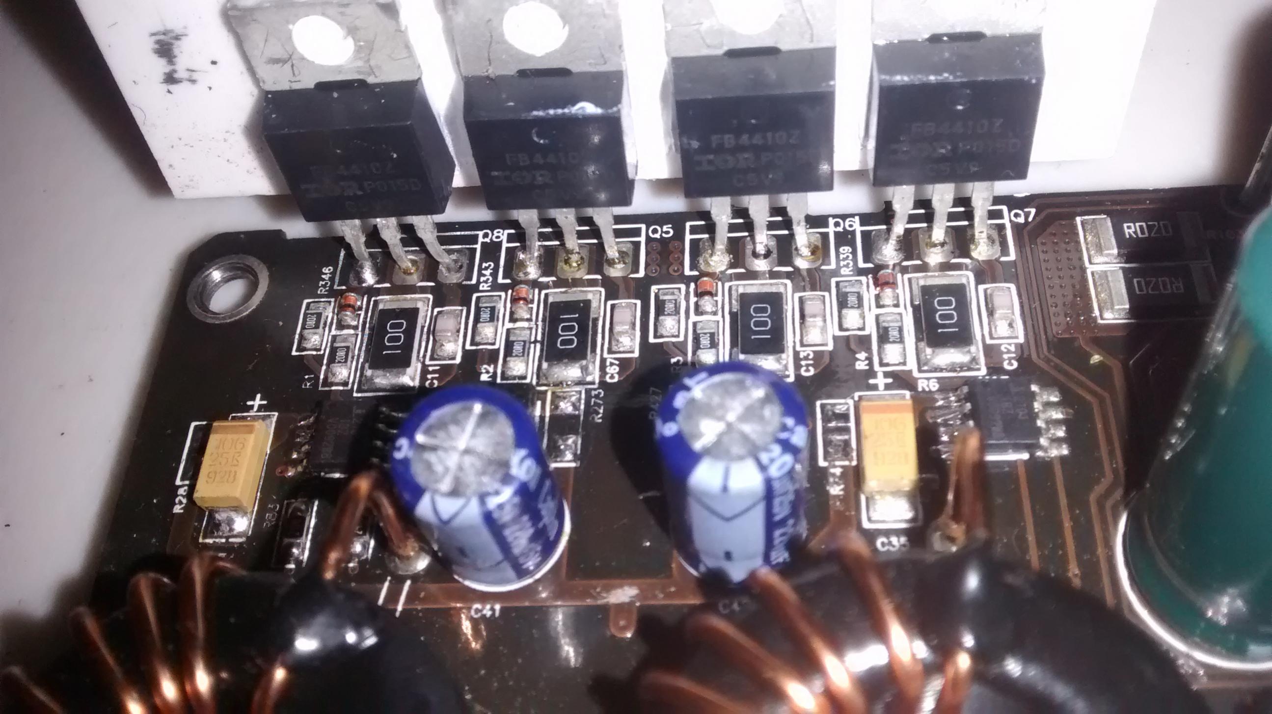

Anyone have this info?? R273 is missing, R427 had 4R75 but i dont know if is it correct because is resolded. R83 and R84 had 2490 but is resolded too. R28 is missing but maybe come original empty .
IMHO the circuit is symmetrical, and R273 = R427.
What about the resistors next to those tantalums (C34/35), R*4 looks like it's been removed but the other one (R28) may never have been installed?
That's some pretty darn lousy-looking solder joints on those MOSFETs, btw. Are they OK?

Hi¡ Thanks for answering so fast!!
The amp turns on, green light ok, no protect, the power supply is working. It does not have output.
Yes, is simetrical but i dont know if the other resistor (427, 4R75) have the correct value, i dont know if it is original.
R28 looks like it never had a resistor, but R24 or R74 (the pcb is scratched) is resolder, but it doesn't have a resistor on it.
R83, R84 are reworked, 2490 resistor, i dont know if its the correct value.

Hi!!
I put the resistor to test it and surprise the mosfet drivers are shortcircuit.

Hi, i solder the new 2101 MOSFET drivers, the output transistors are OK so i soldered again. I have a humming sound at the output, no músic or clear sound.
Im thinking the missing resistors are wrong, i put 10k Ohm , so maybe are to high, because they go to the vcc pin of the drivers. Anyone have the correct value for it??
Hi! I try with 1k ohm for the vcc mosfet driver resistor, now the noise is a higher frequency but now i have sound! i try with a 100hz tone and a song, its there but mixed with the noise and distorted.
I will try a lower value, maybe the mosfet driver need more current, but if someone had this info, i will apreciate.
