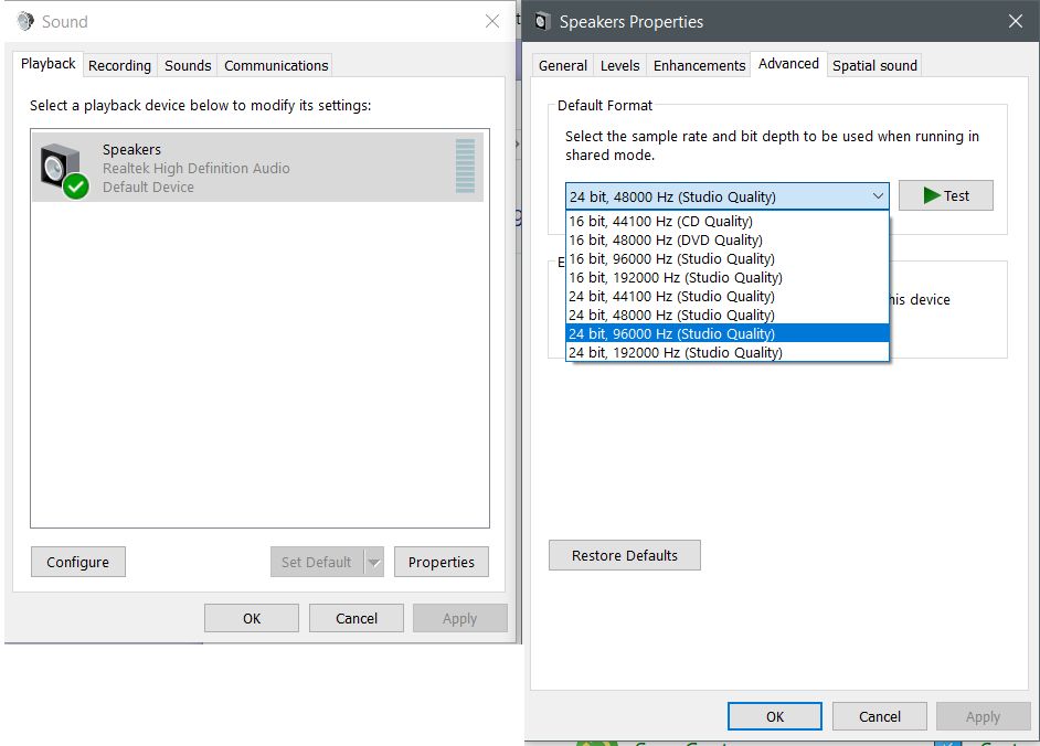

Yes. Please see the screenshot attached below. By default Windows will play all audio at the selected default sample rate. To bypass that requires the use of either 'ASIO' or 'WASAPI Exclusive Mode' drivers. In addition the playback app must support use of those drivers and modes.
Also in the image below it can be see there is a green circle with a checkmark in it. That indicates that the sound device is assigned as 'Default Sound Device' and or 'Default Communication Device.' IME that's not ideal if using ASIO drivers since Windows can still mess with sound quality of PCM streams. What I do is attach a second sound device to the PC that I won't be using for playback. I assign it as both 'Default' devices so Windows can mess with its PCM instead of mine. Unfortunately, Windows has a bad habit of reassigning the defaults after some Windows updates. Therefore probably better to use WASAPI Exclusive Mode along with playback apps that can support that protocol. In addition, Exclusive Mode must be configured as allowed in the sound device settings.
