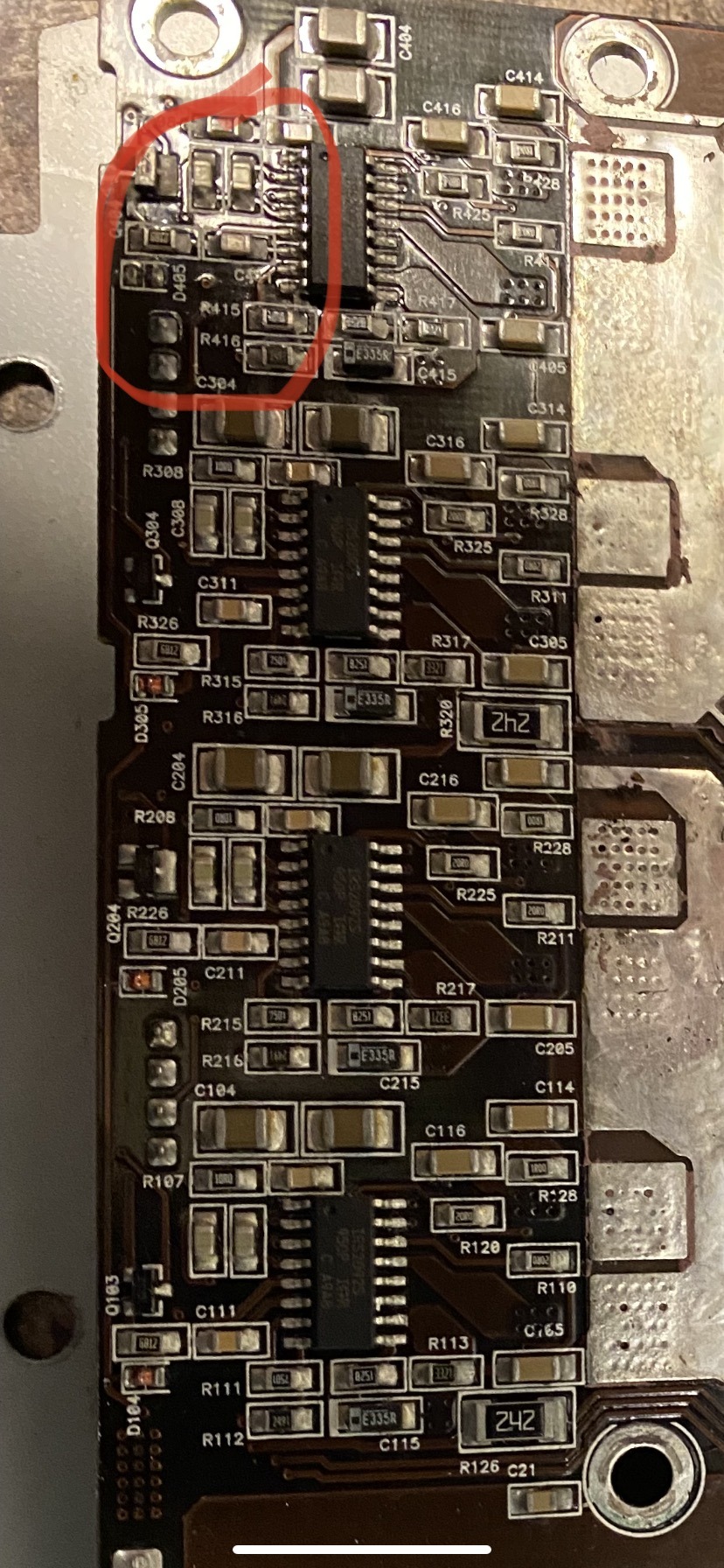

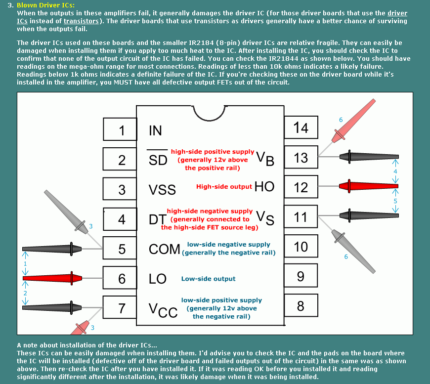

C caraudioguy2100 Member Joined 2010 2022-06-01 6:24 am #21 2022-06-01 6:24 am #21 Sorry 1 defective ic From the VS pin to the LO pin i get 2.32 ohms P Perry Babin Member Joined 2003 bcae1.com 2022-06-01 6:32 am #22 2022-06-01 6:32 am #22 I don't have a source. Prev 1 2 First Prev 2 of 2 Go to page Go You must log in or register to reply here.
