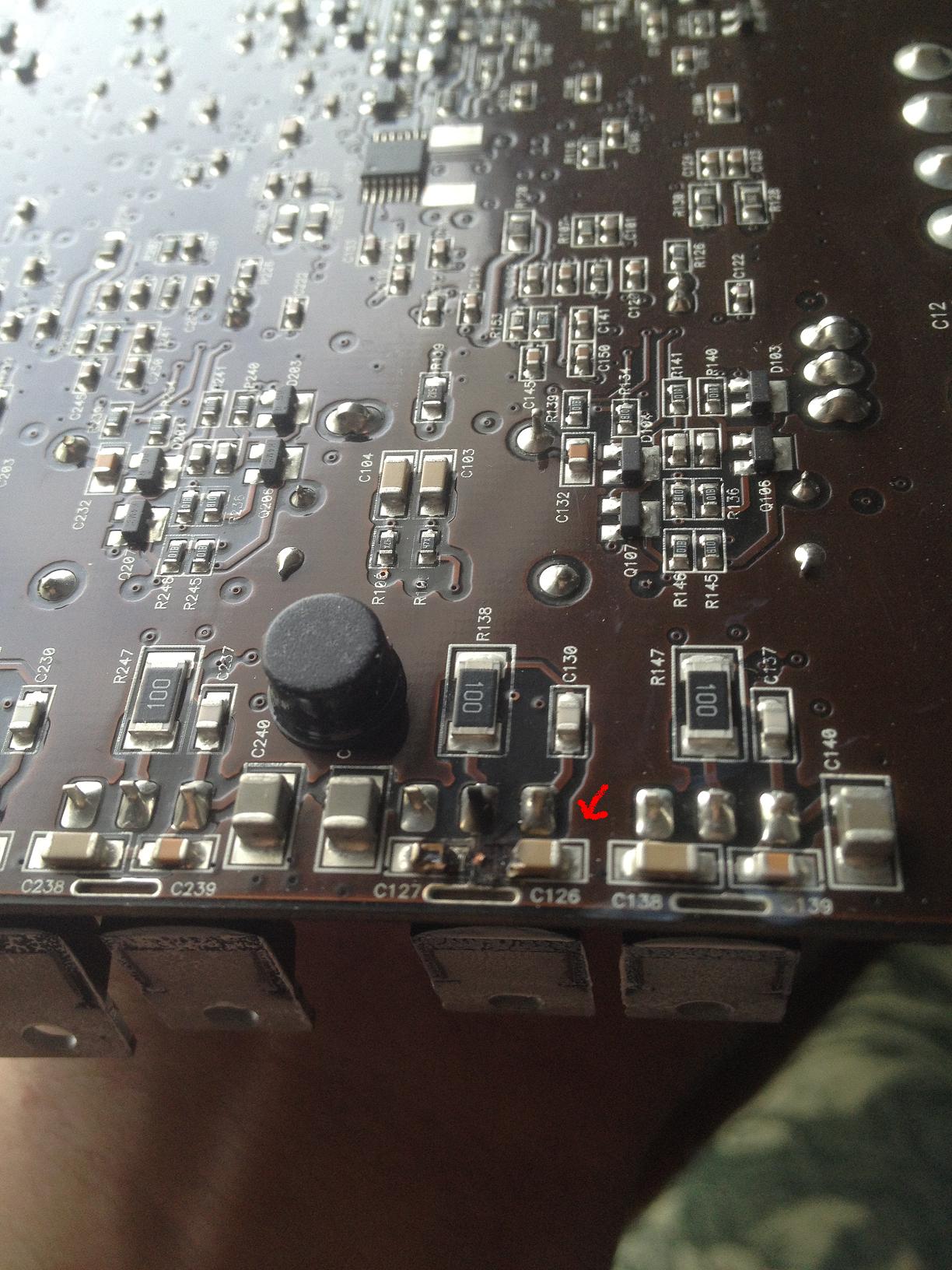

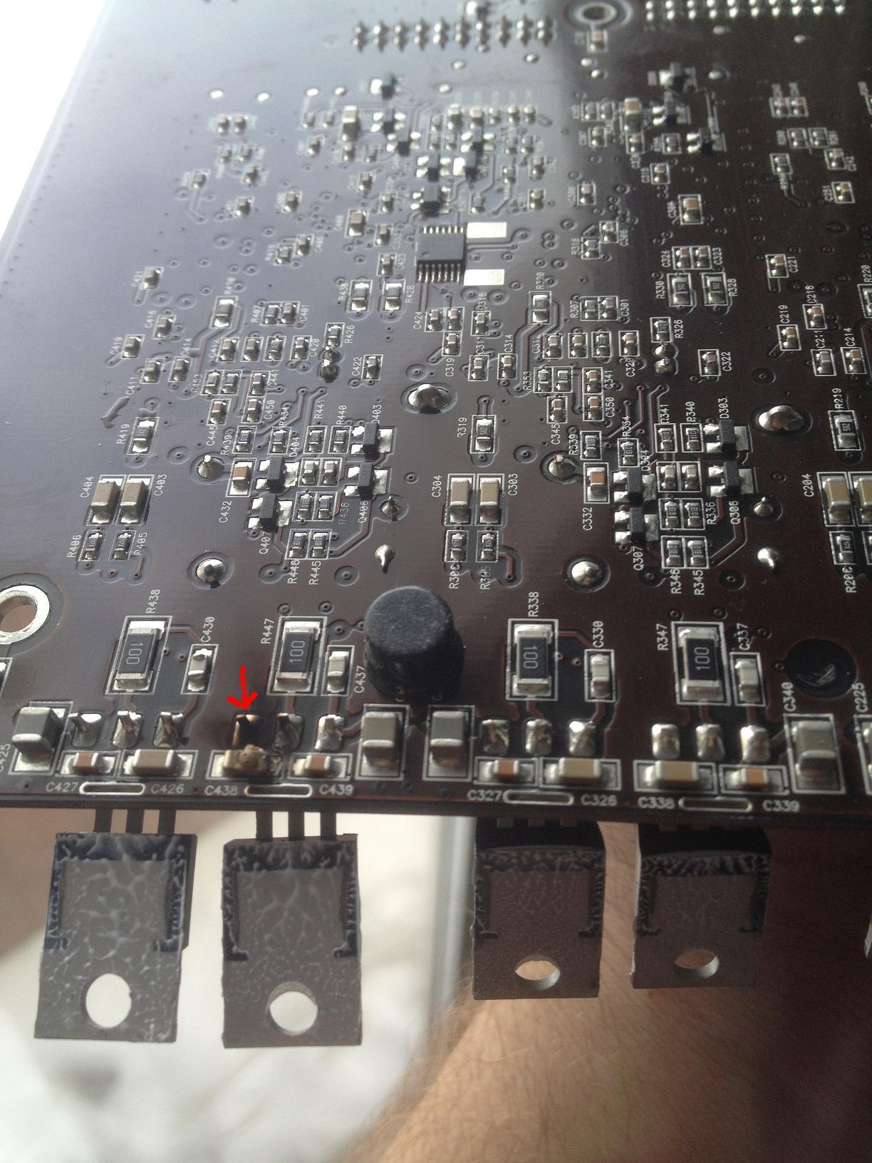

JL Audio HD 600/4
This amp uses FDP2572'S as the outputs..
There are 2 SMD caps per output..
Anyone happen to know the value of theese??
Replaced the caps and outputs..
Amps Power led still blinks green/red like amp is still in protection mode..
The manual says that thats caused from low voltage ..
I have 13.90 volts running to the amp and it never drops amp is still in protection mode..
Any ideas on where to go from here?
The gate voltage as read with a multimeter isn't very reliable, especially for a regulated power supply. If the power supply is a standard push-pull and the drain voltage is swinging from ground to about 2x B+, the supply is likely working normally. You should also have rail voltage if the rectifiers are in the circuit.
