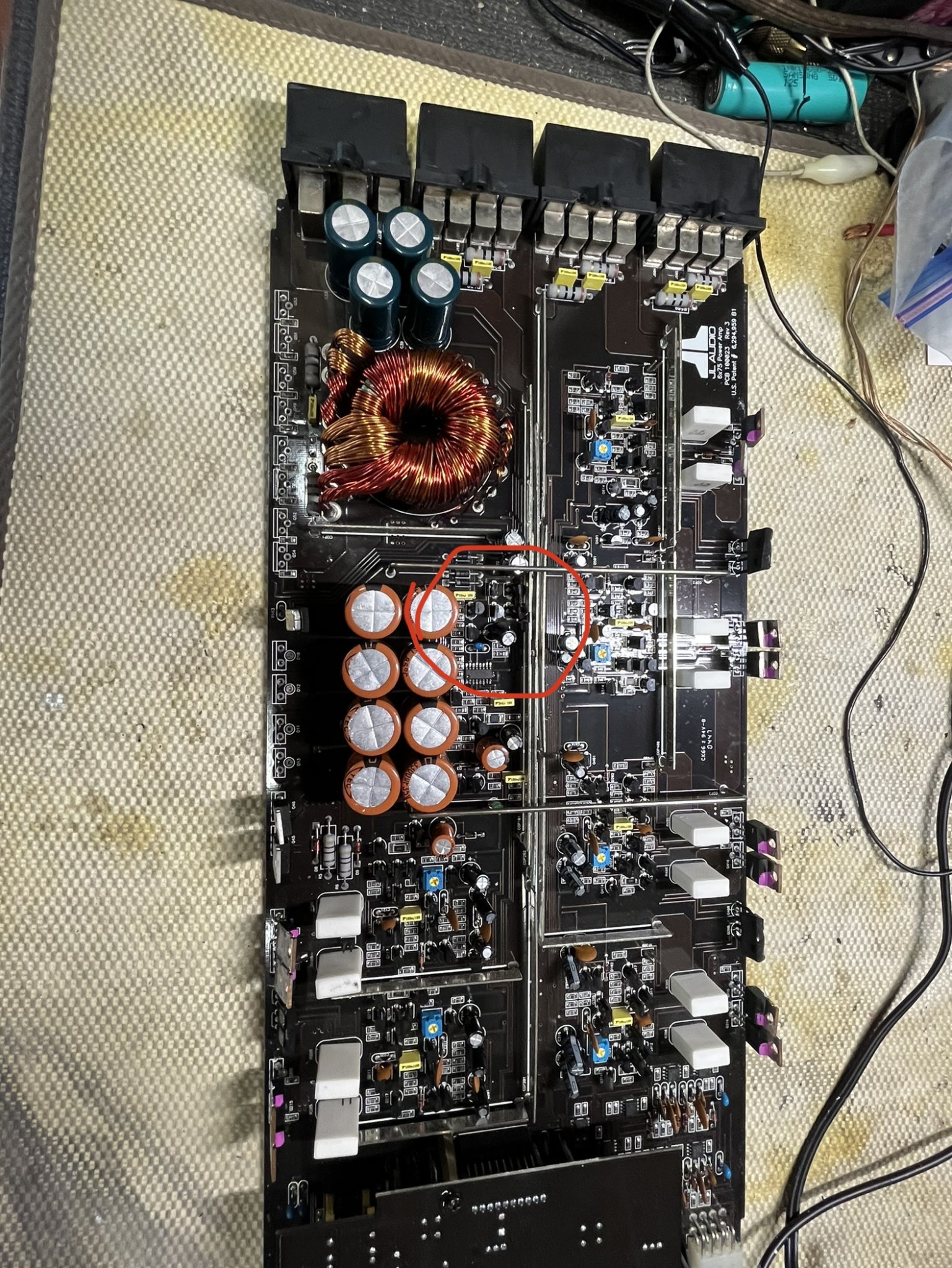

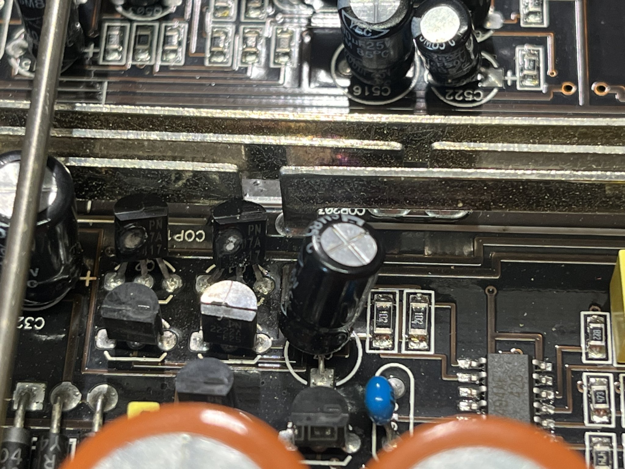

C cmrvi1 Member Joined 2014 2023-07-08 9:11 pm #1 2023-07-08 9:11 pm #1 Hello guys, working on an E6450 with burnt P/S FETs. Found transistors Q1 and Q2 in the driver circuit are blown. The part number starts with PN, but can’t make out the complete part number. Anyone knows the correct part number? Thanks Attachments 406352C3-F68D-45C1-A4ED-F77E81970552.jpeg 722.2 KB · Views: 90 1BFBA1FA-6CBB-459E-89D9-C5871AC7F57C.jpeg 520.8 KB · Views: 88 P Perry Babin Member Joined 2003 bcae1.com 2023-07-08 9:44 pm #2 2023-07-08 9:44 pm #2 PN2907A C cmrvi1 Member Joined 2014 2023-07-08 10:08 pm #3 2023-07-08 10:08 pm #3 Thank you! 🙂 You must log in or register to reply here. Share: Facebook X (Twitter) LinkedIn Reddit Pinterest Tumblr WhatsApp Email Link
