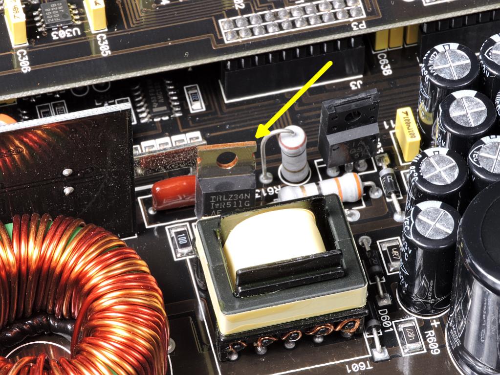

And Perry, you are correct. I was talking about the attached photo for the the transistor that was running a bit warmer than I expected it to be when I was feeling for anything getting hot while the amp was powered up for about an hour.

I'm thinking something is wrong with the small yellow transformer or the driver for it. For kicks I measured some dc voltages from it and the one from the good amp while powered up. The center pin towards the heat sink on the working amp shows a 9.62 volt dc reading while the same pin on the non working amp shows 0. The rest of the pins are similar as far a dc readings go.
