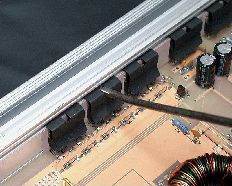

Jl audio 500/1 Transistor clamps
🙂 🙂 🙂 I use a beater pair of needle nose pliers to pull them off by inserting one plier tip inside the clamp < middle hole> and them clamping the plier and pulling straight away from the sink surface.
This causes the loaded section of the spring clip to flex and release. I figured this out by mangling a few till it dawned on me that I was going about it the wrong way:whazzat: :whazzat: :whazzat: .
I finger load them back in and using a beater 4 MM hand tool I gently tap the clip right back into its position, by tapping gently at a 45 degree angle to the fold over or the outside bend.
This works for me, I do NO damage, and its all over and done in a matter of moments.
I am sure there is a real tool for this somewhere out there in the real world, but I have yet to find it in any of the tool suppliers catalogs.:smash:
If you ever find this tool please let me know....🙂 I am sure its instructions are either Korean or Chinese lol lol lol

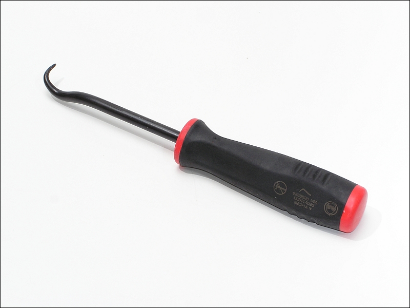

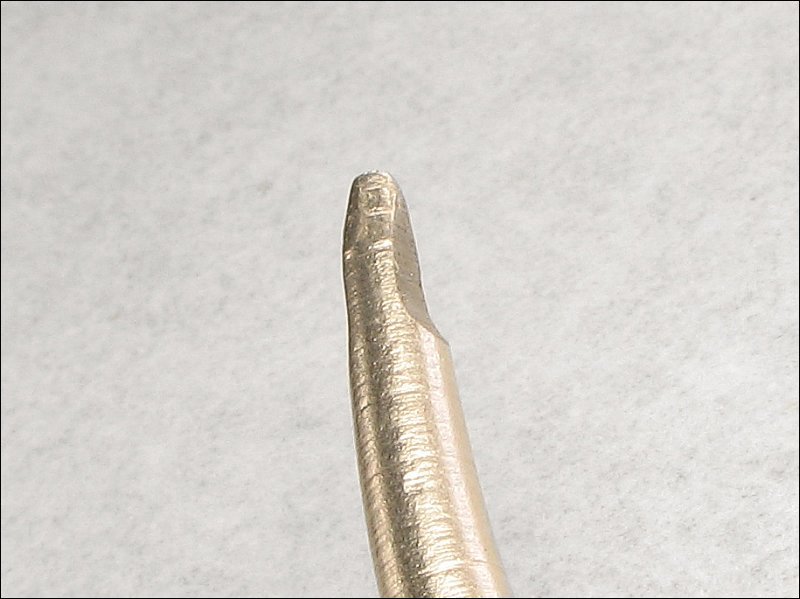

To remove the clamps, it's easy if you make one of the tools below. The first is simply a bent screwdriver ground to fit the slot. The second image is a cotter key remover (recommended by a friend). The third photo shows how he ground it to make it more user friendly. The last photo shows the 'tool' I use to replace the clamps. The rubber insert (insulation off of a piece of wire) helps to keep it from sliding. Use this with a small hammer (or pair of crimping pliers as a hammer) to gently tap the clamps back into place.
Using the tools shown in the post for the JL amp, they clips generally pop off effortlessly. The only time that there is a problem is when the groove in the heatsink isn't properly designed for the clips and the manufacturer has to drive them in too deeply to make them hold properly.
