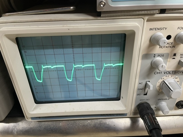

LM555 at U4 on the daughter board? No signal on pin 6. Rises from 1vDC to 2.4vDC after a few seconds - solid DC. Everything is in reference to B- ground/black. Tagging remote briefly.

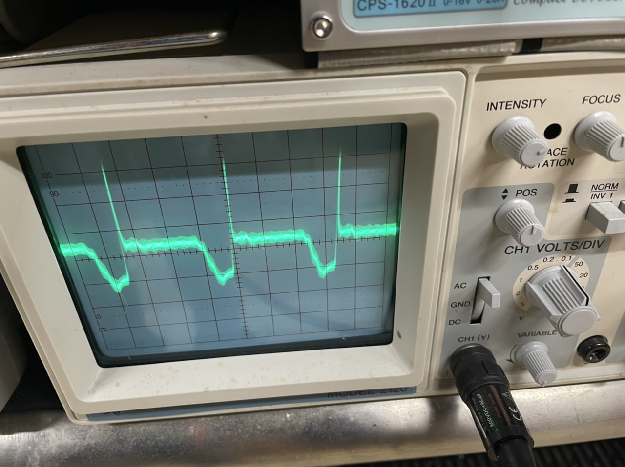

I don't have waveforms on those points but I'd expect them to be almost perfectly square.
You need to switch to DC coupling. The switching of the gates depends on the voltage applied referenced to ground. I should have noticed this when you first started posting. It's virtually never necessary to take your scope off of DC coupling, especially if you have it set up for differential measurements.

Then there may be a problem with reference voltage to ground in the circuit. I've taken all measurements referencing amp B-.
When I set the scope to DC coupling (99% of the time I keep it there for all repairs) the line jumps outside visible range. If I set the V/Div higher it comes back but then the waveform is too small to see and the trace is showing significant positive voltage.
Theres 4vDC on pins 3 & 8 of the 74hc132 next to the 2201 resistors. Is there a grounding problem going on here? Where is secondary ground for the regulated supply?

I don't know what your scope is reading because I don't know if your probe is set to 1x or 10x.
What voltage do you read on the ground pin (7) of the 132s?
What's the voltage across pins 7 and 14?

Scope probe has been at 1x. Sorry about the AC vs DC coupling
Actually I think 132s are grounded properly.
132s ground (7) have 0ohms to B-. 0vDC on them.
Across pin 7 & 14 I'm reading 4vDC.

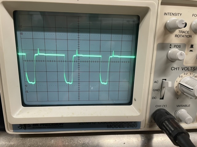

I pulled both 74VHC132 and both are measuring pretty close to shorted across pins 9 thru 14 off the pcb. I also pulled both 74VHC112 and I think those are actually OK.
With 132s removed, powered the regulated side up and I now have good 4.9vDC on pad 14, and also pin 12 of the LM319 is pushing out a perfect square wave.
Time to order 132s, IRF3710Z, and a few other things. Thank you
