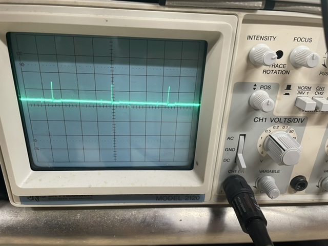

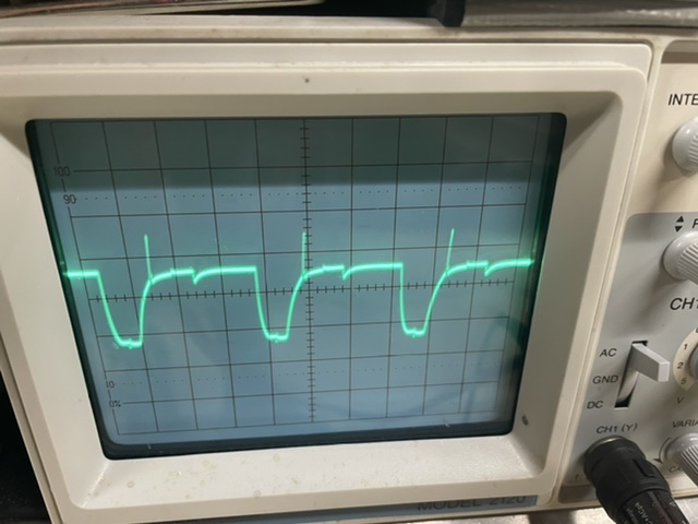

I've got the output fets removed and the low side jumped S to D as well as pin1&2 of the opamp. Gate drive signal is very bad on the high side fets. Looks like a short, mangled saw tooth not like any of the CD images. There is no drive signal on the low side fet pads at all.
Tomorrow I'll remove the MIC4427 and measure on back, but it would appear poor drive signal is also around Q4, Q5, Q516, Q517. I believe those transistors are OK though.

74VHC132 vs 74VHC112 14 pin vs 16 pin SOIC. This amp uses BOTH in two different spots. I'm not getting any square waves at all on Q4, Q5, Q516, Q517. Some of these are connected to the MIC4427 inputs.

AC coupling .5vDiv 2uS
