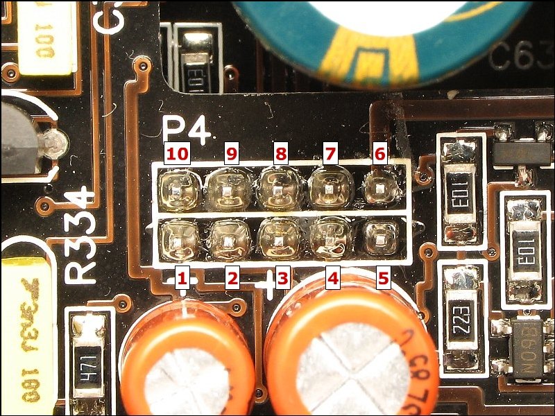

I have a JL Audio 500/1 Rev 3 that power light stays on. I have the signal sense switch off and the power light turns on with only positive and ground connected to the amp. It draws no current from my power supply and after I remove the positive from the amp it takes a few minutes for the power light to go off. The amp works fine besides this weird issue. I wondered if anybody has seen this before I spend hours tracing this down. It seems like its taking the b+ filter capacitors forever to discharge which is keeping the light on. But the power light shouldn't turn on with only positive and ground connected to the amp.
Does the voltage on pin 3 (referring to attached), go high/low precisely when remote is applied/removed?

It stays high until the remote voltage is removed. I unplugged the power from the amp and removed the top board from the bottom board just in case it wasn’t making a good contact and tried again and the voltage remains high but now the amp won’t power on at all.
