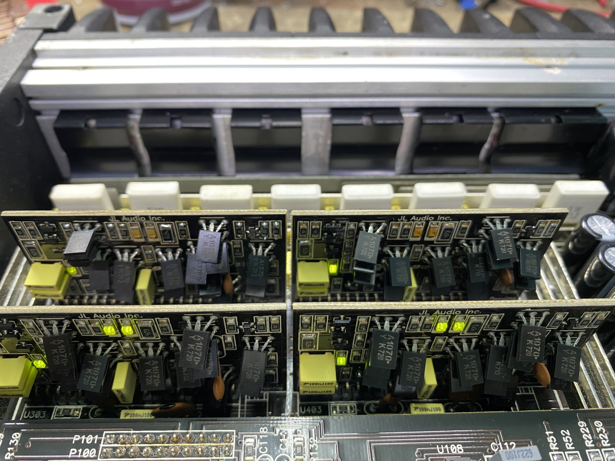

JL Audio 300/4
Amp had no output,Rail and Regulated voltages look ok.The two back driver boards have some LEDs that are not lit .
Any suggestions
No heating means that no current is flowing through it. The LEDs don't seem to have significant voltage across them so they don't seem open. The other LED is lit so it appears that the two 10 ohm resistors near the header are OK. I'm just looking for something that would point to the reason that the resistors are not passing current.
