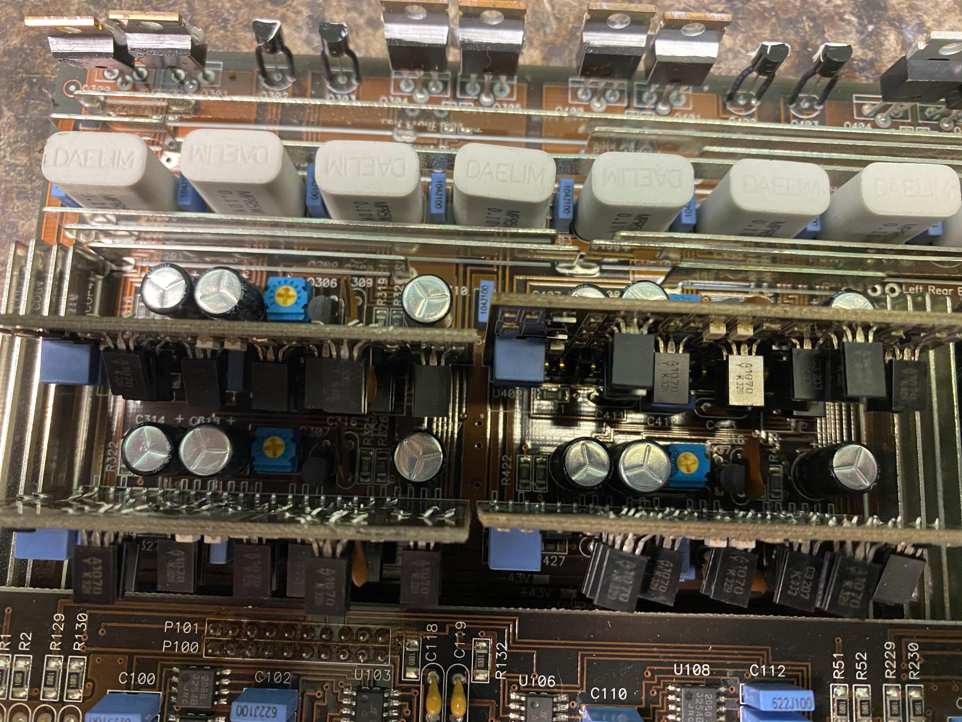

Ok I replaced the outputs in 1 channel since they were defective .
The amps low ohm light is still on and the channel will not bias and the amp draws 20 amps of current
Do all of the LEDs light up on the driver boards if you apply remote for a couple of seconds then remove it?
All of the leds light up on the audio driver board .
I resoldered all of the connections on it and still have an issue .
The outputs get to hot to touch within 3 secs of powering up .
Any common problems besides the solder connections on the audio board. ?
I used IRF540 just like all the other channels .
This is the channel that has has issues since I received the amp .
If you clamp the outputs to the heatsink, will the channel produce the same output (clip symmetrically at the rails) as the other channels? No load.
I’m gonna have to remove the outputs out of all channels since now the low ohm led is lit and no channels will bias
Something is still wrong with the driverboard or on the main board if I put that driverboard in the amp the low ohm light comes on
