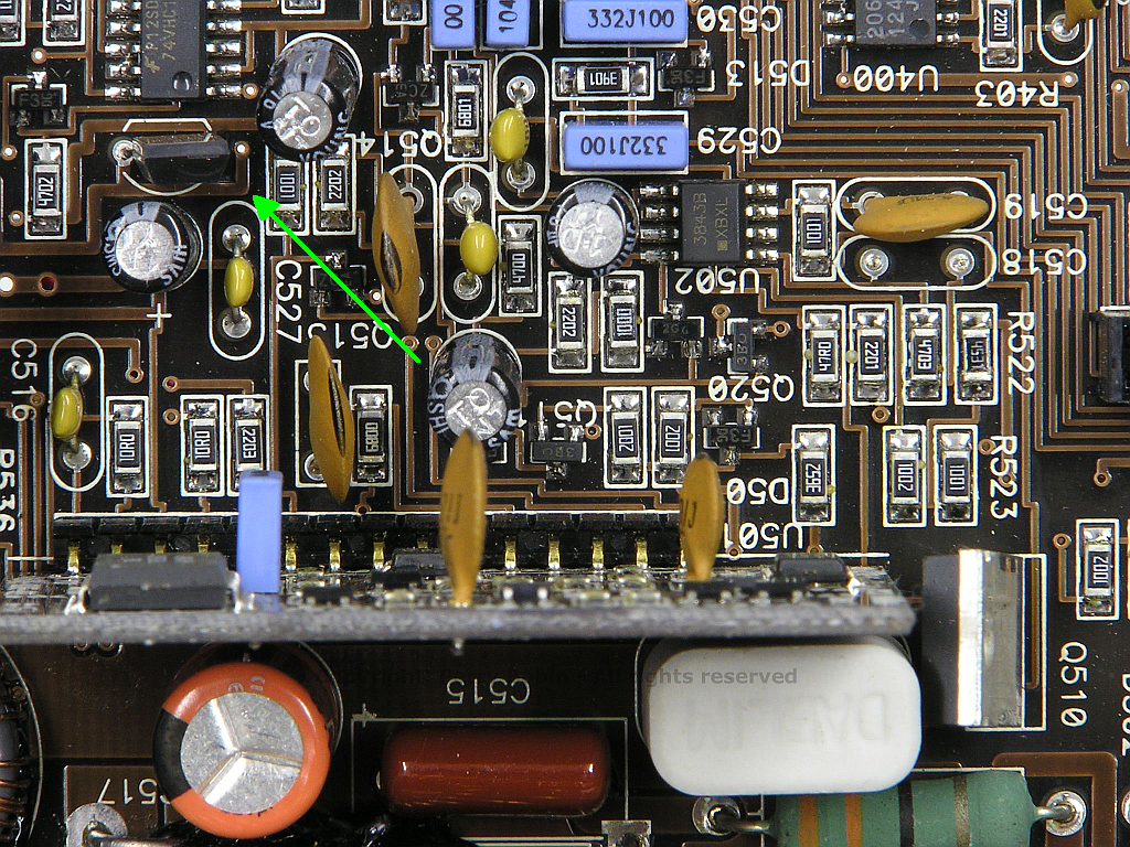

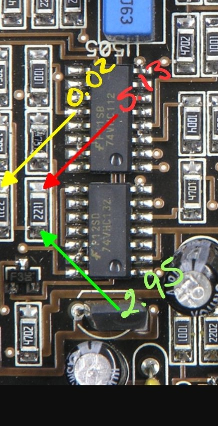

It appears that the rail supply is working normally. I'm not sure that the 2.94 is right but the circuit is producing rail voltage and regulating it.
What's the DCV on the PS terminals of the various op-amps on the preamp board?
What's the DCV on the output of the 5v regulator?

I think I missed your posting of the 234 voltages. are you sure that pin 7 was 0.0v?
Are the voltages the same (± 2 or 3%) of the voltages you posted?
If the amp starts to produce audio again, recheck the voltages on pins 5, 6 and 7 of the LM324.

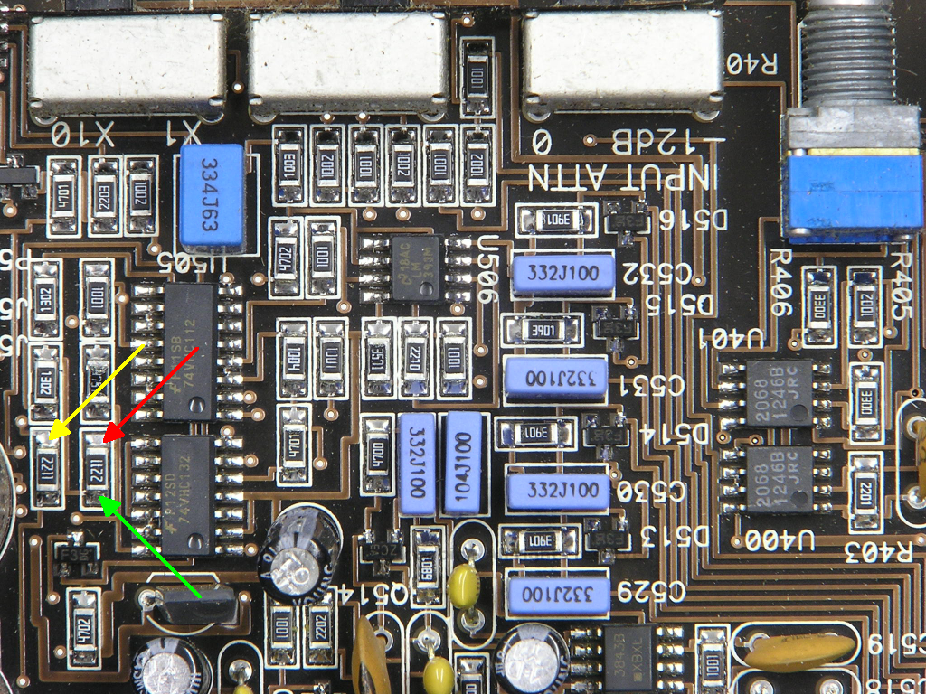

Ok, I've turned it off and on again. I see that the values of pins 5,6 and 7 have changed. More than anything, pin 7 doesn't maintain the 12.18v as you show in the tutorial. Where do those 12.18v come from?
This is a standard op-amp. The IC could be intermittent. When pin 5 is higher than pin 6, pin 7 should go high unless it's shorted to ground. When pin 7 goes to 0v, measure the resistance from pin 11 to pin 7. Red on pin 7. Do the same on diode-check. Does it ever read 0 ohms 0r 0v (diode-check)?
