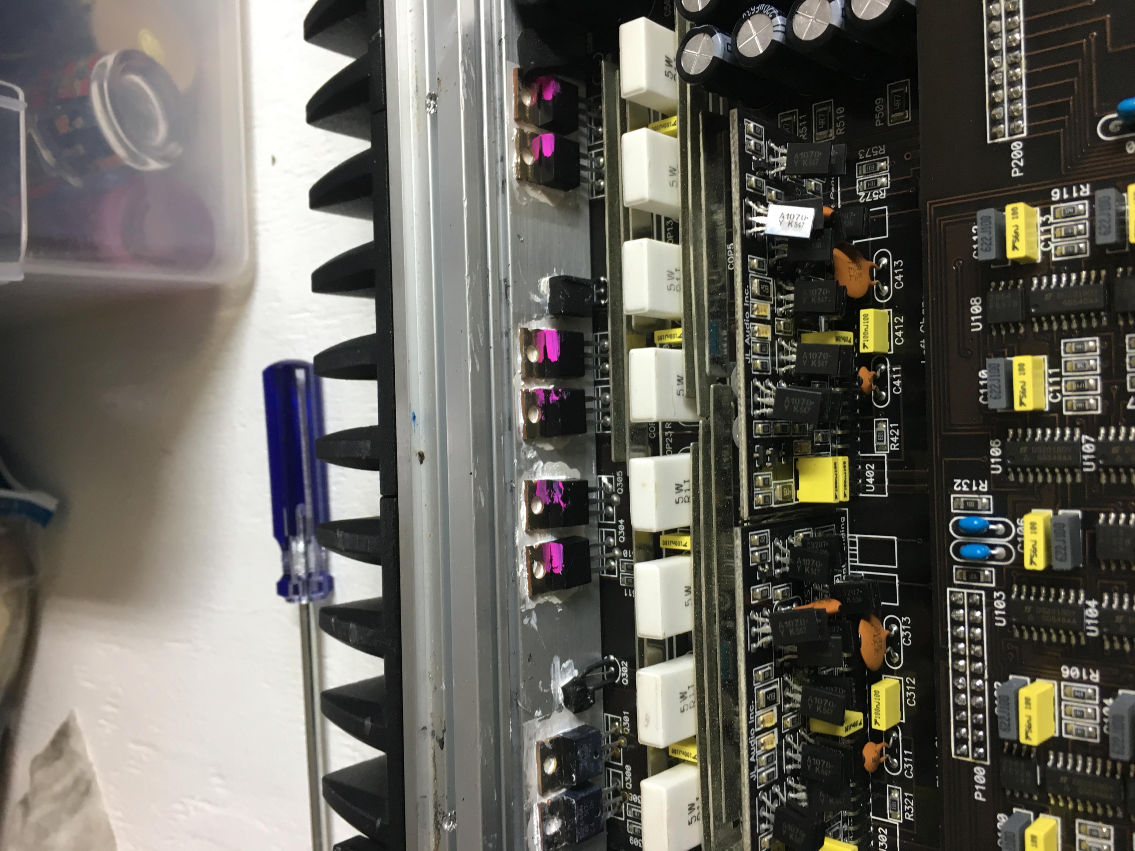

So purchased a used JL Audio 300/2 locally and was told it worked. Well it didn't. I opened it up and could clearly see that it had been worked on. The transistors on the heat sink were all missing their clips and were not even touching the heat sink. They were also missing the mica insulating strips that go between them and the heat sink. So what I did was I marked where the mounting holes for the mounting screws for the transistors on the heat sink and drilled holes. I then bought some mica strips and nylon screws and reapplied thermal paste and screwed them to the heat sink. Using a PC power supply I powered it on and it came on breifly then low ohm lite lit and PC power supply shut off. I had a speaker connected to it bridged and the music was distorted. So in my research it looks like it is possible bad transistors and is a common problem with these amps. Does this sound like it? Also I am having trouble finding a schematic with the circuit layout. All the threads I have seen are for either a 300/4 or 500/1. The transistors are the "IRF540". I have not had a chance to test yet, just running it by on here first to get an idea where to start at.

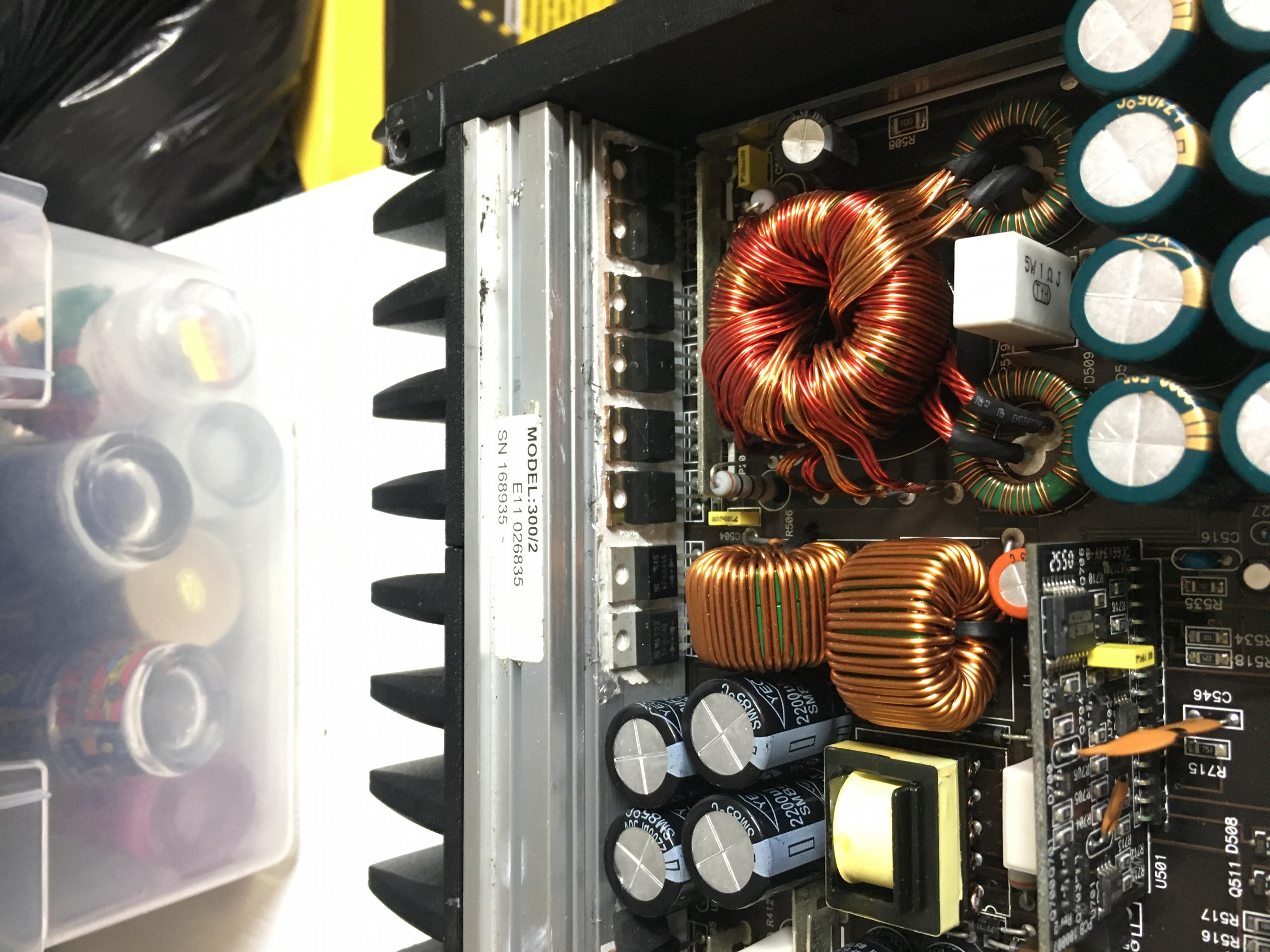

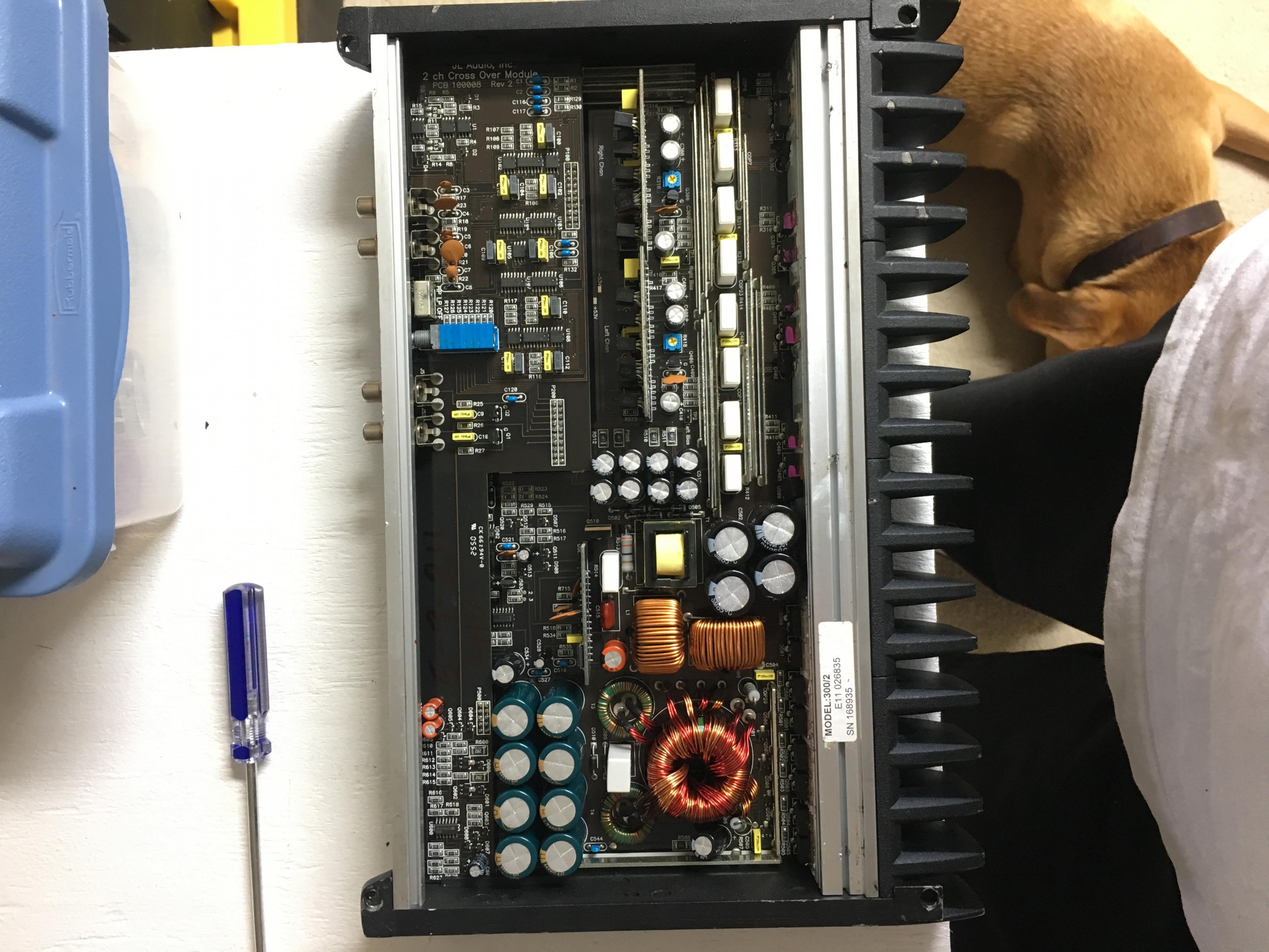

Thanks for the quick reply. I will take a look tomorrow when I have some time. Here is a pic of the internals. The first two transistors to the right looked like they may have been replaced. Where would a good source for heat sink clips be? I found these at digikey. Max Clip™ System Heat Sinks - Aavid Thermalloy | DigiKey

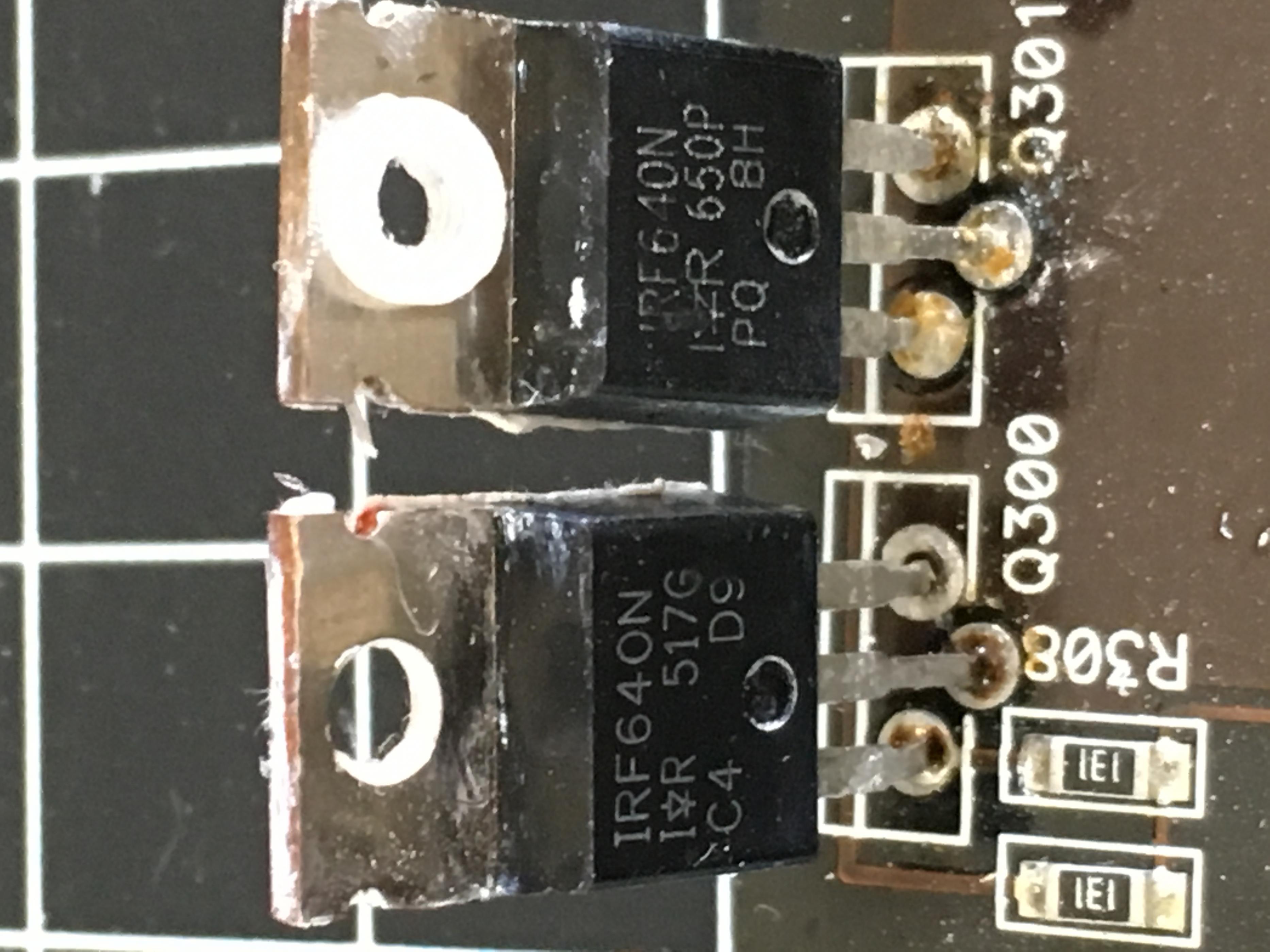

Ok measured the transistors Q300 & Q301 on the source and drain. They both measure 2.2 ohms. These are the first two on the board on left hand side. I am thinking these are bad? They also have two different part numbers.
Now re her when I bought the amp it was already taken apart inside missing the heat sink clips like someone attempted to repair it. Are these even the correct transistors for this location?
IRF540, not IRF640N
Wow so whoever attempted to fix this amp before did not even use the correct transistors?

I will order 2 x IRF540PBF

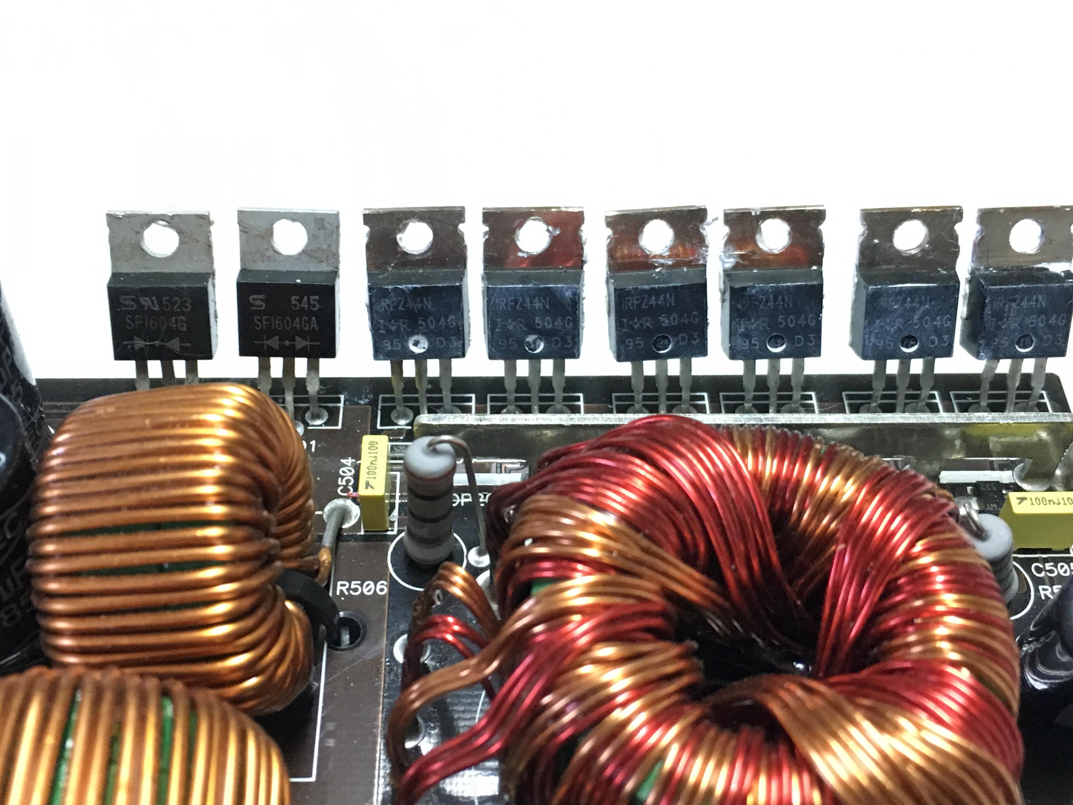

Checked the transistors on the power side. They read in the K ohm value but just continue to climb in value. I am at a loss. I am debating on just replacing all the transistors but don’t want to keep throwing money at this not knowing for sure what the issues could be. What I are the correct part numbers for the transistors on the power side? The ones on the board say “rfz44n 504g”
