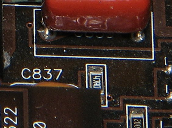

I confirmed i have 13 volts on bot battery and remoe terminals..
Still only 5 volts on Pins 13 and 15
The transformer that that transistor drives produces the ±15v supply voltages. Try to see if there is an obvious problem in that area.
Do you read 0 ohms (actually 0.1 ohms) between leg 3 of the transistor and ground (no power applied)?
