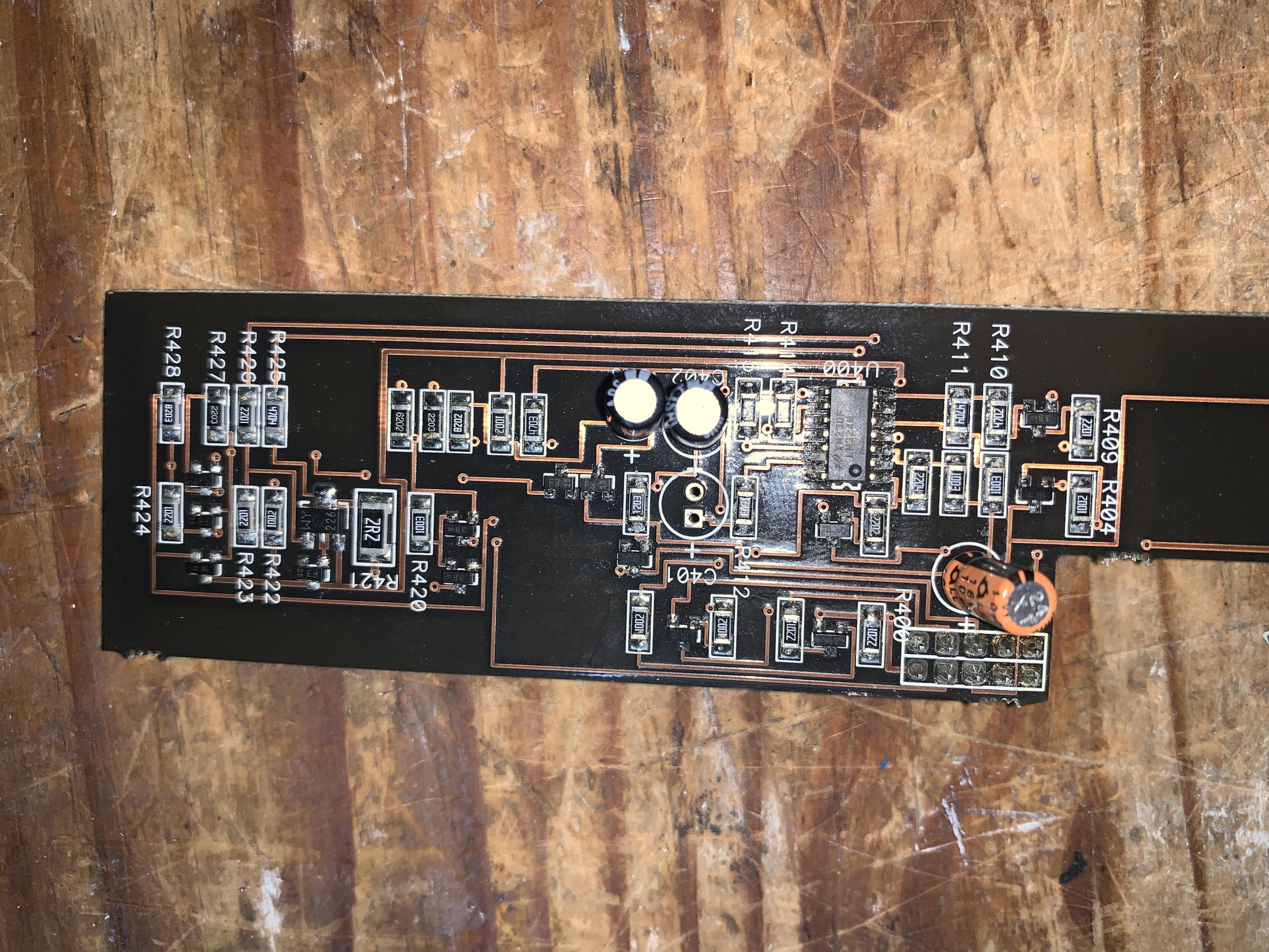

Hello
I am repairing a JL AUDIO 1000/1. I have noticed that the amp has a idle current, oscillate of 6 and 7 amps. When I disconnect remote, the amplifier does not turn off, it takes about 10-15 seconds to turn off and it makes a loud click on the speaker.
What could be happening? There is no short film anywhere.
Regards.

Removing the C401 circuit, the amp turns on and off normally, but I still have the 7 amp idle current problem. in addition to a strong "POP" when turning on the amplifier.

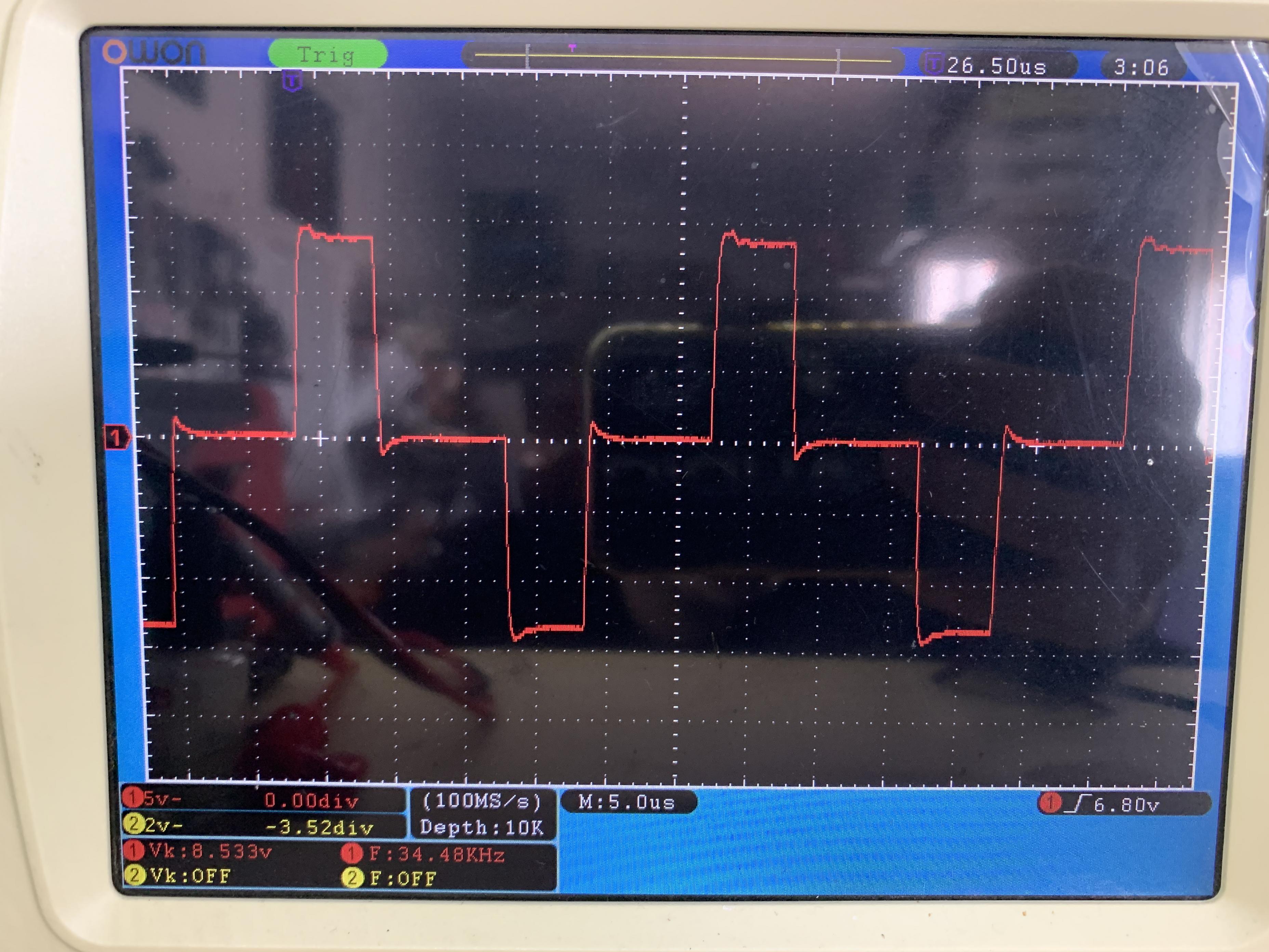

Is the power supply pulse so strange?

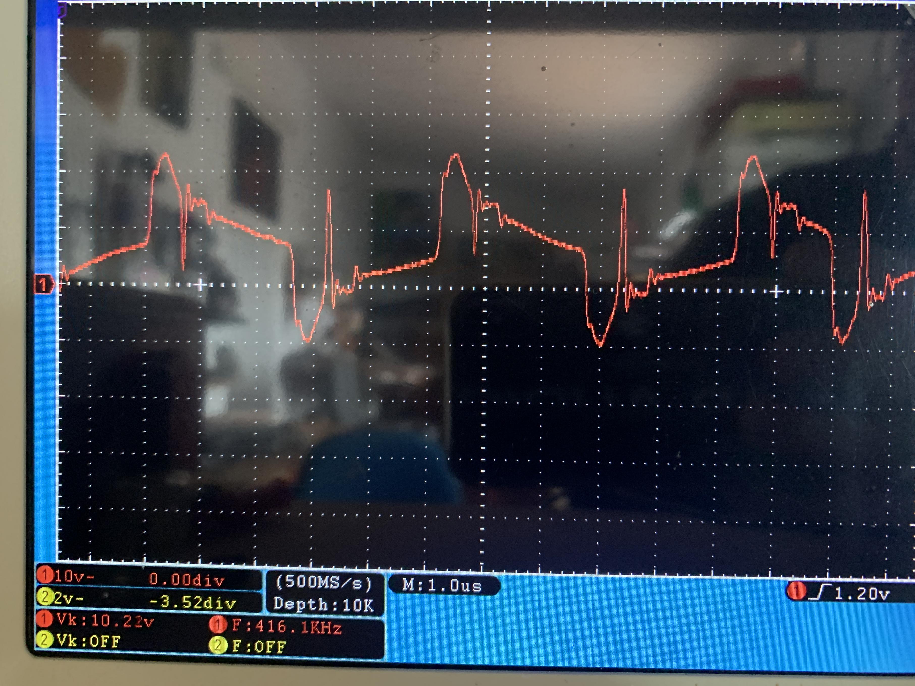

I get this waveform at the main source ... is it normal considering that it uses transformers to boost the pulse signal?

The waveform is OK.
The transformers are used because the FETs directly connected to 12v have to have a floating signal. In the attached datasheet, figure 13 shows half of the circuit. All of the circuit in the rectangle would be duplicated and the FETs in the duplicated circuit would be in place of C1 and C2.
