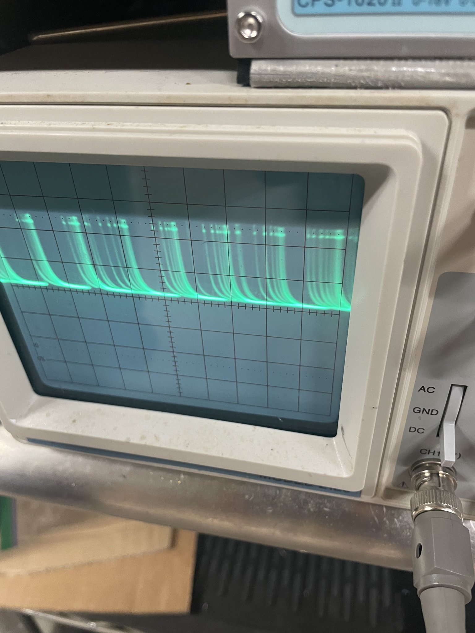

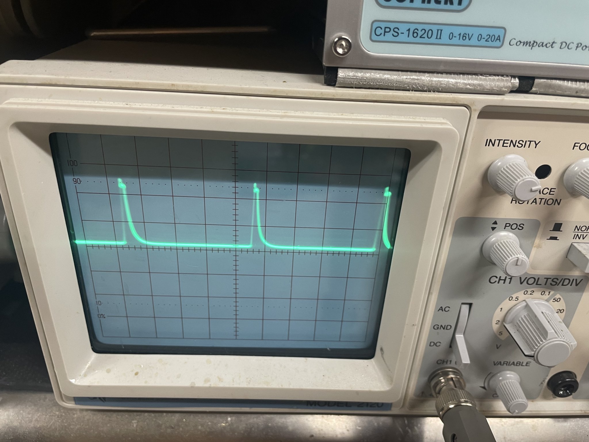

OSC images. First image is from the good ip3525, OSC. 2v/div both at 2uS. Honestly, the output of the 'bad' IP3525 looks very similar to OSC at fet gates. Signal on the GOOD IP3525 output is perfectly square.
I think I figured out that my scope wasn't locking on correctly; although there are still issues with this amp.

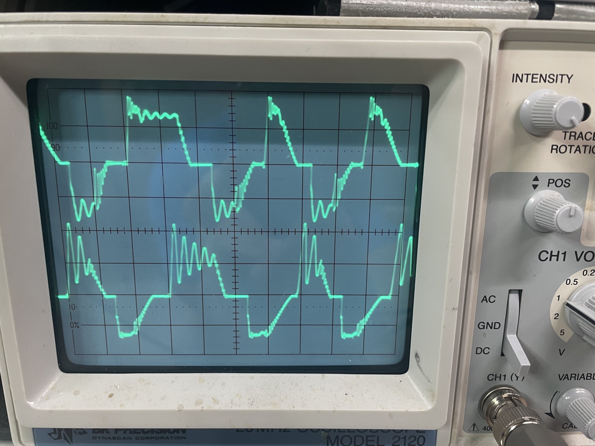

Looking back at the ps and pwm, it would appear that the pwm is lopsided so to speak. Like it’s driving slightly off kilter creating more positive rail voltage. The fets are not heating.
In an amp that has positive and negative rails, the positive and negative are produced by the same pulses, except in a few amps like the Alpine MRV-1507. Post a waveform of what you're seeing.
If you measure continuity from the input legs of one rectifier input to all of the other inputs, do you read 0 ohms?
All 5 rectifier input legs ready 0 ohms between each other.
Here is a photo with a probe on each fet center leg of the smaller PS connected to T900. 10vDiv moved both trace lines exactly +-20. Its actually very hard for my scope to lock on to this PSs' signal as its fluctuating quite a lot more than desired.
Why would one of T900's snubber resistors instantly go to 600F and smoke and also explode the cap connected in series? I have that one removed still.
Actually lowering the supply voltages causes the signal on the PS fets to become more dynamic and 'regulated' looking down to 10.2v where the amp then shuts down. Most amps lowering supply voltage will cause the PS to run full duty cycle. Not this amp. It gets harder to lock onto the drive signal just before shutdown.
