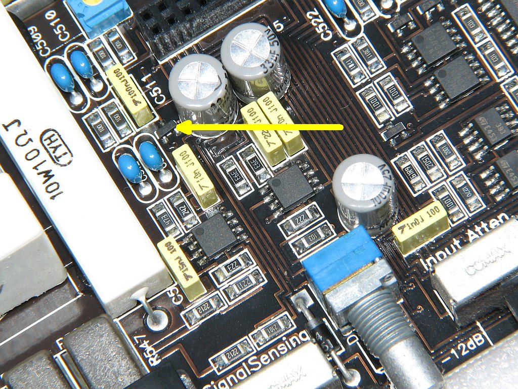

Powers on no problem with no thermal or low ohm lights. Sound stays constant with gains at full, but as stated, very low output. Every 2-3 min it puts a momentary burst of power out but its a split second so unsure if its just a surge or if it is actual sound going through to sub. Three out of four caps looked and felt raised so pulled the cap off one to see if it was leaking. I know the covers always look pushed out, but you can feel it. Pic doesn't do much justice for it.

Ok, got up early to take care of a few things including this. heres a pic of the board plus some extras encase you see something I don't.

Ok, sorry for the delay in replies. Navy has been running me raggid. Took the 2 legs off the board. Realized when I hooked up the power and ground that it arked like normal, but when I pull it out and put it in 2-3 secs later it arked again. I know all amps ark when the caps are charged, but they usually stay charged for a few min. Is this normal for this amp or for when you take those legs off the board?
With it wired up and powered on it plays like normal on low volume but once turned up it distorts and wont put any more power to the sub. A bit hard to explain but I can make a video if needed.
Let me know if you need me to explain further and what I need to try next. Also, should i resolder the transistor?
That transistor should have no effect on the draw from the power supply before remote voltage is applied. It's a muting transistor. What are you using for a power supply.

Tested it in my car, but for bench testing I have a dvp-2212 power supply with a mp3 player. It was distorting before when the gain was turned up to a certain point. DC voltage is 6.0-6.1 jumps back and forth.
The power supply doesn't appear to be working. Look at the 8 components at the back-right corner of the amp (behind the power terminals). There are 8 surface mount resistors (R600-R607). Do any look burned?
I will start this post by stating the obvious. YOU ARE THE MAN! Found the resistors and they are burned. Took the best pics I could.
