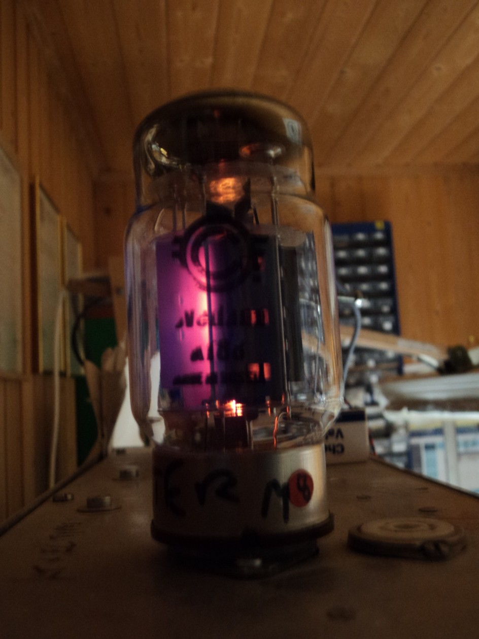

JJ KT88 tubes glowing bright yellow.

Tom, yes you have described exactly what I am seeing. The grey anode plates are not changing colour at all. It is the part in the top top of the tube that is in the middle of the mica. Do you have any light to throw on the tube values above?
I don't think you have issues then. Sit back and enjoy the music.
If you post a picture, it would probably eliminate some of the guesswork, though.
I'm not intimately familiar with the KT88, but one indirectly heated tube is not that different from another in terms of basic stuff like heaters, cathode sleeves, etc. Not on an intuitive level anyway. I have some Sovtek 5AR4 rectifier tubes where the heater pokes out and glows bright yellow/orange like you describe. A google image search for "KT88 glow" turns up this: tube glow 2 | Flickr - Photo Sharing!. Does that look like what you're seeing?

Yes the JJ's look like that, if anything not as red through the holes. I have spent about 1/2 an hour now trying to upload a couple of images by going advanced. No joy as yet but i will get there. The GL tubes I have glow less on the top than on the tubes in the link you have sent.

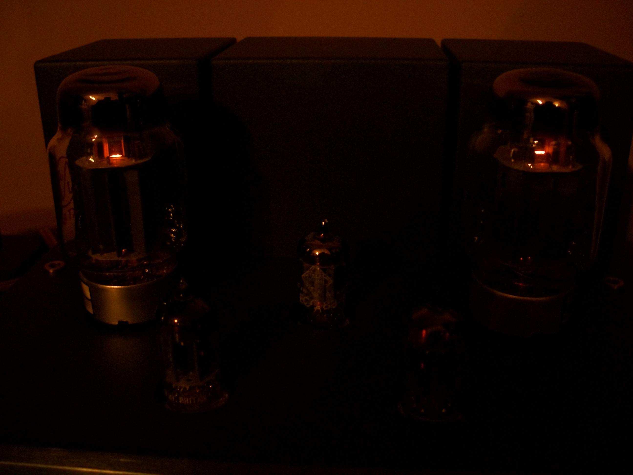

If youv'e got a tube behaving like in pic.....electron beam is concentrated on one side..it's a gonner. Came out of an inverted Fender amp and due to vibrations the cathode slipped in the mica causing misalignment. Manufacturer should have known better.
richy

Richy, none of my tubes look like than thank goodness. The one I had was a 12au7, the short caused the anode to start to glow very quickly. The glow and sudden buzz was not a good experience for my amp.

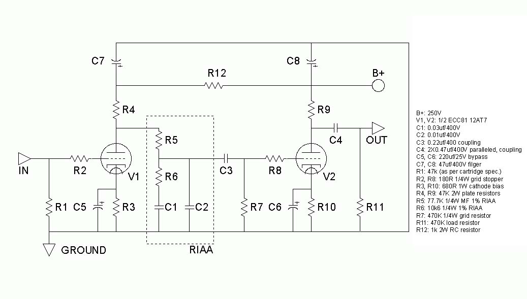

Seems to listening somewhat intensely. Must be enjoying the music! Just to say a big thank you to all who have helped with my amp problem and my questions. Greatly appreciated. A friend in the states is looking for a simple phono stage schematic that uses two 12ax7 tubes and P2P wiring throughout. He has got the tubes a transformer in great condition, a set of tube sockets and a chassis. Can anyone point me in the right direction? Anyone interested in a pair of 1978 GE Jan 6550a tubes that are not a matched pair, (matching numbers and correct boxes etc)?
Thank you I will email him this. I am sure it will go down well. It just shows you to keep as much stuff as you can as it might come in handy. I had a bunch of 12at7 tubes; some GE & Mullard as well that I eBayed a couple of months ago. Hows the dog?
I've busy all day with one thing and another. Not been a bad day. New Old LP? NOL instead of NOS. What spinner are you using? Wish I had my Father's dynatron still. I have had this confirmed but I am somewhat hesitant on this. MY amp is a single ended triode using one kt88 per outpur. self/auto biasing. Is it ok for me to use unmatched output tubes on this for sure?

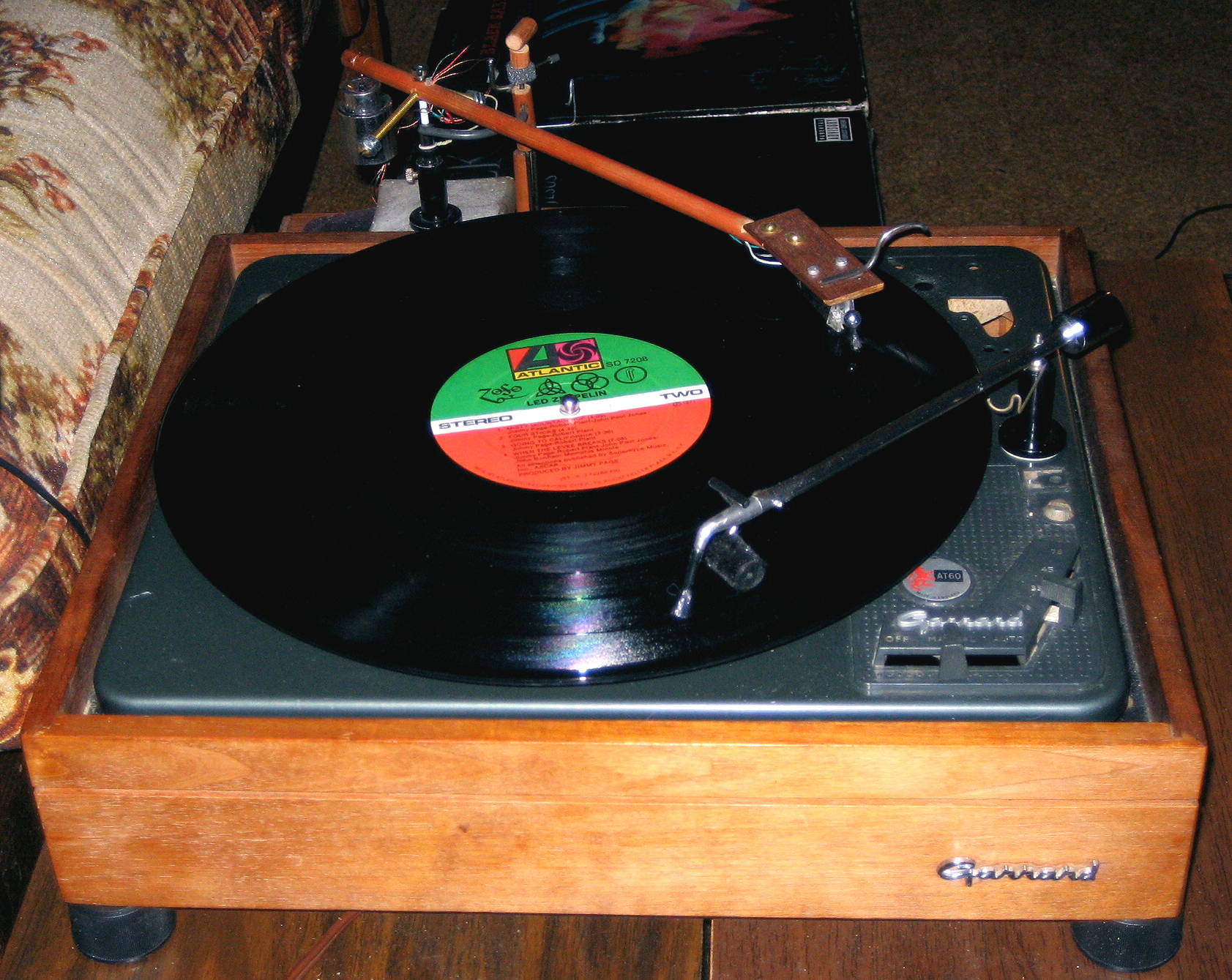

Finding a Sweet, Original LP that's 40 yrs. Old is always Fun...I spin them on a gutted Garrard A.T.60 with a DIY Arm...They're played through a 6DJ8 Phono Pre-Amp with the Circuit that I posted, and a Modified ST70...
