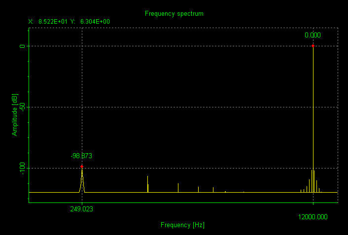

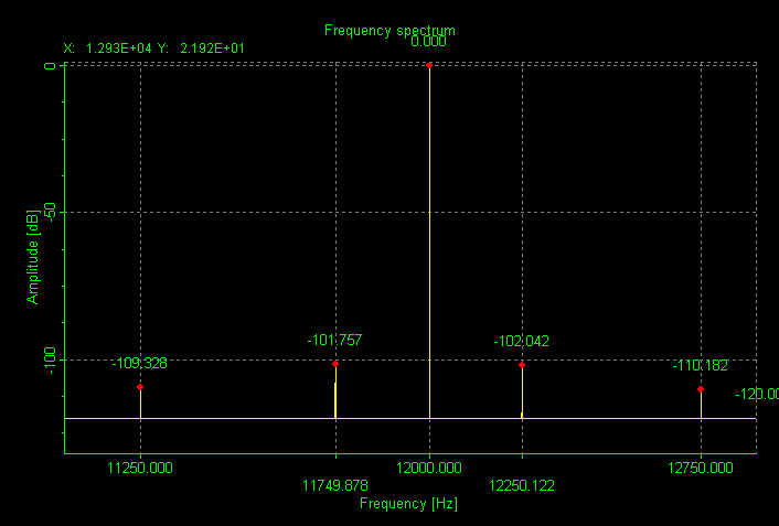

The added fake "jitter" was at the LSB in a 24 bit signal. I don't know how did you convert THAT to 16 bit...It seems to work. Here is an FFT. I had to convert it to 16 bits, but you get the idea.
And yet this way of working produces bit accurate results that comply with Dunn’s original paper. I’ve downloaded at least one version of the 16 bit test signal claimed to be the “one”. But closer inspection using a hex editor shows small imperfections. I for one hope that this method can be used to create a 16 bit version.
Merlijn
Merlijn
I don't think it can be done. The whole ideea is based on using a "smaller" 24bit step to simulate the jitter of the "bigger" 16bit signal. You need to feed that 24 bit as a 16 bit signal to the receiver to be perceived as jitter.
If you have the same 16 bit for both, you will end up with just regular signal, and that will NOT be seen as jitter by the receiver.
I had to convert to 16 bit to read it in my FFT sotware, as it did not like the 24 bit version. Does not mean you have to use it that way.

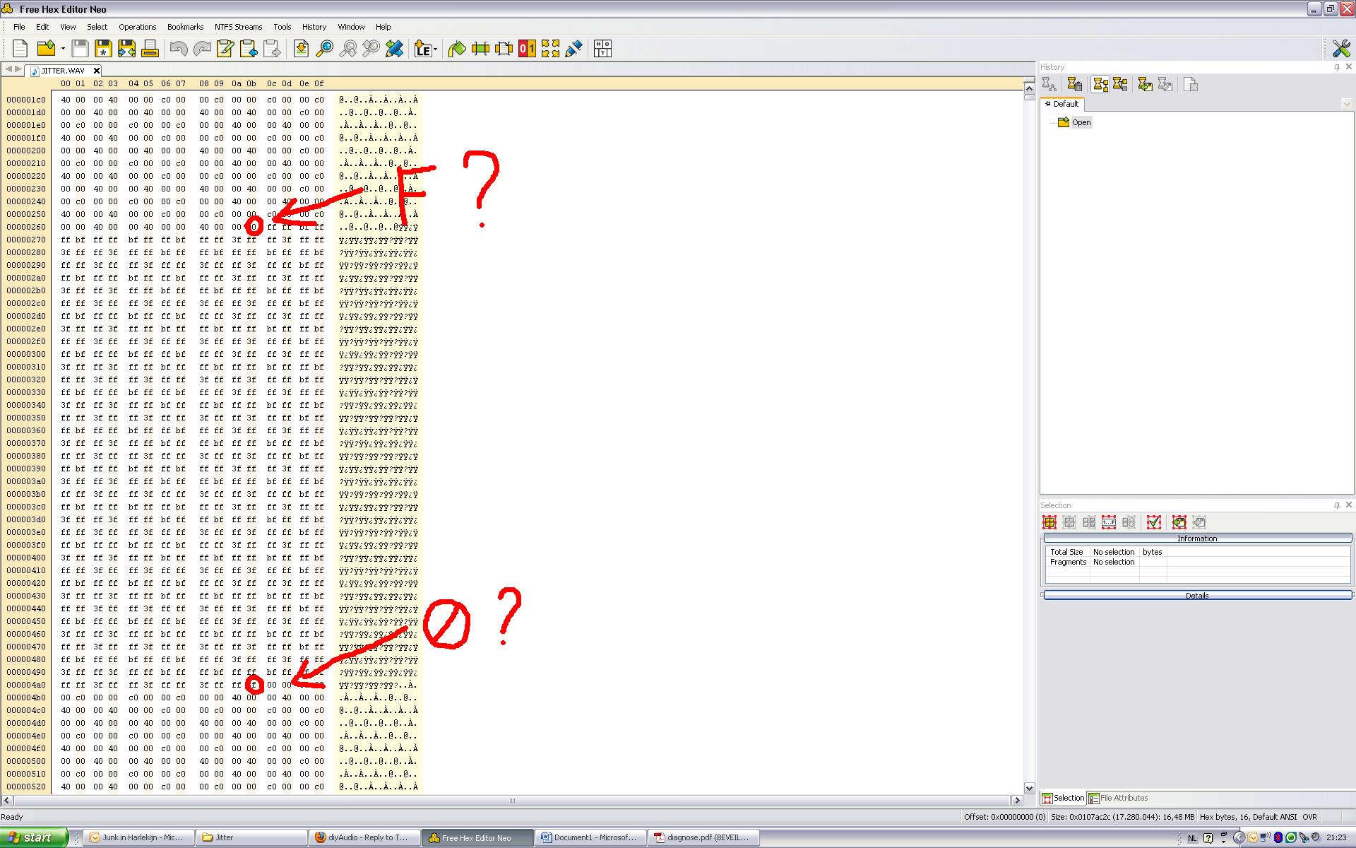

I took the liberty of looking at 24 bit wave file with a hexadecimal editor. The only thing I’ve noticed is that at the repetitive transitions from “C00000 C00000 400000 400000” to “BFFFFF BFFFFF 3FFFFF 3FFFFF” and vice versa, shouldn’t the last hexadecimal be respectively F instead of 0 and F instead of 0? I’ve attached a screen dump to illustrate what I mean. Correct me if I’m wrong.
Merlijn
Merlijn
Well, that's not what it says in your quote:
I can modify it to correspond with what you suggest, but that's not how I read it, and it's not how I understand it from the foregoing description:-
The first is an un-dithered square wave with a period of 4 samples. A cycle of this is shown here in hexadecimal notation (hex):

...Yes, Pano, a combination of having a number of similar files and some Valentine's Day distractions. Somehow I managed to overwrite the new with the original. Hopefully this one is correct. This one is 48ksamples which preserves the original frequencies of 12kHz and 250Hz. Altering the sample rate to 44k1 changes the frequencies to 11,025Hz and 229.6875Hz, which are integer fractions of 44k1. Trying to keep the frequencies unchanged results in considerable complication and will anyway produce a result quite far removed from the original intent. A 44k1 file using the frequencies 11,025Hz and 229.6875Hz follows...
w
I can generate the files with the swapped F's and 0's without too much extra effort, so I'll do it and you can mess around with them.
The combination of these signals results in the following 192 sample cycle of 24-bit data values:
C00000 C00000 400000 400000 (x 24) BFFFFF BFFFFF 3FFFFF 3FFFFF (x 24)
w
Oddly, I don't see jitter added, just the 229.x Hz square wave. No sidebands on the fundamental. Is that to be expected?
Sorry, I can't comment on that, I'll read the article, I haven't done that yet.
It's a bit of an odd thing to do, put a square wave into a DAC, particularly at half the Nyquist frequency, there are obviously loads of harmonics there which you would expect to alias down into the passband. Normally any signal would be low-pass filtered to exclude any components above 22.5kHz.
Anyway I didn't pay any attention to that, I just set out to create the file according to the specification as I read it.
