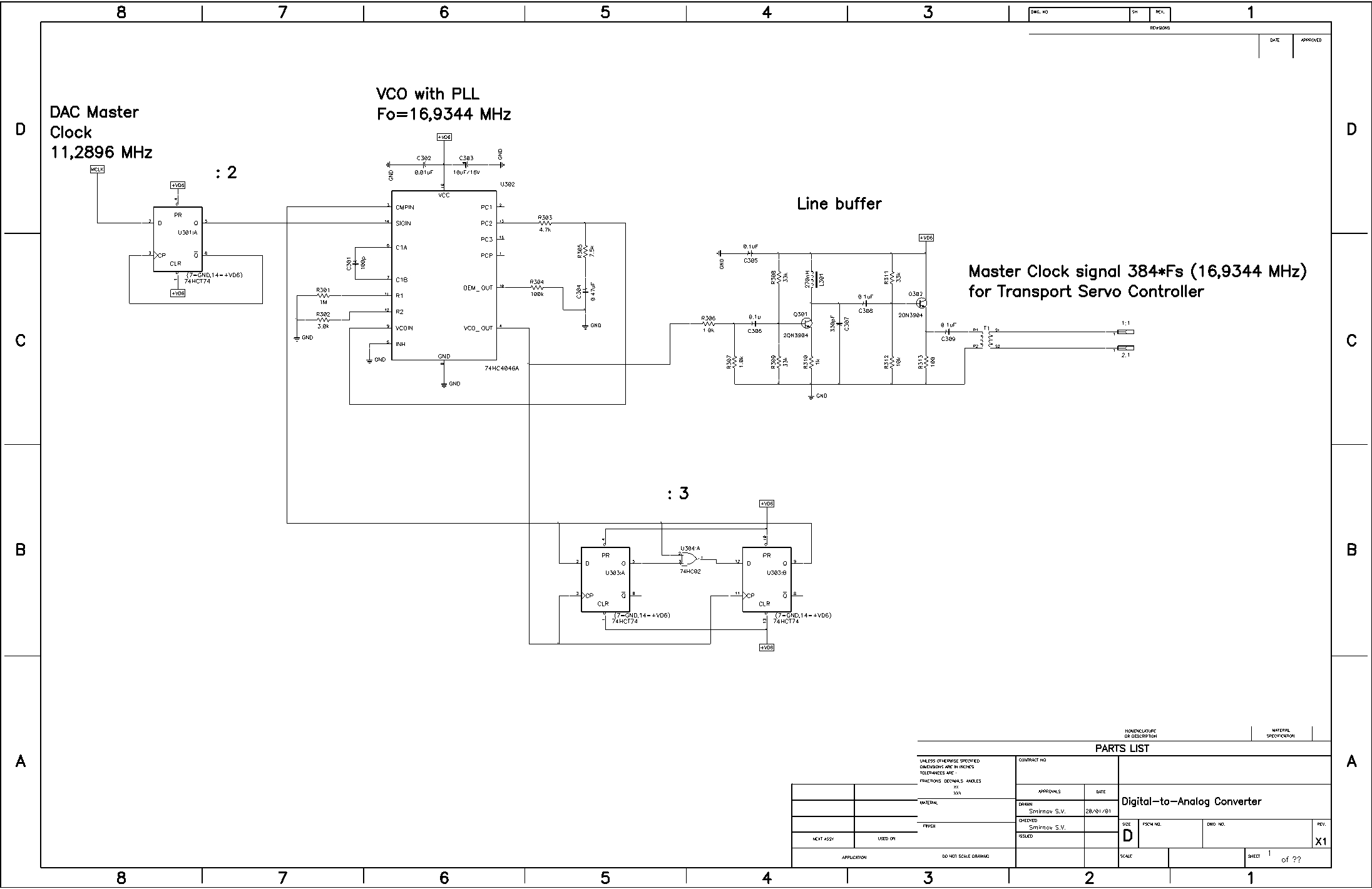

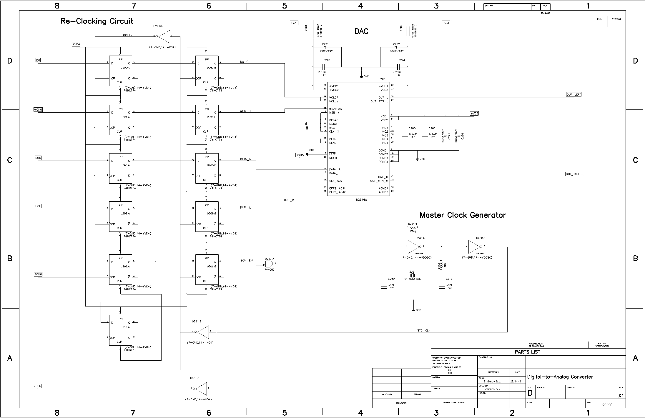

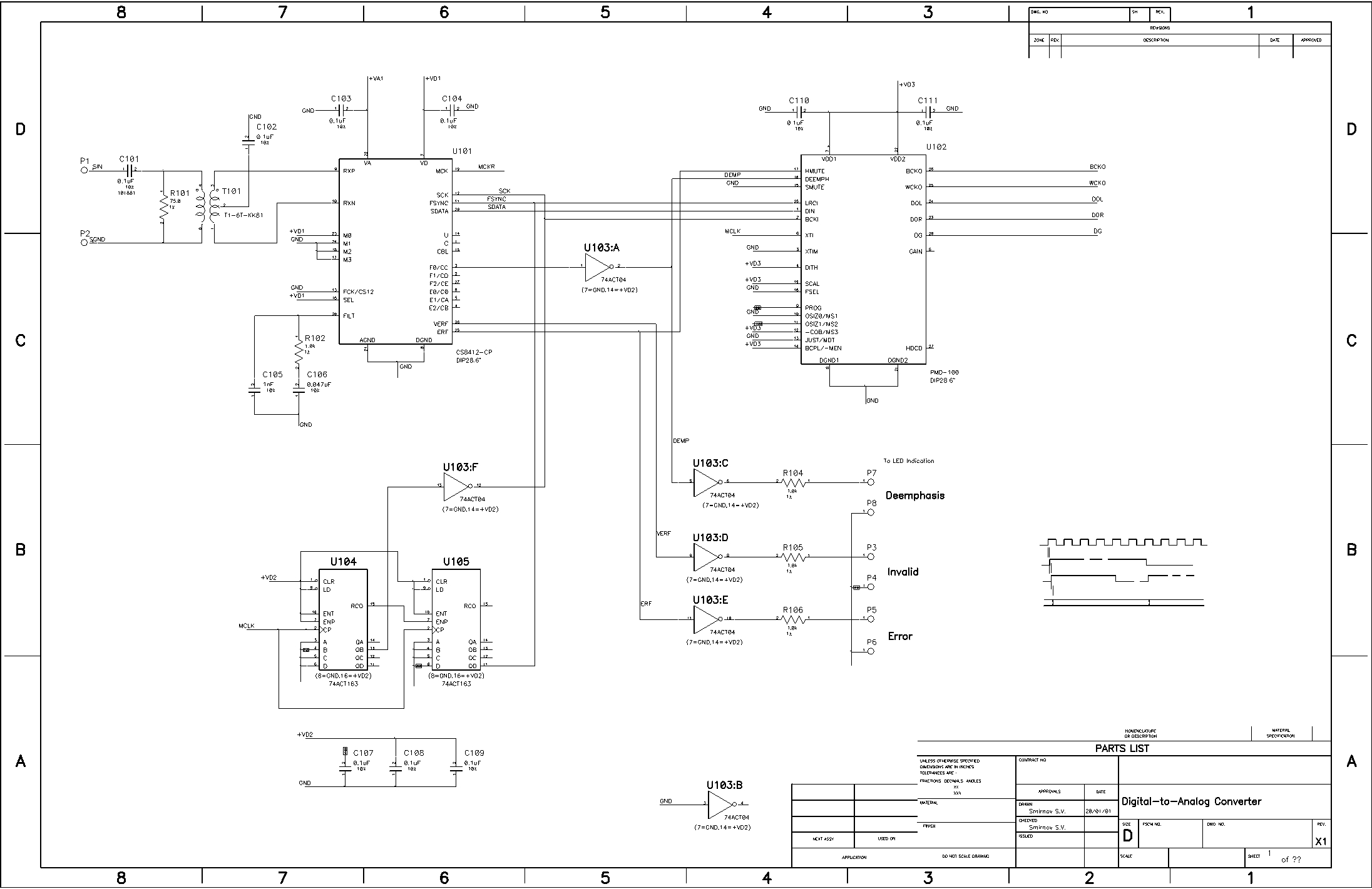

By follow URLs and in the attached files you will find various schematic of reclocking units in front of the DAC IC.
I don't understand the individual pros and cons.
At first look the russian approach seems to be the best solution.
But I am not really sure.
Which of this examples is to prefer?

I am still looking for those reclock variation with best sonic quality - follow I know:
http://sergeysvs.narod.ru/projects/Clocking/clocking2.html
http://www.hagtech.com/pdf/hagdac.pdf

which I should prefer ?
It does not need to be overcomplicated. You don't need to reclock all signal lines, only the single one that controls the conversion (usually WS of the I2S lines). I use an SN74S74N for reclocking. This IC is not available any longer, you can find it in very old digital boards. But the master clock should be perfect, otherwise it does not make any improvement.
...or BCK, depending on the DAC chip mode of operation, like TDA1541A in time multiplexed mode.... You don't need to reclock all signal lines, only the single one that controls the conversion (usually WS of the I2S lines)...
