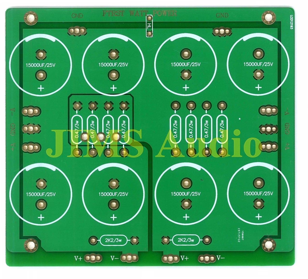

Well, the diyaudio store is out of power supply boards for my F5 build. An ebay search led me to this...Jim's audio power supply board.
Seems like it's good quality...but I don't see any snubber capacitors? Big deal, yes or no? Also, the pads marked "HL"? Thermistor? lastly, the 2k2 resistors...I assume those are bleeders?
Man, all I need is a case (out of stock) and a PS board (out of stock) from the diyudio store and I could finish up my F5. Should I wait or should I risk using this PS PCB?

I was in your situation and used this board for my F5. No probs. Nice quality board. Some have had issues with the star grounding scheme, but IIRC, it was just a simple matter of connecting some of the ground pads together. I didn't have real issues myself but connected those point anyway.

Better to be patient and support the good guys.

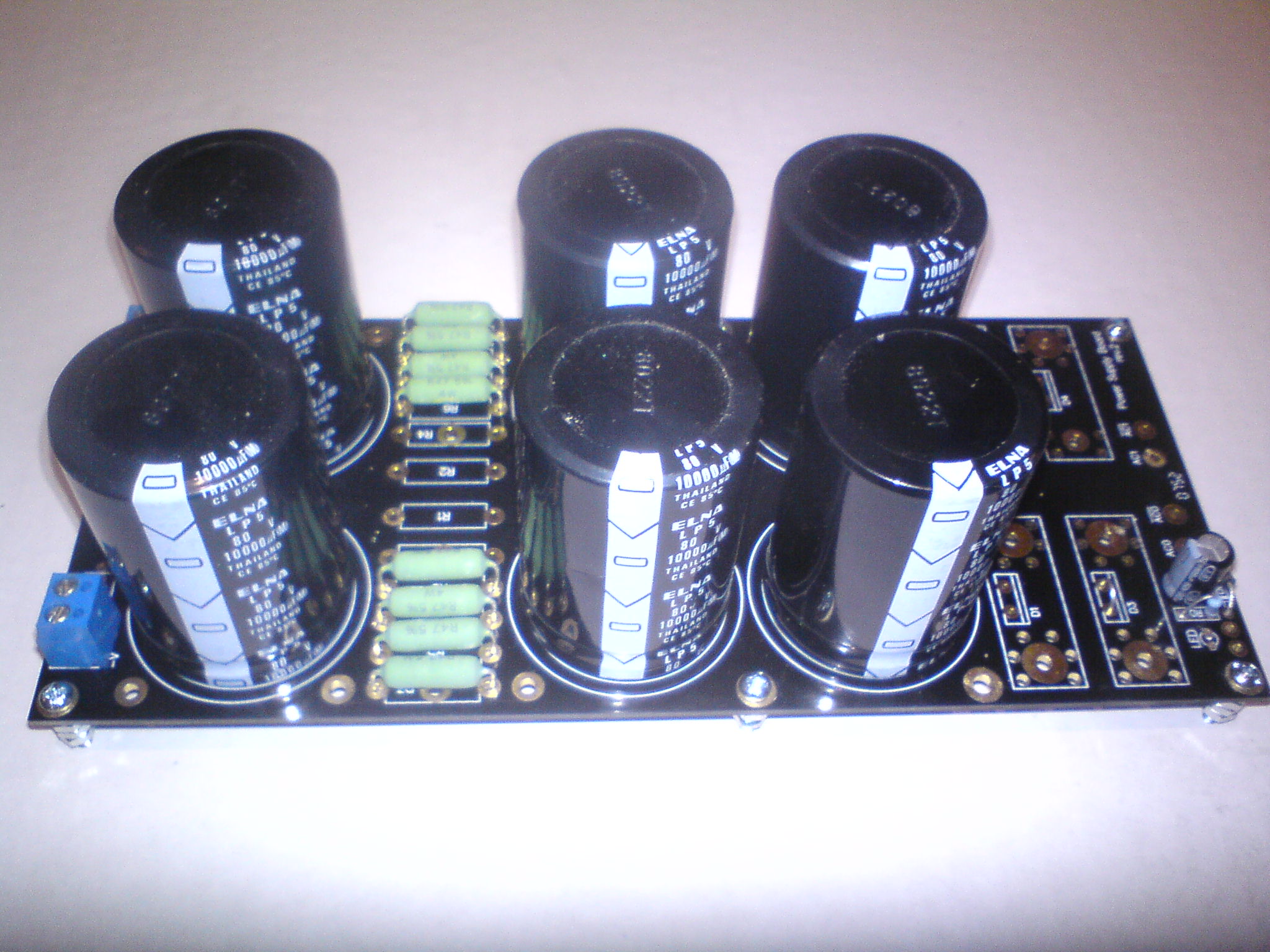

Onboard rectifiers. I am not really an expert on rectifiers...are these worse than the block type rectifiers? I would replace the resistors. Also, would a f5 build require two of these boards? I only see one set of secondary in/out.

go to the ORDERS page and scroll to the bottom listing, you will find the aleph power supply which will work for your F5 also.
I don't know your purpose. But I built descrete rectifier board and each of the dual diode gets fairly warmer with small heatsink. Now I feel diode block without heatsink will get hotter.Jim's audio also has this board. Anyone care to comment?

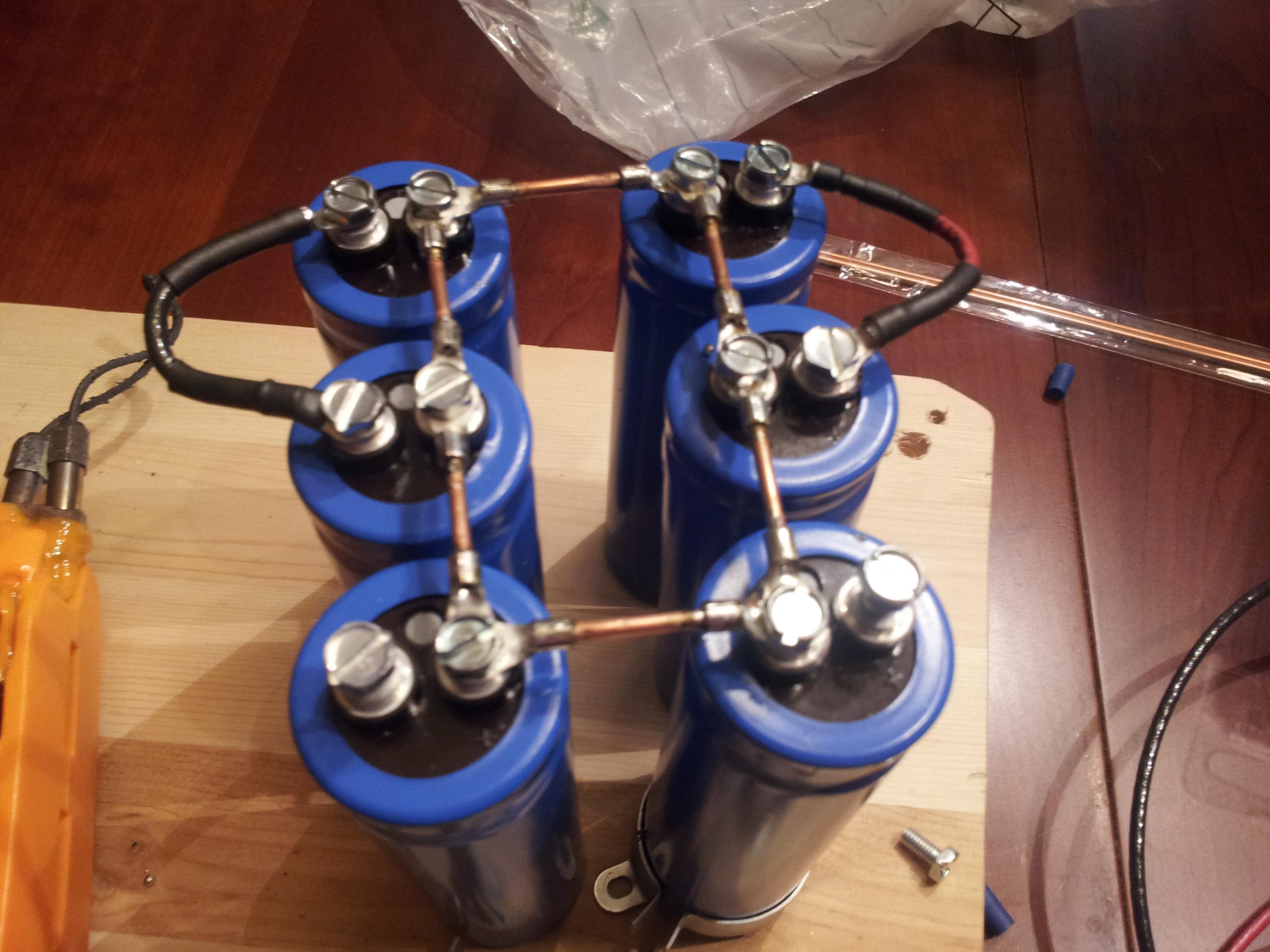

Yes, 6x33000uf from Apex jr.

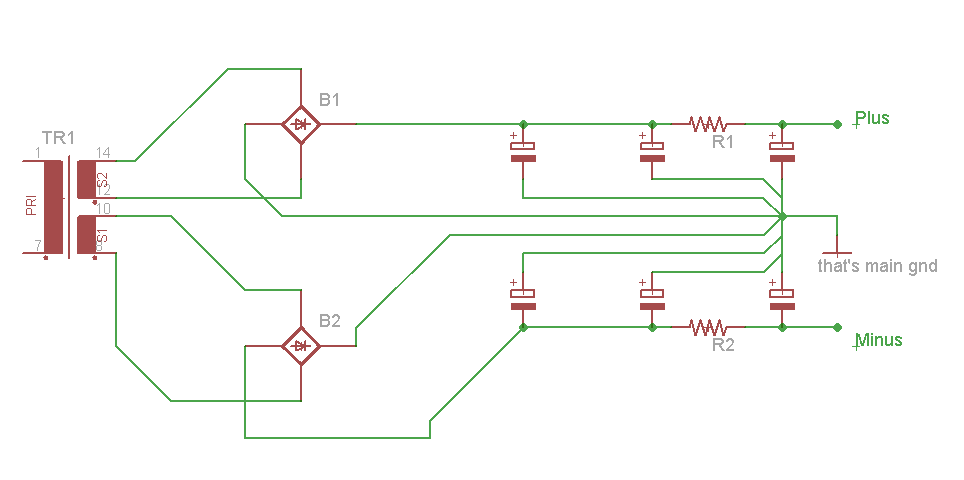

So, what is the best place for the resistors/bypass caps? After the first set of caps or after the 2nd?
Zen, your proposing a single ground location instead of my ground 'bus'. Actually I wanted to use a copper plate but couldn't find a suitable plate. Do you think the grounding design I am using will be a problem?
