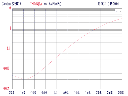

If the moderators don't rap my knuckles for transplanting my comments from the thread, "R2R Attenuator for Volume Control without Transition Contacts in the Signal Path":
The atch image is Fig 7 (THD+Noise vs. signal level for a NSL-32SR2 configured as a 3 db shunt attenuator with a 2 KOhm source resistance) from the Silonex page at < Silonex Inc.: Products: Audiohm Optocouplers: Audio Characteristics >.
From the description on the Silonex web site, it sounds like the 32SR2's photocell was connected as the shunt element in a simple voltage divider (L-pad) with a 2 kilohm series element. Then the LED current was adjusted until the voltage divider produced a 3-dB loss. (I think this means the photocell resistance was around 4.8 kilohms.)
Quickly grabbing two data points, I see 0.010% (-80 dB) THD with -6 dBu input level; and 0.10% (-60 dB) THD with +4.5 dBu input. That's a 20 dB increase in THD for a 10.5 dB increase in input level. Thinking makes my brain hurt, so I will approximate it as a 2:1 ratio. If I recall correctly, that points to a predominantly cubic (third-order) nonlinearity in the photoresistor's V-I curve at this particular illumination level.
If I re-learned MATLAB I could probably determine the coefficients for a polynomial V-I curve, but maybe somebody who already knows MATLAB will do it.
There is more information about using the Silonex optocouplers as audio attenuators on the Silonex page called "Audio level control with resistive optocouplers". Scroll down to the discussion on the "Shunt Attenuator".
They say that a 3-dB shunt attenuator is a worst-case situation, distortion-wise. I don't know if they REALLY mean "a 3-dB attenuator will give the worst THD, regardless of the series resistance in the attenuator"; or if they mean "the optocoupler has its worst distortion when when the photocell is near the upper end of its usable resistance range - which is where it's operated in this example of a 3-dB attenuator". I'd like to see curves for THD versus attenuation for various values of series resistance - e.g., 2K ohms, 600 ohms, 200 ohms, etc.
Dale

Thanks for the photocell distortion data. It looks like that part can do -130db distortion.
