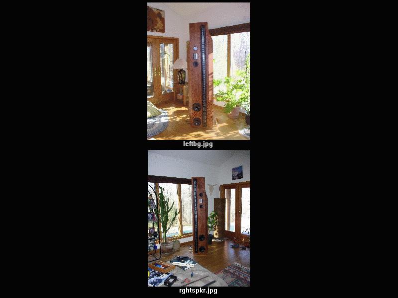

More pics.. BG Dipoles
More pics of BG Dipoles per request... note subwoofer in corner in this pic

BG dipole construction
Some final pics of construction...
http://i3.photobucket.com/albums/y62/auplater/TEST1.jpg
http://i3.photobucket.com/albums/y62/auplater/TEST2.jpg
note: subwoofer in background from ~80 hz on down to ~16 Hz
http://i3.photobucket.com/albums/y62/auplater/WOOF1.jpg
http://i3.photobucket.com/albums/y62/auplater/WOO.jpg
http://i3.photobucket.com/albums/y62/auplater/BAFFLE1.jpg
http://i3.photobucket.com/albums/y62/auplater/WINGCL1.jpg
BG RD-75 planar midrange
The woofer cab is tuned to ~48 hz with 2 x 6.5" peerless HDS wpeakers...
main wing baffle is solid 1" cherry
2 peerless dome tweeters (one now faces rearward out of phase with front..
and panasonic EAS-10TH400A supertweeter from ~7Khz on up to ultrasonics
auplater
