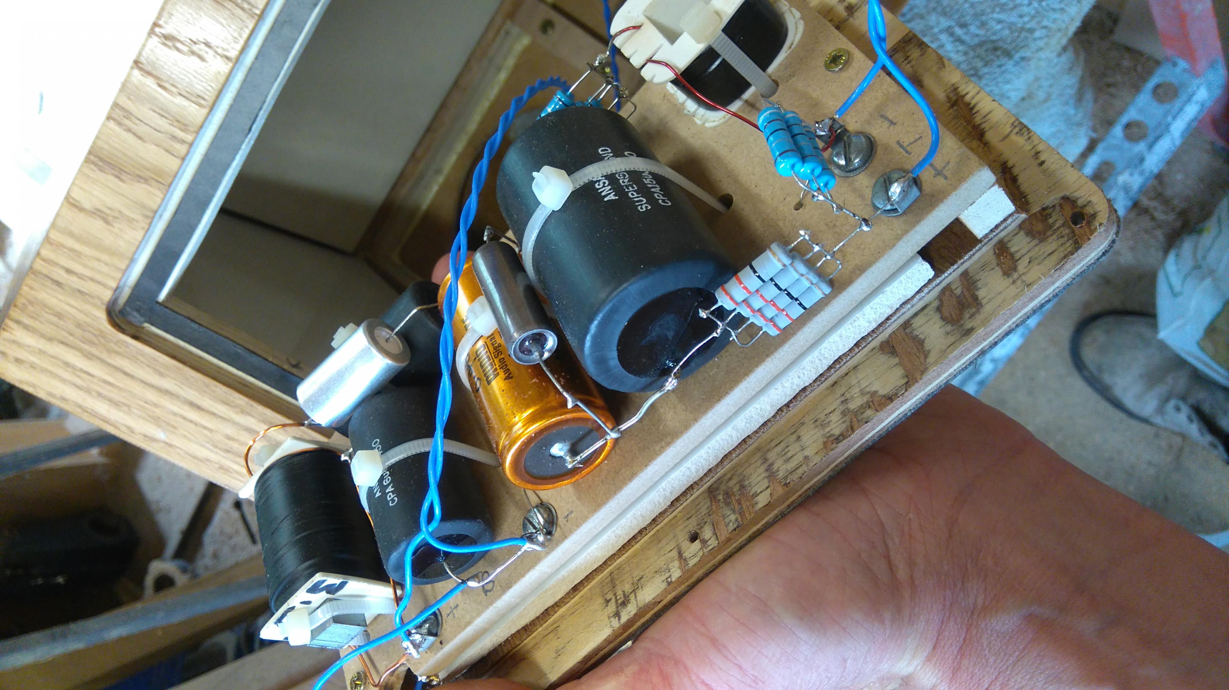

The Jantzen Superior Z caps were installed yesterday. Interestingly they sound more detailed in the lower treble than my previous Ansar / Audio Note / FT2 mix, so far so good, however the upper treble sounds dark. I have added small FT2 bypass caps which have opened things up a little, but not enough. I still miss the extended harmonics from the Ansars. It may be that an Ansar /Jantzen mix proves optimum ( will probably try that tomorrow) but in all honesty the Jantzens make these ribbons sound rather dull...at least so far.
Hmmm
Perhaps they would improve a little but I'm not convinced it would be enough. I've reinstated the Ansars with their bypassing caps and the comparison is stark. The Jantzens seem more detailed in the lower treble but more shut in further up. Relatively speaking the Ansar mix is substantially more lush, smooth, extended and airy, at least in this set-up. Nothing is forced.

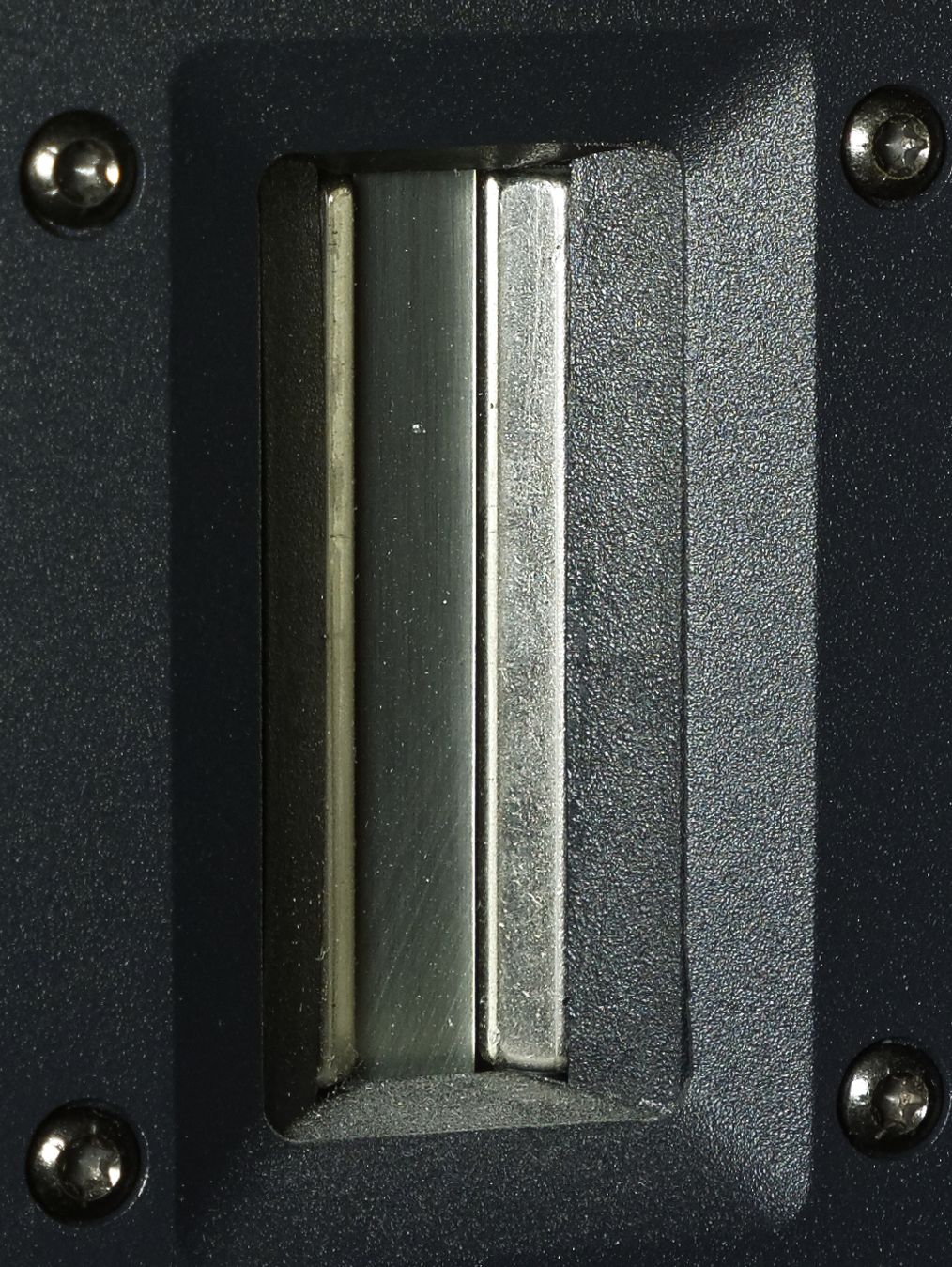

Perhaps this may have turned out differently with the Ribbon faceplate modified as you have done Mike, so that may be a project for another day...in any case I'd be very interested to see a picture of what you have done.

Sorry you didn't like the caps. I do not think that removing the grill will impact the tonal quality - rather I have found, both with Founteks & Aurum Cantus that the sound becomes clearer & cleaner with the grill removed.
I have attached a pic of my ribbons. I just removed the faceplate, took out the grill and put them back together again - I seem to recall that there may have been some adhesive but I did this mod about 8 years ago so cannot recall all the details.
CAUTION - removing the grill leave the ribbon exposed & vulnerable. Be particularly careful with any magnetic metals - they can be strongly pulled towards the ribbon & damage it. That said, I did damage one of mine ( a few years after the mod ) and it still sounds much better than with the grill on, so for me this mod is a no brainer.
However, based on my last piece of advise, I felt it necessary to give the full disclosure - If you try this mod, I hope you like it as much as I did.
mike
G2SI faceplate modification complete - the metal grills have been removed. Very straightforward as they were held in place under the edge of some self adhesive foam gasket which can be lifting up to free the grill, then stuck back down again.
The improvement is not subtle!
Thanks again for the Suggestion Mike
Tim
