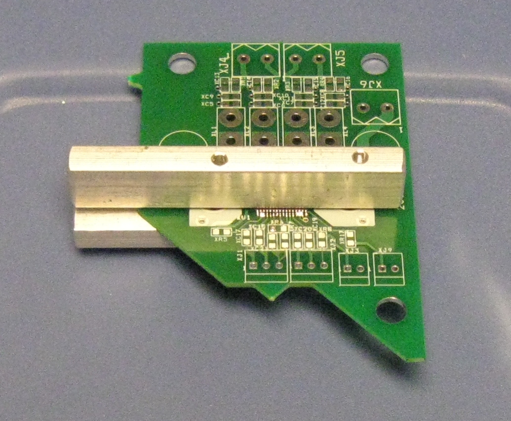

I was searching for a jig that helped me soldering SMD components to the board but unsuccessfully was unable to find one. Specially when your are an older person with checking hands like me. So I decided if you do not find it built it. Checking my junk box and found some parts that allowed me to came out with this SMD holding down jig. It worked so good for me that I decided to share it with the diyAudio members.
To fabricate it I used a 1 x 8 inches aluminum strip and bent it like a square with one leg side cut out. Drilled a hole at the end of one of the leg and installed a 2 inches screw thru the hole and used one spring and holding it with a nut to applied pressure from the tip of the screw to the other side leg of the square. I think that a picture it is better than words specially when you are not a technical writer like me.
Attached are some pictures showing the final SMD soldering holding jig.

Thank you Dug. I was thinking that I was the only one with the problem but I see other members were looking for the best way to hold the SMD to the board. Also it is easy to align the pins with the solder area.
You should posted it more sooner or I missed your post. I google for few days looking for a solution but it didn't showed that one or any that I can use. Any way it is look the same as my but in a laaaarge scale.
Why are you not just gluing it? It's a common practice even on massive assembly lines. They even make glue specifically for holding down IC's, commonly called SMD glue. For some reason, it's often (but not always) red in color. Usually, the glue is heat resistant, doesn't eat the board, doesn't off gas and isn't conductive. Frankly, I think you can get by with a tiny dab of super glue just fine.
I used glue but I didn't like it. With this just take few seconds to get it ready for solder. Just lay down the board with the SMD in placed and let the spring do the job. Simple and fast.

To each his/her own. There is no one way that is right or wrong. I was just posting an alternative.
