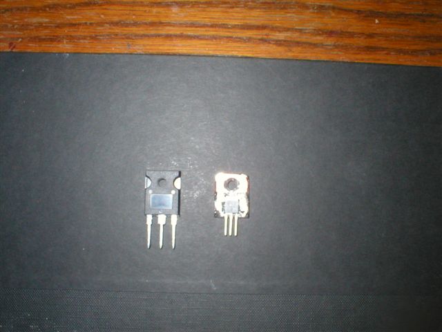

Magura, those sure are nice. I however l don't intend to
push mine hard only ~8 or 9 w or so. So I decided to salvage a couple of blown itfp240 mosfets and remove almost all the plastic.
Then sand the dead active device off exposing the copper base
and solder the jfet there. I hope the indium solder that melts
at ~97 c doesn't melt when I use the devices! I put a healthy
Irf260p in the picture besides my soldered Jfet.

97C may be a little on the low side, but time will tell.
I decided against low temp solder, in order to be able to abuse them 😀

I can't remember how thick the Kapton film I have is, I bought it long ago.
Yeah, I see you get the picture of where I'm heading 😉
Kapton will though not be an option, as the thermal cycling will be a deal breaker.
Magura 🙂

Plain steel bolts. Isolation is sorted out by a shoulder washer.
