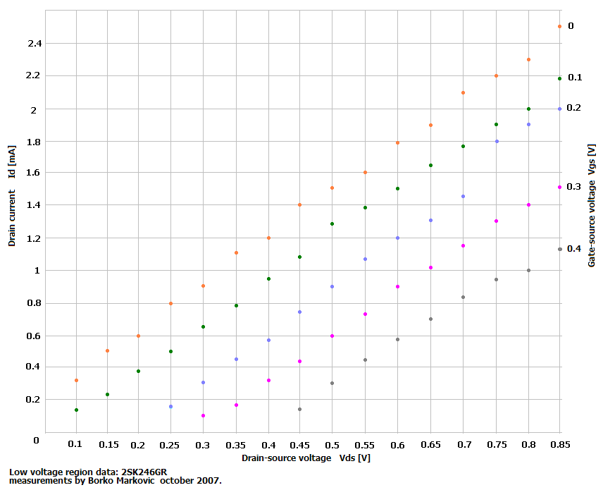

In the attached image you can see the data I measured for a 2SK246GR in the low-Vds region.
Soon when I find the time I`ll measure 2SK170V and send the data.
Cheers!
Cheers!
Hi Bogdan,
Thanks for sharing your findings. If you get the chance could you also test and post your findings on 2SJ74BL specifically at Vds=10V, Ids=10 to 15mA and Vgs=1V and the region just above/below it. I'll be looking out for your 2SK170 as well.
