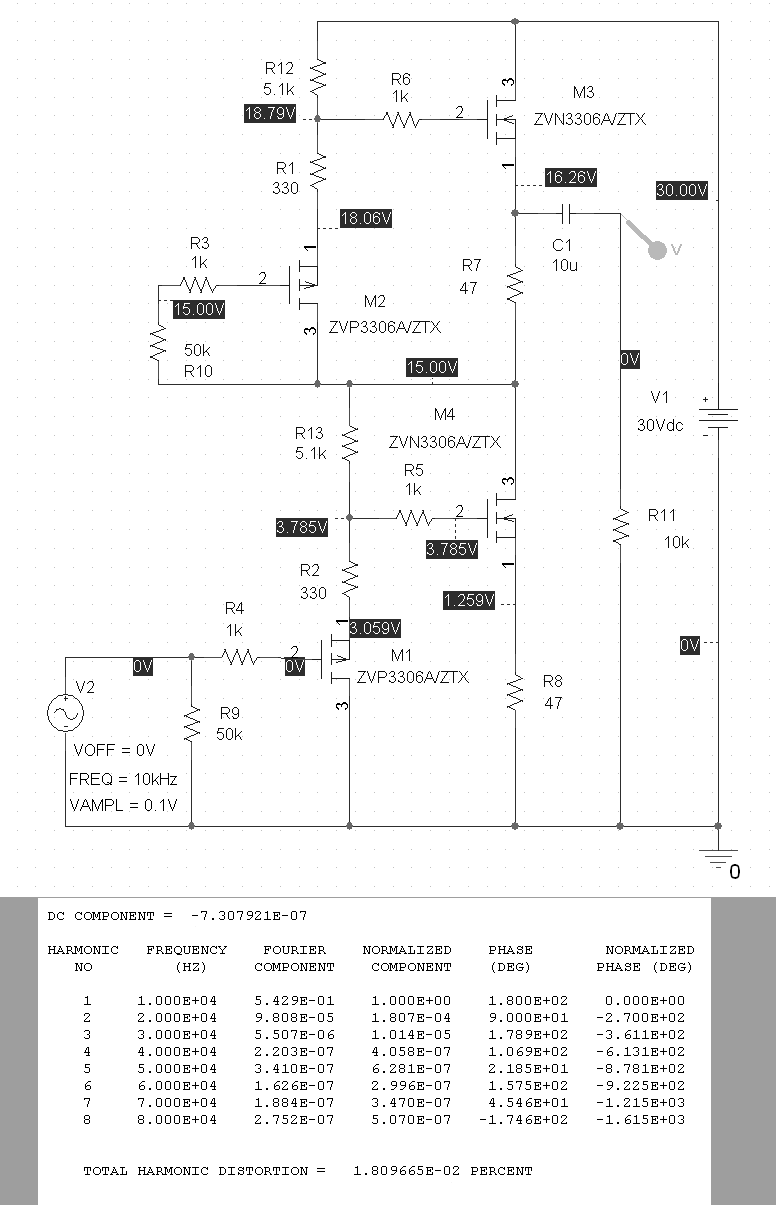

Then it's not an SRPP. I will continue with this project as an an SRPP so that I can suss out the implications. Juma has already done the gyrator thing and tacked it on to another one of my threads. We'll see about output impedance when I measure it.
Suit yourself. I wasn't attempting to hijack your thread, only to a suggest a solution to the problem of metastable quiescent drain voltage that you had raised.

Perhaps, the most reliable means to address this problem is to apply fixed-biasing to the upper JFET, turning it in to a gyrator. You could create a bias reference voltage by dividing the supply in half with a string of two very high value resistors. Tap the midpoint of this string for biasing the upper JFET's gate. Then, A.C. couple the upper JFET gate to the bottom of it's source resistor, at the lower JFET's drain). You can use a small value capacitor because of the high impedance terms involved.

Since you ask (no hijacking is intended, Wrenchone 😀), yes, the front half of that Hafler circuit is it. A fixed bias gyrator allows us to have our cake and eat it too. We obtain both a high A.C. impedance - giving us maximum gain, and a low D.C. impedance - giving us a stable and predictable D.C. bias voltage across the FETs. I know an good idea worth adopting when I see one. 😉
I would not worry too much about having complementary symmetry, along with sourcing the scarce P-channel JFETs that would require. I would build this circuit single ended utilizing only N-channel parts. I would cascode those FETs, and also implement the indirect feedback technique on the upper FET, per the below linked paper from A.N.T. Audio. My best sim of just such a circuit predicts a gain of around 46dB. It will produce a 1kHz 2VRMS output signal with a sim'd 2H at around -75 to -80dB, and 3H at nearly -120dB. All higher harmonic are beneath -140dB. All without resort to loop feedback, only low value (10 ohm) source degeneration resistors and the indirect feedback technique cited above. Okay, unplanned hijacking over. 🙄

To put it bluntly, I'm not in love with gyrators butting up against triode equivalents. A current source works better against a "triode equivalent" than a voltage source (at least in my book). Anyway, I want to investigate what can be derived from a simple SRPP before I make a leap (if I ever do) to some other alternative. It's my time (I don't have a lot of it, for various reasons, none of which I have to justify to anyone here), my resources (ditto).
At any rate, I've already figured out how to compensate an SRPP (the position for the capacitor was not where I initially thought it would be, and I got a nice, overdamped response with 15 pF of compensation)). I suspect quite strongly that most hot-doggers here have let fly with SRPP designs here, SRPP there, without any sort of time domain/frequency domain investigation of stability. To be brutally honest, I never did a time domain test of a simple SRPP stage until the results I've posted here. Others might benefit from such a simple investigation...

I've sort of fallen out of love with the concept of jfets used in an SRPP context, even though I could sort of force it to work.
As an analogy, it's like trying to make a pair of pentodes work as an SRPP, whereas all the SRPPs you see around are implemented with triodes. Think of dueling current sources..This explains why anything that made the jfet characteristic even more like a pentode (such as cascoding) made the SRPP hard to balance in practice, though it would look peachy in simulation, where the bits are all exactly alike.
At any rate, here's an SRPP design using a mosfet with feedback to emulate triode characteristics . The actual gain cell uses a P/N channel pair, so that I can get a high impedance input that will be far less sensitive to the characteristics of the driving source. This thing might be useful as a line amp with gain, especially if a follower is used at the output. As shown, the gain is ~5X. Distortion scales fairly linearly with input amplitude, and is overwhelmingly 2nd and 3rd order.
One thing I plan to do (though it'd not a really urgent priority) is to run a series of plots to determine the sweet spot for distortion vs. output load. I suspect that the 10k load I used is not optimum, and SRPPs are touchy about the output load. Ahem, another less endearing aspect of SRPPs.
