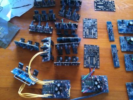

i have some populated civiller f4 boards that just need the output devices to be complete
reading about the fw j2 and f2j has got me interested in this type of output for my f4, i think i can get the semisouth devices from this forum
my questions are
1, what type ,semisouth ?
2, can i use 1 pair per channel like the j2 instead of the f4,s 3 pair
3, any other mods ,resistor changes?
4, is it worth doing
they are to power veravox 7x @93db so i only need 10w or so
cheers

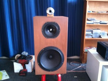

heres a few parts from my diy box😀
i have heaps more proberbly double this
i also have my aleph 2 monoblocks that i love and have been using for 3 years or so
the speakers are diy also
i cant help myself!!

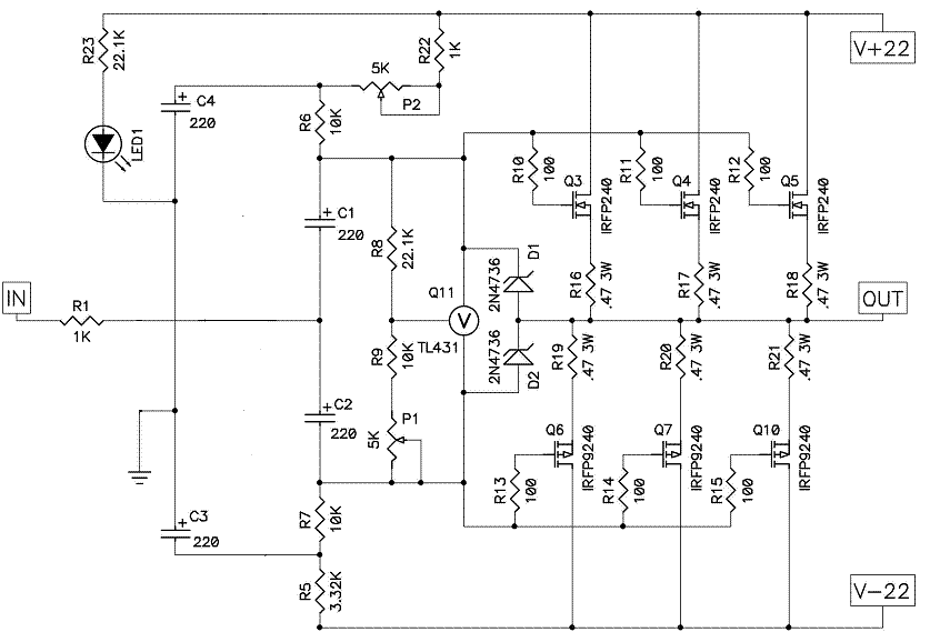

crippled, liberated, short... lots of names for this F4, but at which point is it snipped? Is it just the jfet input that's discarded, with the input coming in at the intersection of R8/R9 and Q11 (the TL431)? I'm assuming the two 220uF capacitors (C1 and C2) are no longer needed either.
If I'm not mistaken the TL431 is acting as a phase splitter, but a center tapped transformer could just as easily act as such. Unfortunately, my transformers don't have a center tap.
A liberated schematic would be golden here.

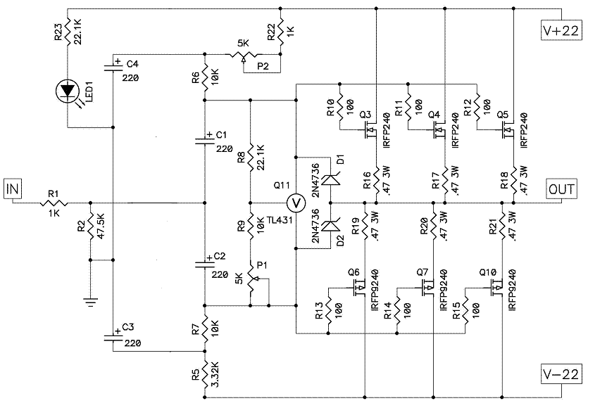

I just found two schms in my pc
you can use whatever suits you (needing input shunting resistor or not)
those two caps are needed , as they're for \DC decoupling
TL431 is bias gene , so no phase splitting role here
"short" F4 means somewhat as F4 with just one output pair
term based on Papa's words , "output 3 , 4 , 6 deep" , meaning output with 3 , 4 , 6 mosfet pairs

Thans zm for the schema. I'll be wiring up in a few minutes.

First one includes drain resistor(47K) on FE, important if hooking up to pre with no cap. Fried a DAC not having this one. Just thought i would point that out. What is the official name of that resistor, ZM? Tired of being ignorant of terminology.
you can call it Giorgio
or input resistor
or whatever ...... maybe input shunting resistor is best name
or ...... $*it happening Preventer
